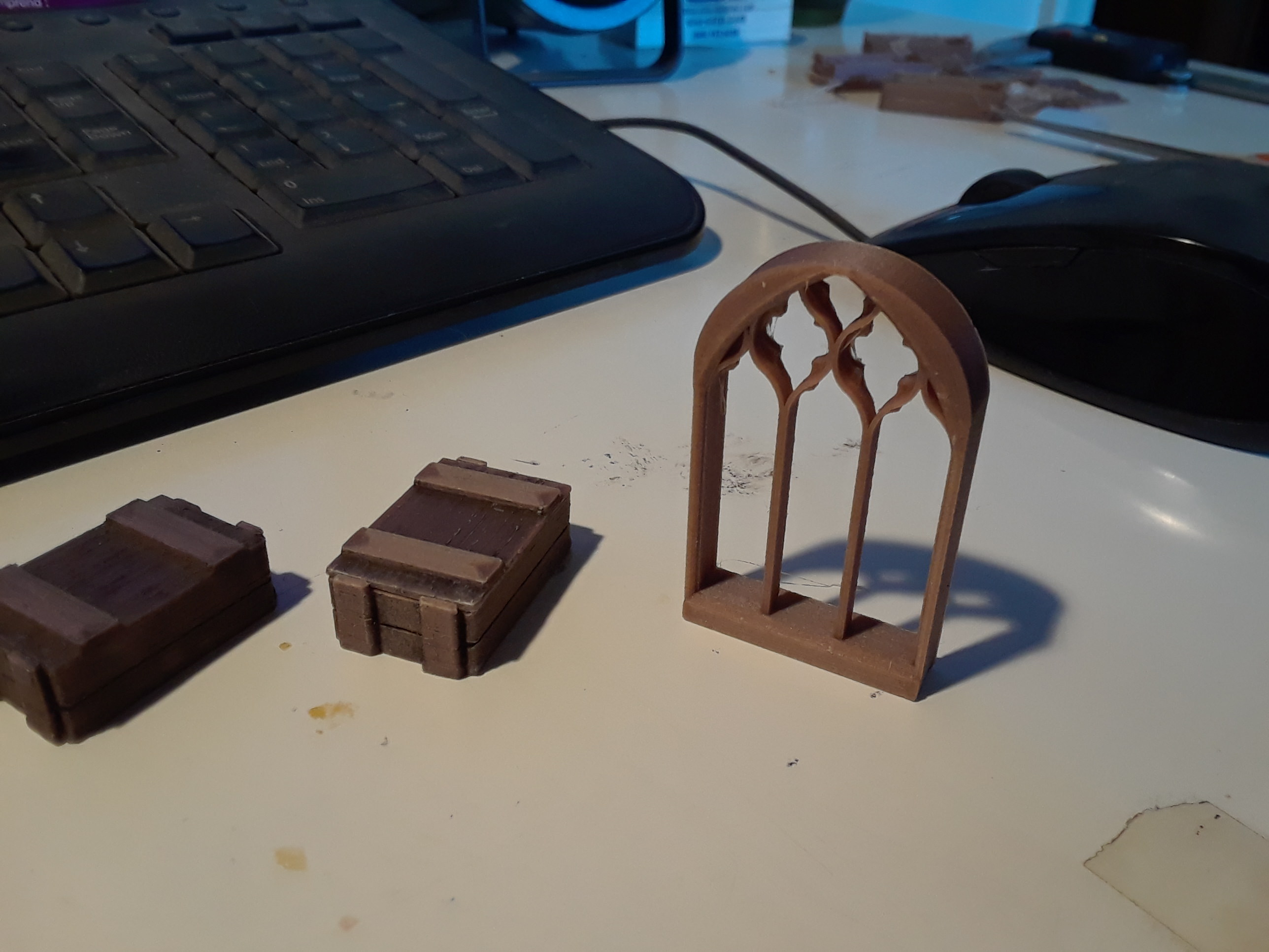

1 Attachment(s)
That's a great idea for the top of the crate, Greg, I'm looking into that.
Here's a shot of a window frame. One of the cool things about Cura is that I can scale these things to any size I want. The crates in the photo are 30x20x10 mm but I can make them whatever height, length and width needed. I think one of the crates to hold electronics ended up at 150x55x25. Same with windows, i can make whatever size i need and i think they'll be great for battlefield buildings. I've got doors, too, some even have knobs. WooHoo. ;)
Attachment 2262404
I think EVERYONE needs a 3D printer!! :)

That is FFM printing, not SLA printing. SLA uses light (laser or LCD type of thing) to cure the resin. FFM is cheaper and the most commonly used atm. To get rid of those striations when you print the best thing to do is decrease the layer height. When you start getting down to .1mm heights or smaller is when it gets harder to see if it was 3d printed. If you are looking to make it look like it was injection molded I would check out something like the XTC-3D self leveling epoxy. You can paint it on and it will eliminate a lot of the post processing you would normally do. If you have to do post processing I would suggest ABS as vapor bathing is simple and cheap, but printing it is not near as easy as PLA or PETG.
Crius 10-30-2018 01:38 PM
Hey Steve, Erik covered most of it. You're gonna find they have more letters to memorize, like, FDM, SLA, LCD, SLS, then you can shake a big stick at. I saw a good technique where the guy used spray paint, and then used fast drying, spray polyurethane and it worked great. In fact, here's the video
I still haven't tried that yet but I plan to. Right now I'm looking at SLA or LCD printers, which print with liquid resin instead of the spool of filament. The print quality with resin is light years better than FDM, They make excellent tires, if I can figger out which printer to get and the right kind of resin. Another education provided by the RC Tank hobby. Anyway, the thing to remember about 3D printing is that there's several different types, like FDM, what you have at work, and resin, like SLA (stereo-lithographic something or other) which use light to harden each layer, and one advantage there is that some printers harden an entire layer at a time so prints can actually be quicker for some items. And they have printers that use a powder solidified by lasers, and industrial printers that weld metal onto a piece and then machine it to shape. They even have printers that make stuff you can eat.
