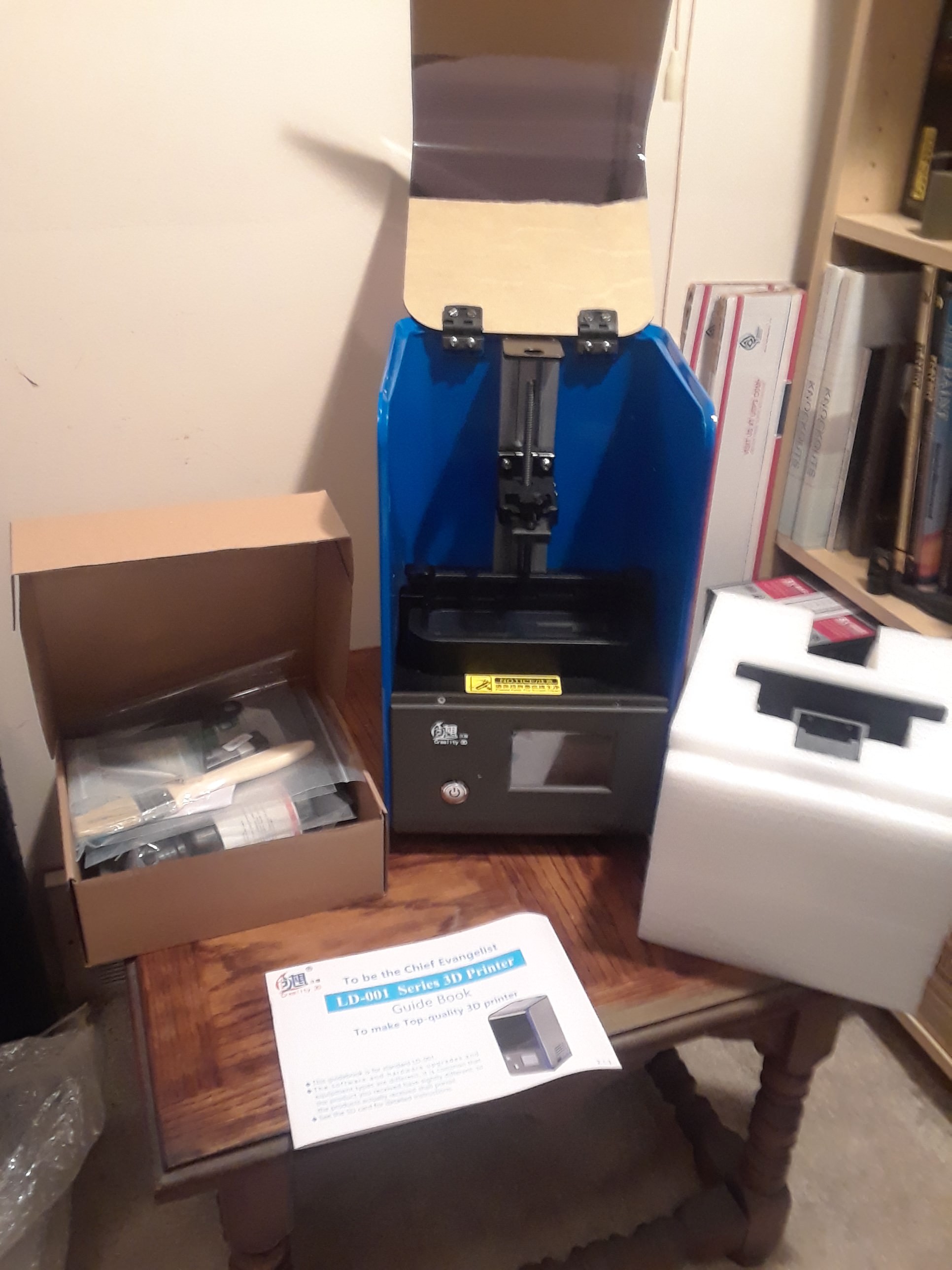

Crius 12-17-2018 04:09 PM
2 Attachment(s)
OK, sports fans, this is a new resin printer, the creality LD-001
Attachment 2263022
After much frustration and the pulling of about 40% of my hair, I now have a file in the printer that will print two tires at once. I'm using ExPatTanker's design for the tire. I also plan to try tail lights like the ones I just put on my Q60.

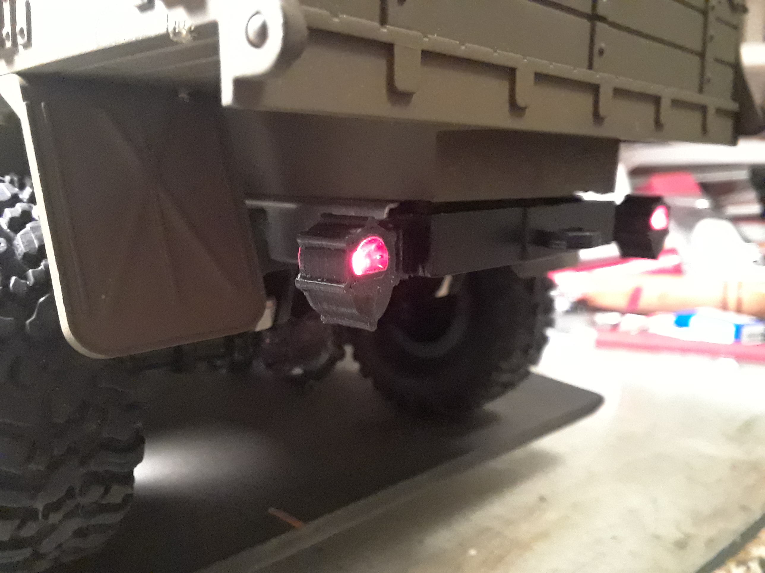

Attachment 2263023
These were done on the CR-10 FDM printer, so I think it will at least be interesting to get a side-by-side comparison between FDM and SLA. Filament vs UV, so to speak. The tail lights are also ExPatTanker's fine design. I'm thinking about mirrors. Mirrors of several types to cover a range of the new trucks. I need some help with design, though. Any takers? At the least you'll get some better mirrors from the resin printer. Those (as well as tail lights) I can send anywhere for the cost of a Christmas Card.

Ex_Pat_Tanker 12-17-2018 10:54 PM
I can knock up some WW2 mirrors - they are a bit of round glass on a stick afterall, and the stick would need to be fine wire anyway so that simplfies the problem ;)

Crius 12-23-2018 12:39 PM
I think the ultimate would be SLM, and I could print parts in brass.
I can't get my new SLA printer to print. Hmmm, kinda like my boomerang won't come back. The problem is somewhere in the software (most likely operator error) but I get everything to work like it should until I put the USB bar back in the printer. It shows the file I just downloaded, no problem, but when i hit print it tells me to get bent (it tells me that simply by refusing to do anything at all). The only thing that will print is the test print that's built in, but I really have very little use for a bunch of cubes with holes in them. BUT, the print quality on the test print is superb. Light years ahead of filament printers. Another advantage is this - if I want to print a tire on my FDM printer (CR10) it will take about four hours. If I add another tire to the print it will take about 8 hours, and longer for every tire I add. In the SLA printer it takes about four and a half hours to print one tire, but if I add seven more tires and print eight at once it takes ... about four and a half hours. That's because it prints an entire layer at once, instead of traveling around and putting down filament.
So since I can't get the resin to go I guess i'll try a new trick on the CR10 and see if I can scale up some jerry cans for my 1/6 Hetzer. ;)

Crius 12-24-2018 02:15 PM
Hey Guys, thanks for the replies.
The Z zero is set when you level the bed, and seems to be OK as the test print ran fine. The USB bar seems to be reading OK when it's in the printer so I think things are connected OK. The software is called 3D Creator and I can import an stl file (the same file I use in my creality FDM printer) and I can add support and preview and slice it and export it to the USB bar and when i put the USB bar back in the printer the file shows up on the screen as ready to print. That's where stuff goes kerblewie. What's supposed to happen - hit print, screen comes up for light settings, set for 75 seconds first layer, 10 seconds thereafter. Hit print, screen goes to in print mode and printer prints. What's actually happening - the first time I hit print after downloading the screen goes to "preparing file for printing" and then does nothing. I let it sit as long as two hours and nothing changes. If I then hit Home it goes home and i can then hit print and it shows the file again. I hit print and this time it shows the light setting screen, as it should, but after setting and hitting print it just does nothing. I'm totally at my wits end. If i can't solve this issue it will have to go back. The good news is that if i do have to send it back I'll stop fartin' around and get the peopoly kit for $1,200. More than twice as much, but tried and true and plenty of support for stuff like this current snafu. And all the reviews are raves and it's said to be a high quality, excellent performing machine. I know part of my problem is that this LD-001 printer is brand new from creality. cura doesn't even recognize it, but then, cura doesn't recognize any resin printer, as far as I know.
So if anyone else has ideas i'd love to hear them. I've tried different methods for exporting to the USB bar, and exporting from different folders, and they all act the same. There's a guy on youtube that has one and he's using a beta software package and i'm hoping he'll share. I'll keep y'all posted. I know a lot of guys are watching this to see how it goes before taking the leap into resin themselves, so i really hope i can get things sorted. Oh yeah, on the test print the quality is light years ahead of my FDM printer, You can barely detect the layer lines and little or no clean up is required. It's frustrating in many ways, but one is that i can't wait to see what kind of results I get with small parts, like tail light buckets for trucks, which i happen to need right now. Then there's truck drivers, and the list goes on.
RC_BobM 12-26-2018 10:26 AM
Gary,
Sorry to hear still no love from this thing. You will love the resin printer if you can get it going. There is nothing better for detail parts. The Moai is a nice machine. Personally I would get the Form2. Its a bit more - but they are industry standard for the resin printers. But the Moai should be great too.
You mention this: "cura doesn't even recognize it, but then, cura doesn't recognize any resin printer" - I wonder if the printer is waiting for some kind of G-code or move command code to say "go", and that Cura is not adding it? Its like post processing CNC G-code, after the machining program is written it has to be translated (post-processed) for the specific machine controller.
Is Creality support available? Surely being in China they are not closed for holidays? One other review of this machine mentioned some issues that tech support had to resolve.

RC_BobM 12-26-2018 10:31 AM
Gary
One other thought. Take the test print file and open it in a text editor like Notepad. Look at the beginning code of the program. Compare this to the code of your part you are trying to make. The g-code may be different. You just want the few preparatory commands not the printing part. Its a stretch I know - but I've done this with CNC programs and it works.

Ex_Pat_Tanker 12-26-2018 01:49 PM
Originally Posted by RC_BobM (Post 12488555)
Gary,
Cura is for FDM printers only, it can not create instruction files for any other method of printing.

Wozwasnt 12-27-2018 03:10 AM
Make sure there are no spaces in the file name of the file you're trying to print.
