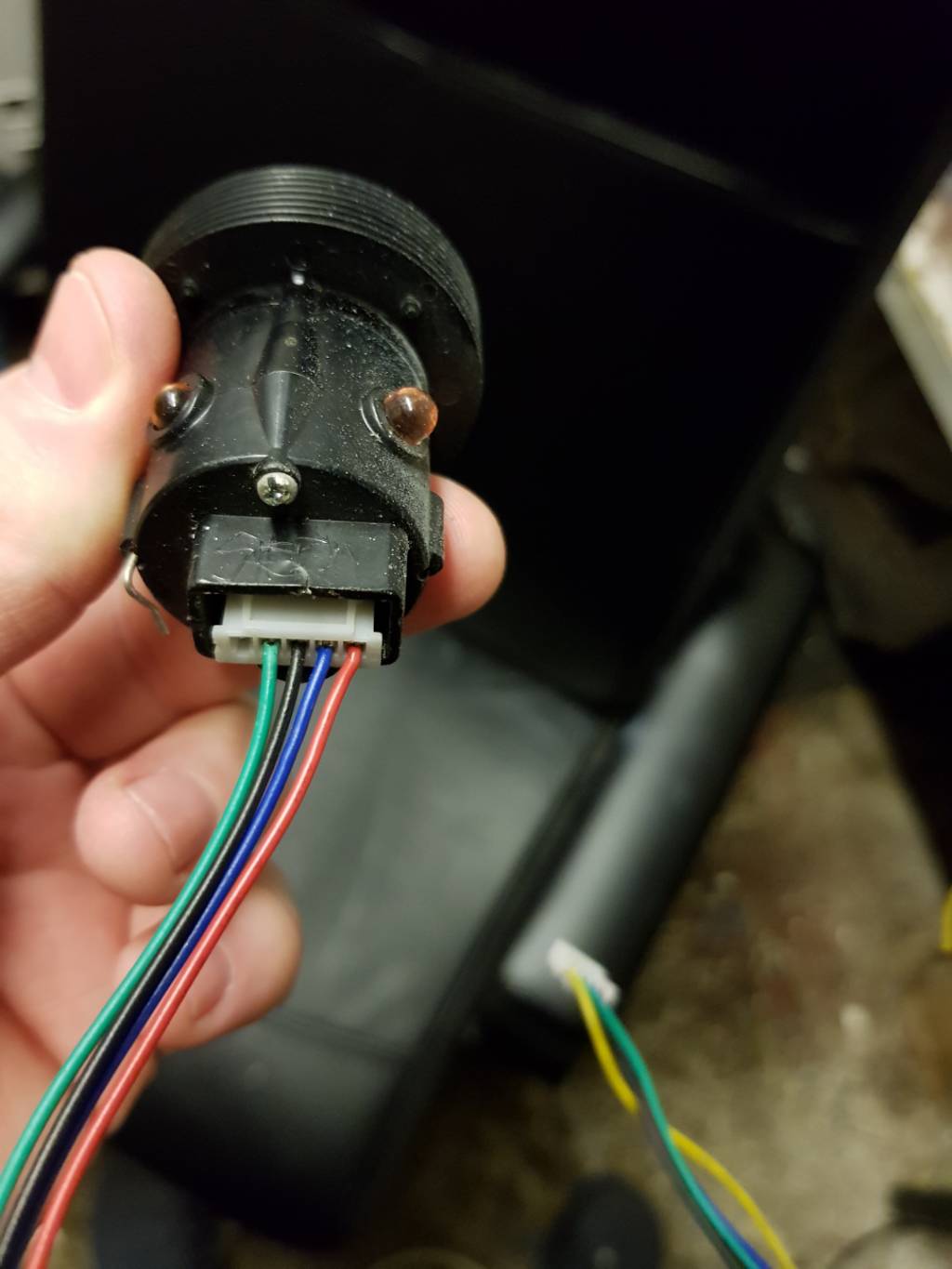

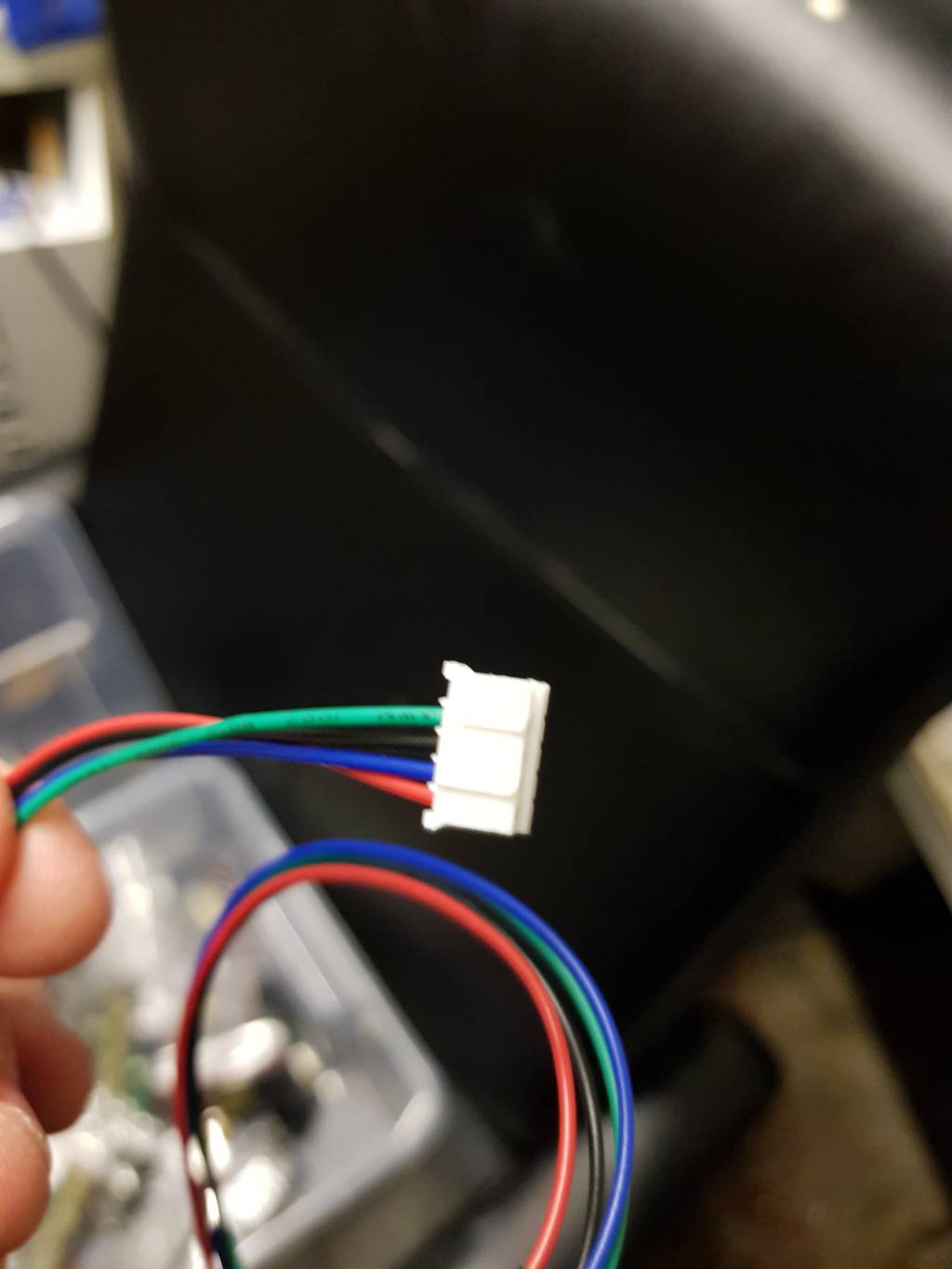

For those of you looking at the Mako2018 "battle conversion unit" that enables the use of Heng Long or Taigen MFUs to IR battle with Tamiya battle systems using the Tamiya "mushrooms" and "IR emitters". Be warned that this product does not use the Tamyia cables and requires a non standard cable that connects the Tamiya "mushrooms" to the Mako2018 unit. This is not mentioned in the product description on the sellers website and vaguely alluded to in a few install photos found on their forum board showing a photo tectorial of the install process.
This becomes a problem when you discover the supplier does not offer this non standard cable for sale and you are left on your own to make it. So much for the alluded to "plug and play". Why this cable is not mentioned as needed or offered for add-on sale in the produce description is beyond reason. Given it took 3 1/2 weeks to receive the Mako2018 and now to have an even further delay attempting to source a one off cable, I may just end up "round filing" this thing instead for the time and trouble it is causing.
I did attempt to contact the supplier about this but for some reason their contact page is not taking inquires.

Imex-Erik 02-06-2019 01:24 PM
Do you have a picture of the plug/socket?
Fsttanks 02-06-2019 01:47 PM
Yes, this is the cable. Shown going from the Tamiya "mushroom" to the Mako2018 board. It is also the only reference to it anywhere either written or in photos. I must note that this photo is not on the produce page nor in any product section, it is on a forum the supplier runs and must be search out.https://cimg9.ibsrv.net/gimg/www.rcu...106136e648.jpg

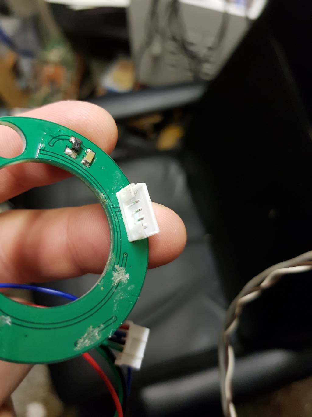

Imex-Erik 02-07-2019 06:38 AM
My Mako2 is a bit different (I have one of the older ones) however the plug looks similar. Mine is a JST-PH plug.

tomhugill 02-10-2019 09:02 AM
Firstly, knock it off with those negative vibes.
What makes you think the plugs none standard?
Have you tried plugging in a TBU base?
I have the RCTA tiger and panther ring and the default plug they come with is the same molex connector that tamiya use so it would seem odd that the mako would use something different. Why would you expect it to come with a cable? No other electronics board does, that should come.with you battle system.

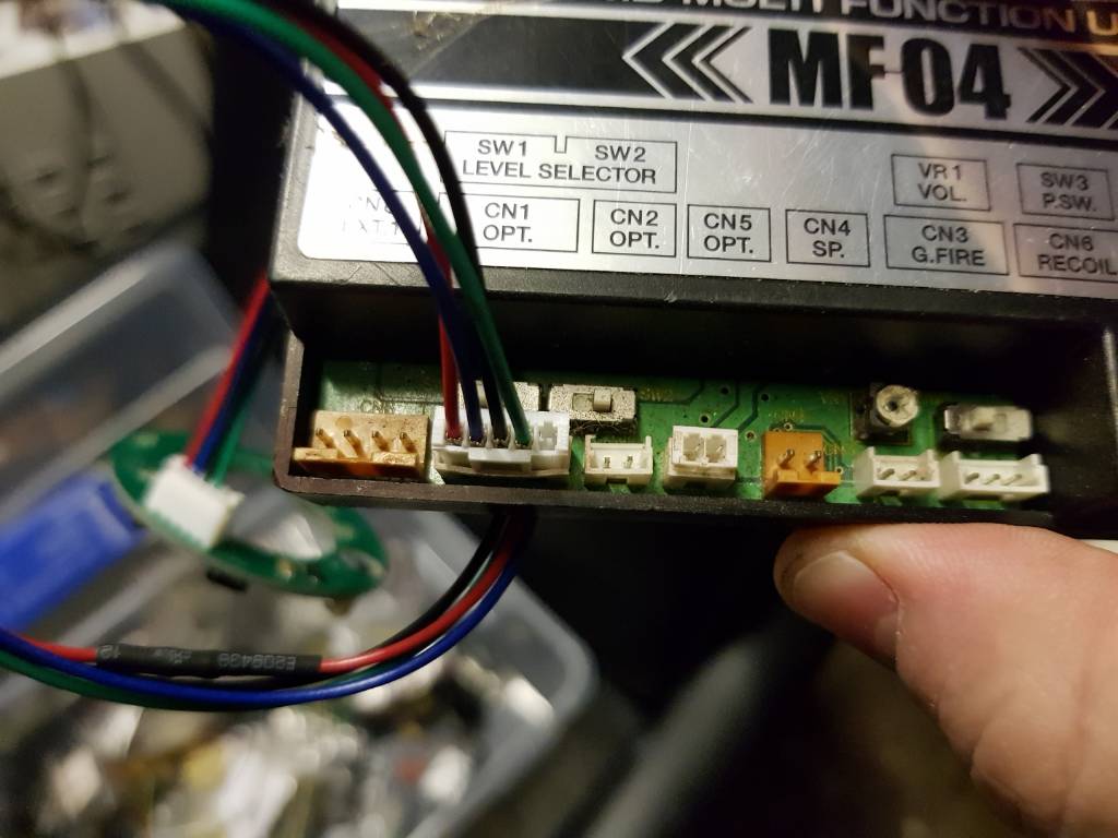

RichJohnson 02-10-2019 09:15 AM
Well, looking at his photos, I do not see a plug socket for the TBU base plug.
So it seems they intend for you to use a 5 pin JST harness between your TBU Apple and the mako board. It seems they didn't send him one, didn't tell him he needed it, and he says it doesn't look like they sell the cable. Im not involved, but I would think that they would or should offer the cable if its needed to be Tamiya Compatible.

Ex_Pat_Tanker 02-10-2019 11:23 AM
Looking at the picture, I think what you need is one of these:
https://www.ebay.co.uk/itm/JST-XH-Ma...r=540416152308
As the description states, its commonly used for charging 4S lipos so you should be able to source it locally?
I'm guessing that the Mako was intentionally designed to dispense with the Tamiya connector so that you can share the apple with other tanks and not have to buy an additional base. The Tamiya micro connector is not easy to find preassembled in my experience, and crimping those tiny pins yourself is an exercise in frustration to say the least - it makes much more sense to use a common off the shelf lead, jam one end into a blob of miliput under the turret hatch, and plug the other end into the Mako...
Hope this helps.

Having gone and googled the difference between a JST XH and a JST PH connector, I'll add that the PH has a 2mm pin spacing, and the XH has a 2.54mm spacing - anybody wanting to make up their own bases will need a socket with a 2.54mm spacing for the TBU end of the cable.

RichJohnson 02-12-2019 07:34 AM
Im not sure what your talking about Tom, because that Mako board in his photo does not have the small 5 pin plug socket for the Tamiya BU cable plug. Its pretty clear, he has a TBU, he has the board, the board doesn't accept the TBU. His version is not the one you are thinking of that you have stated takes a TBU base plug.

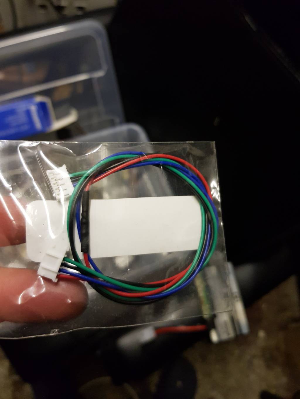

tomhugill 02-13-2019 01:14 PM

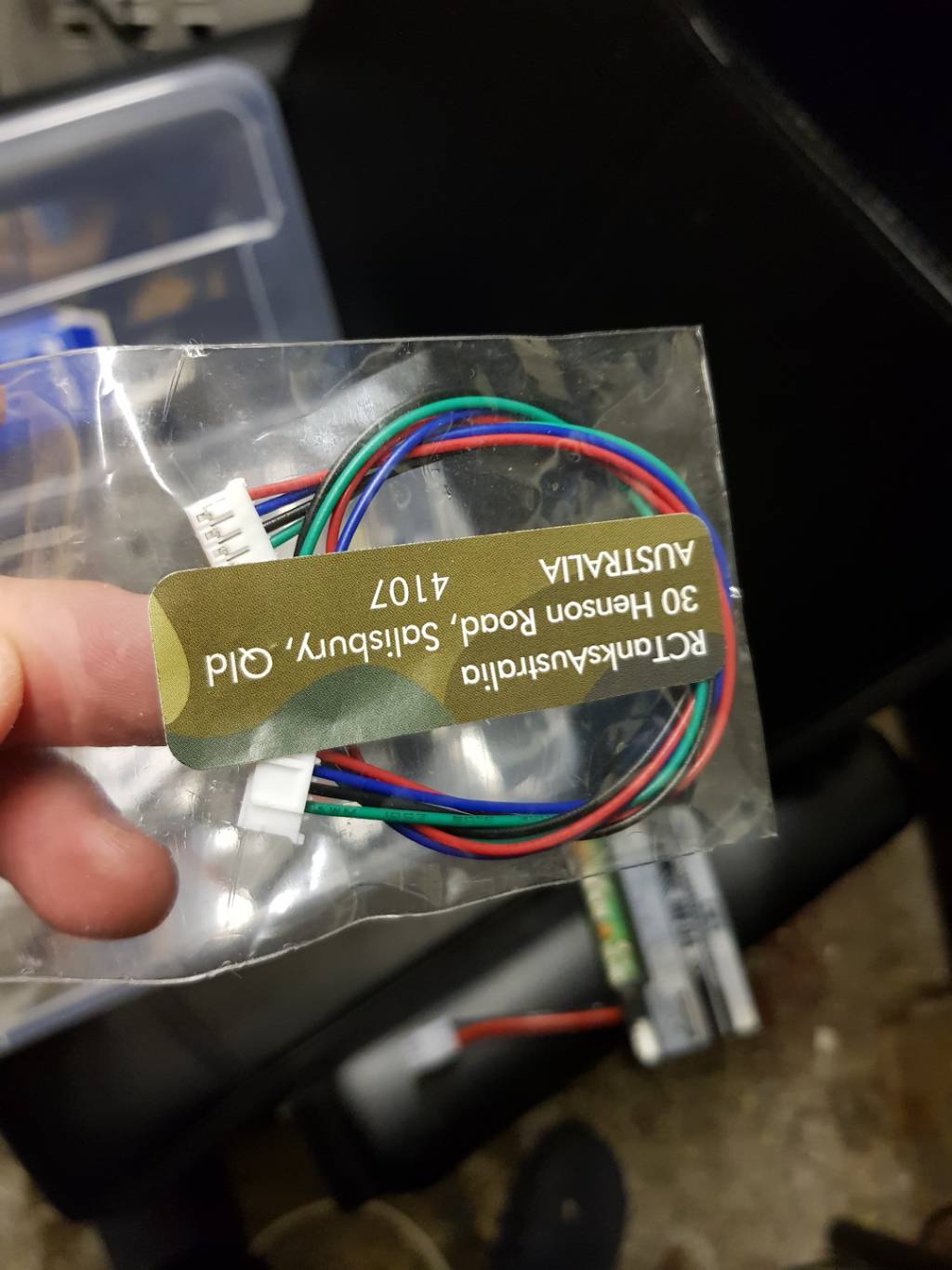

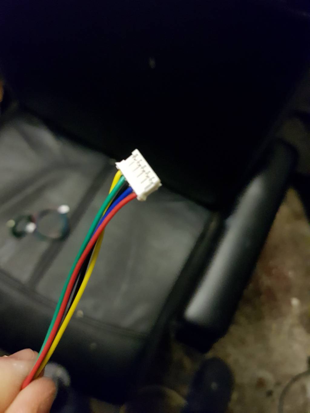

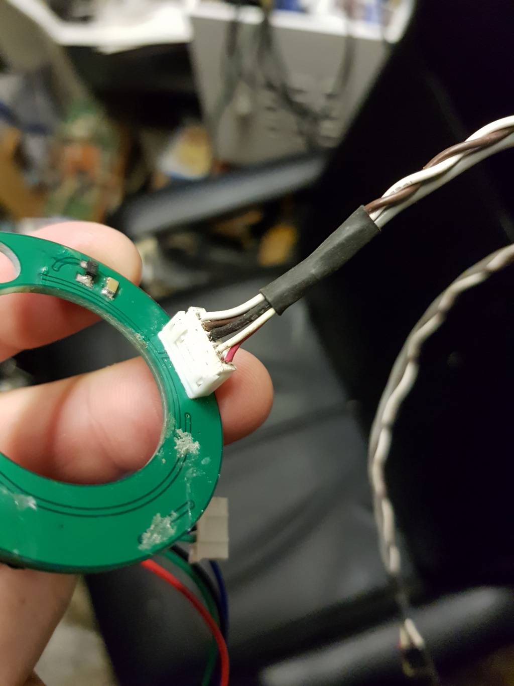

8 Attachment(s)
So if you wish to wish to connect a tamiya apple to a mako 2018 you can use the HL size 5 pin (which I believe is the jst plug with 2.54mm pin spacing) and the jst pH (same pitch as tamiya) on the other end.
Below are some shots of the jst pH fitting a tamiya mfu slot, and a molex fitting the jst pH female plug (on a tiger ring but same as the one on the mako 2018).
This is why I don't understand why your having issues fitting a TBU to a mako2018. If you aren't using a TBU base but want to use the tamiya apple you need to use what I've described about but I don't think it's reasonable to expect this with the mako!
(As an aside when I bought my tiger and panther rings, I asked Kevin if he could use the HL 5 pin size plug so they would fit my Clark boards and he very kindly did, that same cable would connect your apple to a mako without the tbu base).
