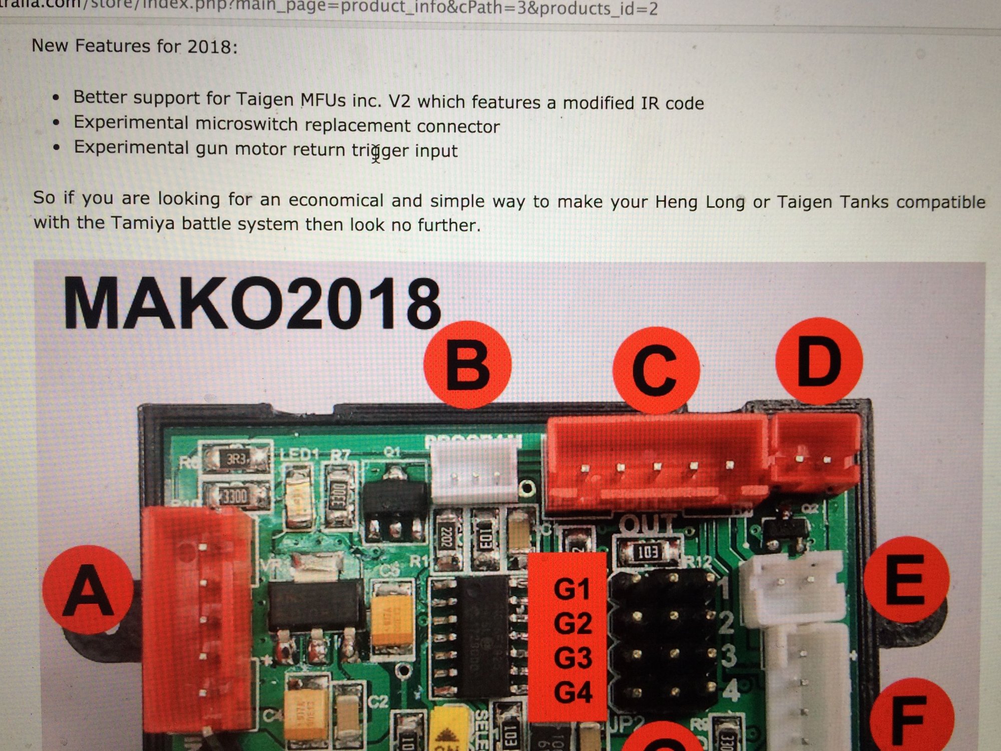

For those of you looking at the Mako2018 "battle conversion unit" that enables the use of Heng Long or Taigen MFUs to IR battle with Tamiya battle systems using the Tamiya "mushrooms" and "IR emitters". Be warned that this product does not use the Tamyia cables and requires a non standard cable that connects the Tamiya "mushrooms" to the Mako2018 unit. This is not mentioned in the product description on the sellers website and vaguely alluded to in a few install photos found on their forum board showing a photo tectorial of the install process.
This becomes a problem when you discover the supplier does not offer this non standard cable for sale and you are left on your own to make it. So much for the alluded to "plug and play". Why this cable is not mentioned as needed or offered for add-on sale in the produce description is beyond reason. Given it took 3 1/2 weeks to receive the Mako2018 and now to have an even further delay attempting to source a one off cable, I may just end up "round filing" this thing instead for the time and trouble it is causing.
I did attempt to contact the supplier about this but for some reason their contact page is not taking inquires.

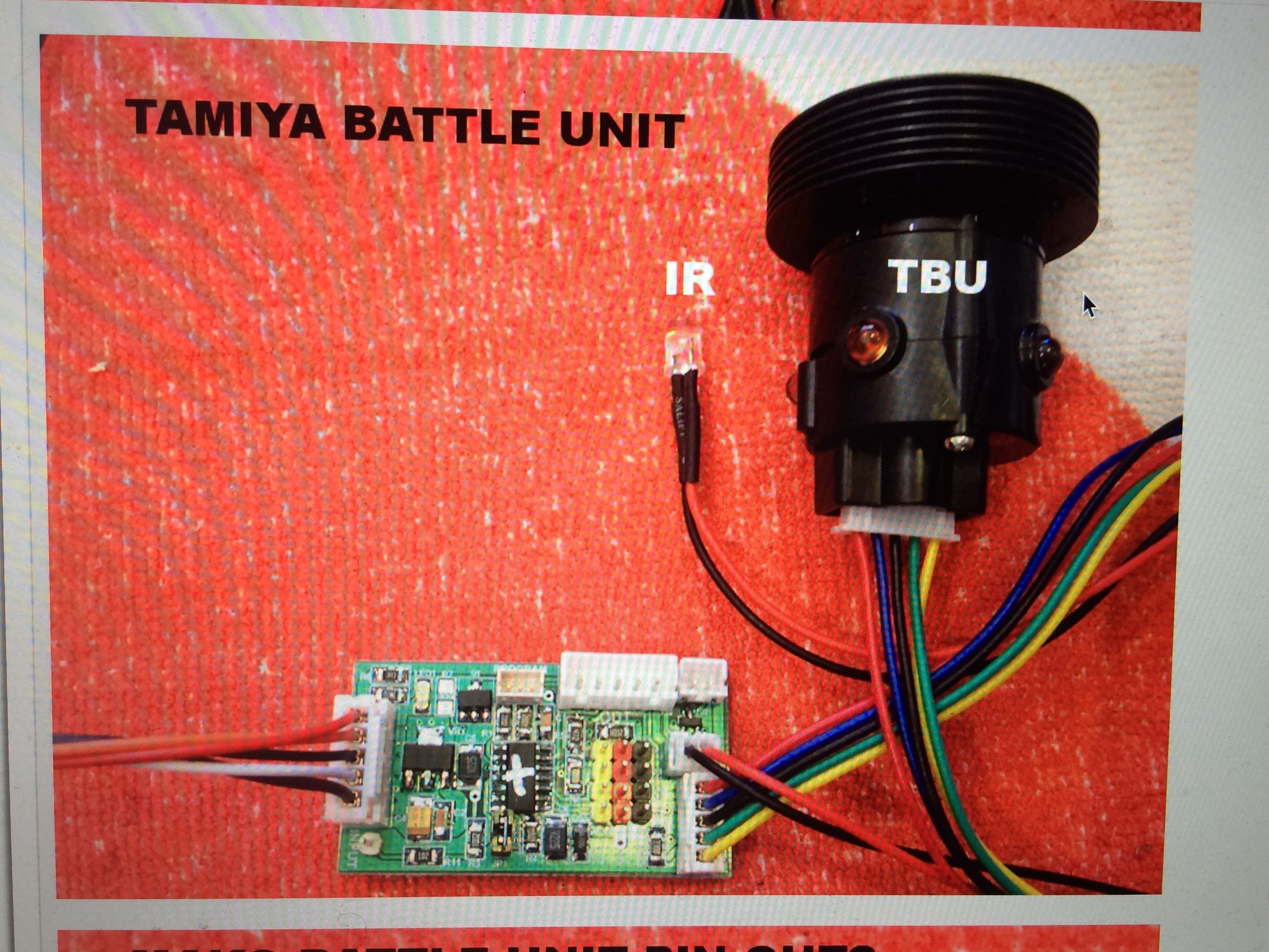

Yes, this is the cable. Shown going from the Tamiya "mushroom" to the Mako2018 board. It is also the only reference to it anywhere either written or in photos. I must note that this photo is not on the produce page nor in any product section, it is on a forum the supplier runs and must be search out.

Well, looking at his photos, I do not see a plug socket for the TBU base plug.
So it seems they intend for you to use a 5 pin JST harness between your TBU Apple and the mako board. It seems they didn't send him one, didn't tell him he needed it, and he says it doesn't look like they sell the cable. Im not involved, but I would think that they would or should offer the cable if its needed to be Tamiya Compatible.

That said let me start by clearing up a few things for you. First, I said "one off cable", I did not say plug, there is a big difference.
Second, the FACT is the cable/plug combination is not available on the web site nor mentioned as needed anywhere on the MAKO2018 product page (at the time of my first post) and it does not use the same cable/plug that come standard with the Tamiya battle units. I have two new TBUs and neither use the cable/plug shown above.
Third, I did not expect it to come with anything more than the board and NOWHERE do I say this, what I expect and others too is that the need for this cable be clearly stated and offered as an extra add-on "for sale item" in the product description. Fact is, it is not.

Looking at the picture, I think what you need is one of these:
https://www.ebay.co.uk/itm/JST-XH-Ma...r=540416152308
As the description states, its commonly used for charging 4S lipos so you should be able to source it locally?
I'm guessing that the Mako was intentionally designed to dispense with the Tamiya connector so that you can share the apple with other tanks and not have to buy an additional base. The Tamiya micro connector is not easy to find preassembled in my experience, and crimping those tiny pins yourself is an exercise in frustration to say the least - it makes much more sense to use a common off the shelf lead, jam one end into a blob of miliput under the turret hatch, and plug the other end into the Mako...
Hope this helps.

Having gone and googled the difference between a JST XH and a JST PH connector, I'll add that the PH has a 2mm pin spacing, and the XH has a 2.54mm spacing - anybody wanting to make up their own bases will need a socket with a 2.54mm spacing for the TBU end of the cable.
