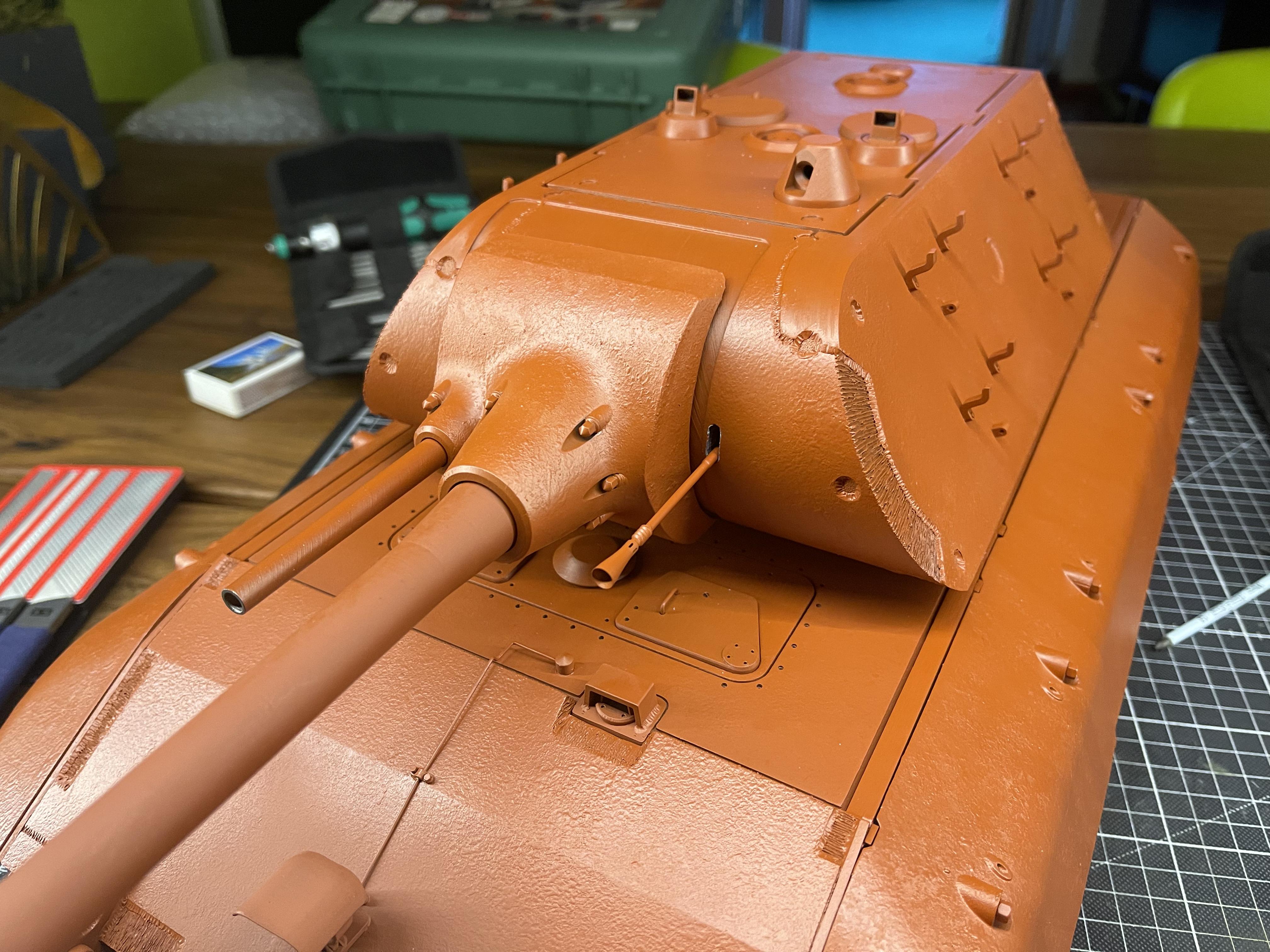

Thought I'd be throwing my W.I.P. 3D Printed 1:16 E-100 into the fray 😁
For a more thorough read along the build journey there's an Imgur Gallery that gets updated as I chugg along with the current project goal being a Display Stand Model and the obvious long-term one being a Full-Option FPV capable RC Model.
Latest Images from the above-mentioned Gallery:
Attachment 2271917
Attachment 2271918
The model kinda started like two years ago with the intent of CNC machining it using my Inventables X-Carve 3-Axis CNC Machine out of scale thick plastic but the lack of affordable plastic at that thickness kinda soured the mood to continue it for a while despite the Tracks already having been SLA 3D Printed on my Formlabs Form³. The lack of a Metal Working Lathe and the unwillingness of local companies to even respond to pricing requests for having things like the Barrels and various Axles turned didn't exactly help either.
Still... At some point I even considered having the entire Tank professionally 3D Printed akin to how DKLMRC does some of their models at the expense of it losing the scale thick armor.
That obviously never matured either due to the high costs of having a model of that size made like that and the risk of it arriving totally warped wich I wasn't too much into either.

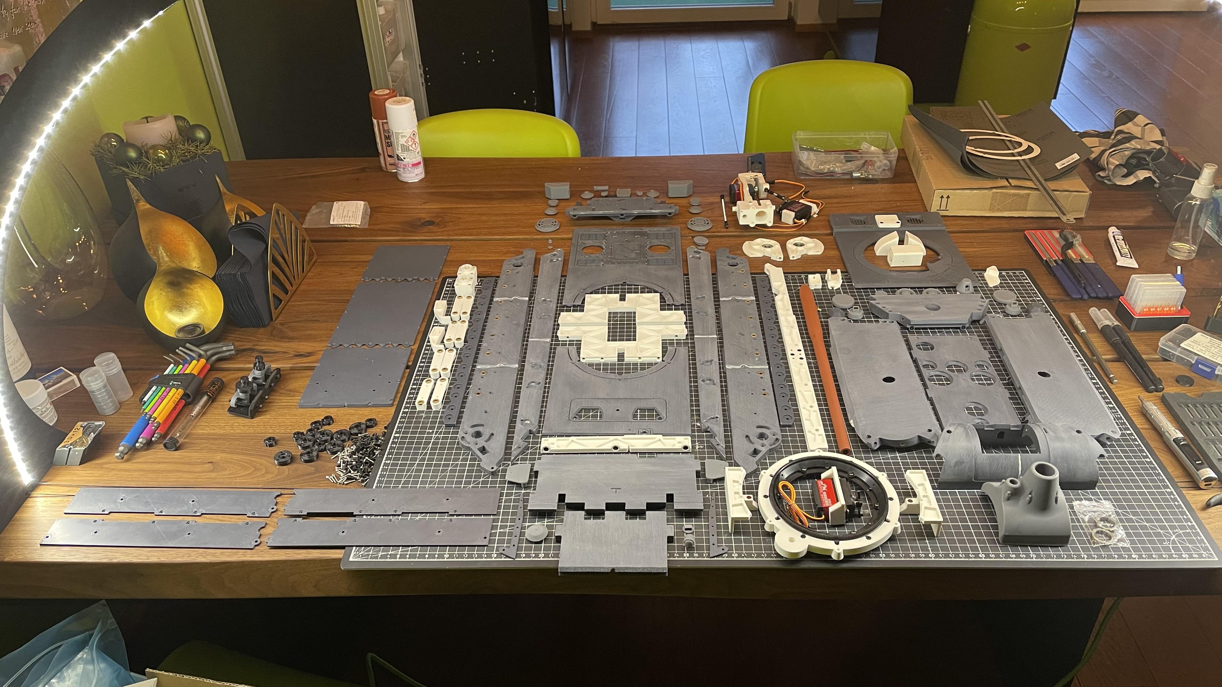

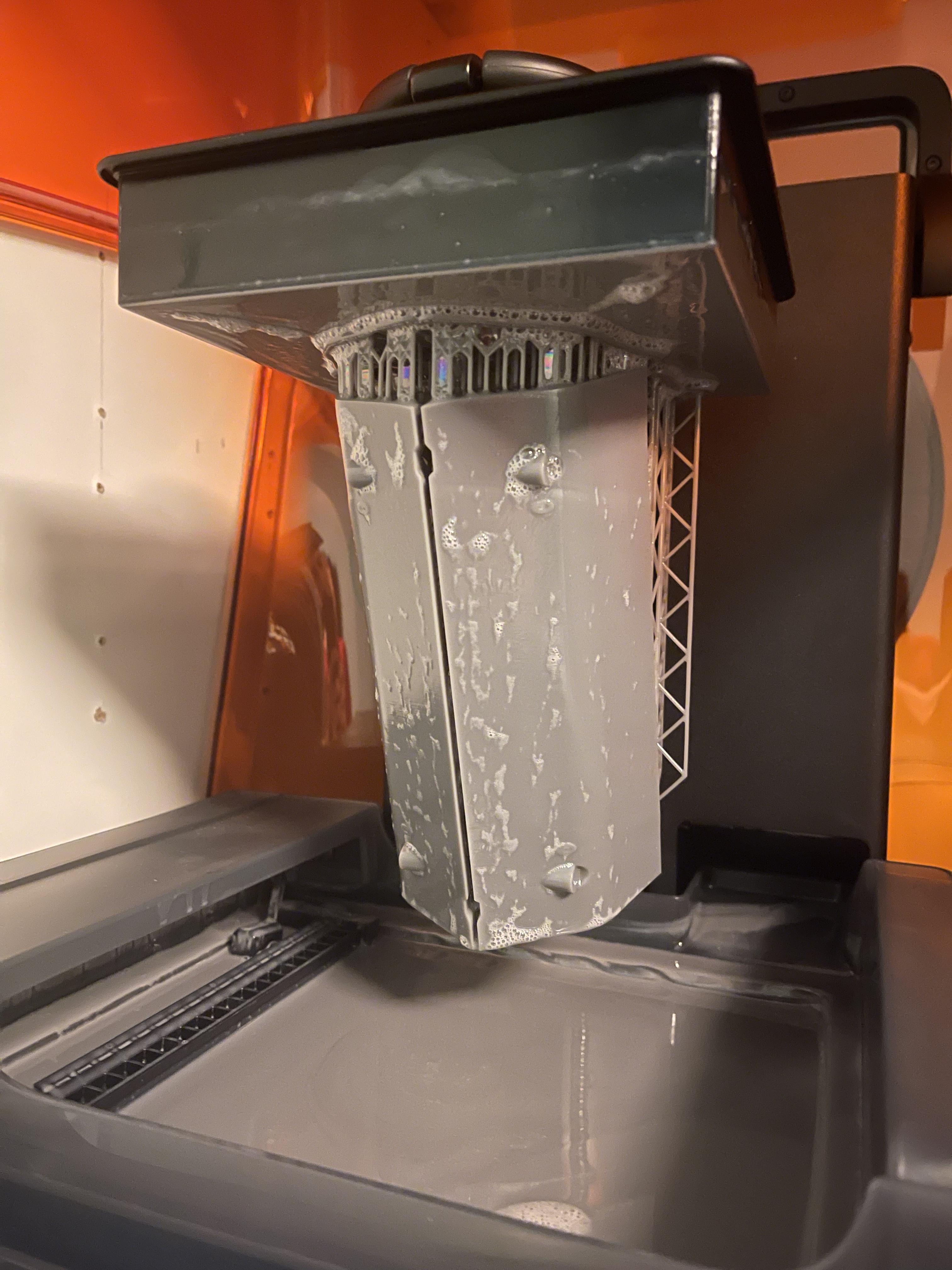

Fast forward about a year and the acquisition of a much faster Voron 2.4 CoreXY FDM 3D Printer ( compared to my back then Prusa i3 MK3S ) reignited my mood for tackling the project once more by restarting the CAD modelling from scratch due to the necessary clearances for an FDM approach not already having been part of the old CAD Files - Which also presented itself for fixing some errors and adding some neat things to it.
A week or so later a set of parts was sitting on my table:
Attachment 2271919

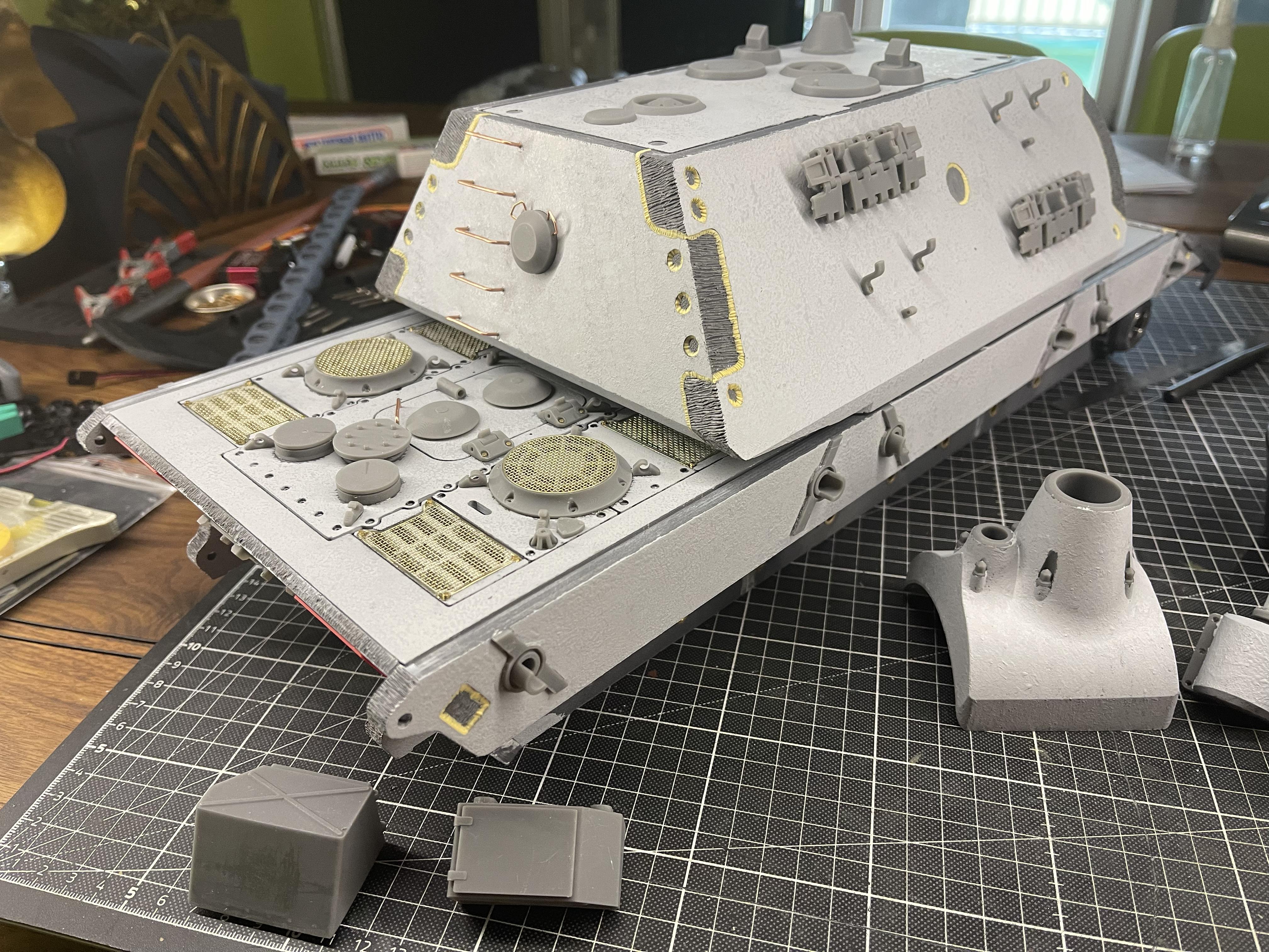

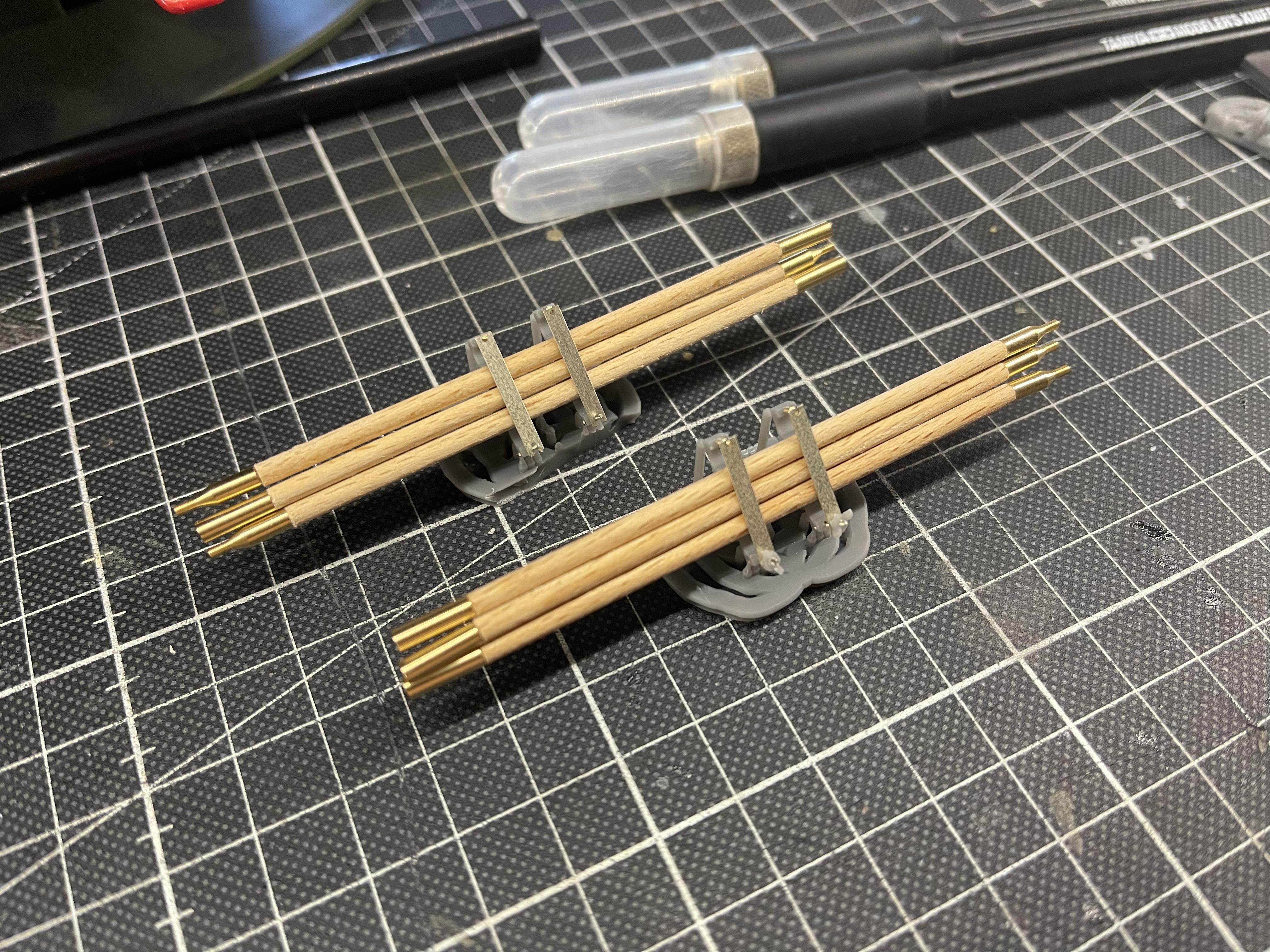

My initial goal with the new FDM 3D Printing approach was for one to make use of a panel based assembly the E-100 would lend itself to ( so no complete hull in like 3 parts with everything included ) and for the other to have an easy game with the structuring of the surface by simply 3D printing them with the visible sides facing the textured Print bed and followed by partially sanding it down for a rolled steel effect - The latter of which didn't work out as by the time I'd have managed to get rid of the unfortunately still visible layer lines the effect for the rolled steel from the bumps in the print bed would long have been gone. So, in the end Tamiya Putty Basic Type it was.

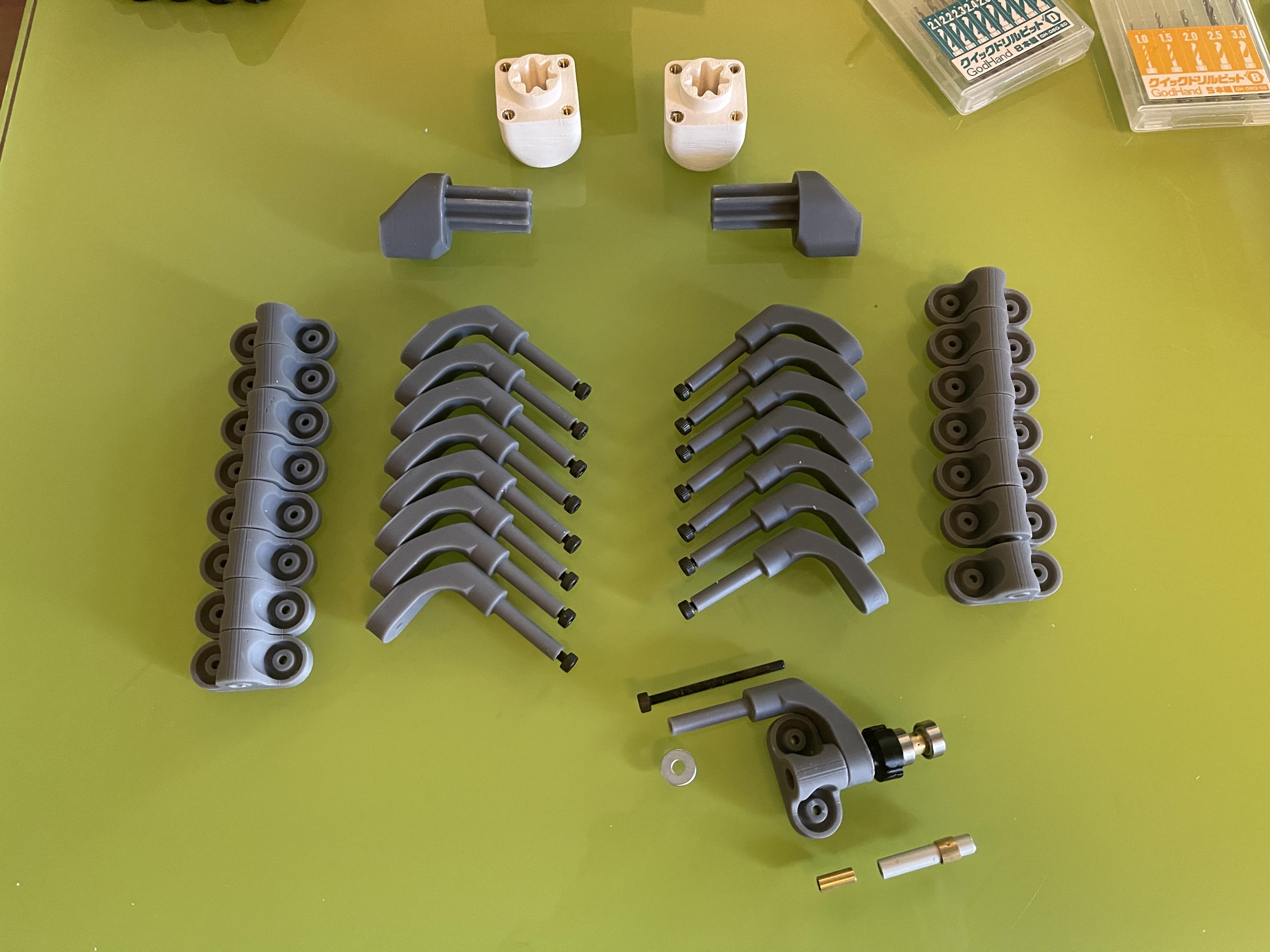

As for the Running Gear I'm currently betting on the Standard Formlabs SLA Resin to not be snapping at the slightest sneeze:
Attachment 2271920
The Test Axle in the picture is a simple 5mm Aluminium Round Stock cut to length over which a 6/5mm Brass Tube was placed onto that will keep the Wheel Bearings apart. The final ones will be made out of readily available Steel Dowel Pins with M3 Threads on one end from AliExp... Should the Swing Arms prove to be too brittle then Pewter Casting using High Temperature Silicone it will be for them.
So, yea... The Project is essentially a giant cluster**** of new experiences and problem solving because of lack of machinery 😁

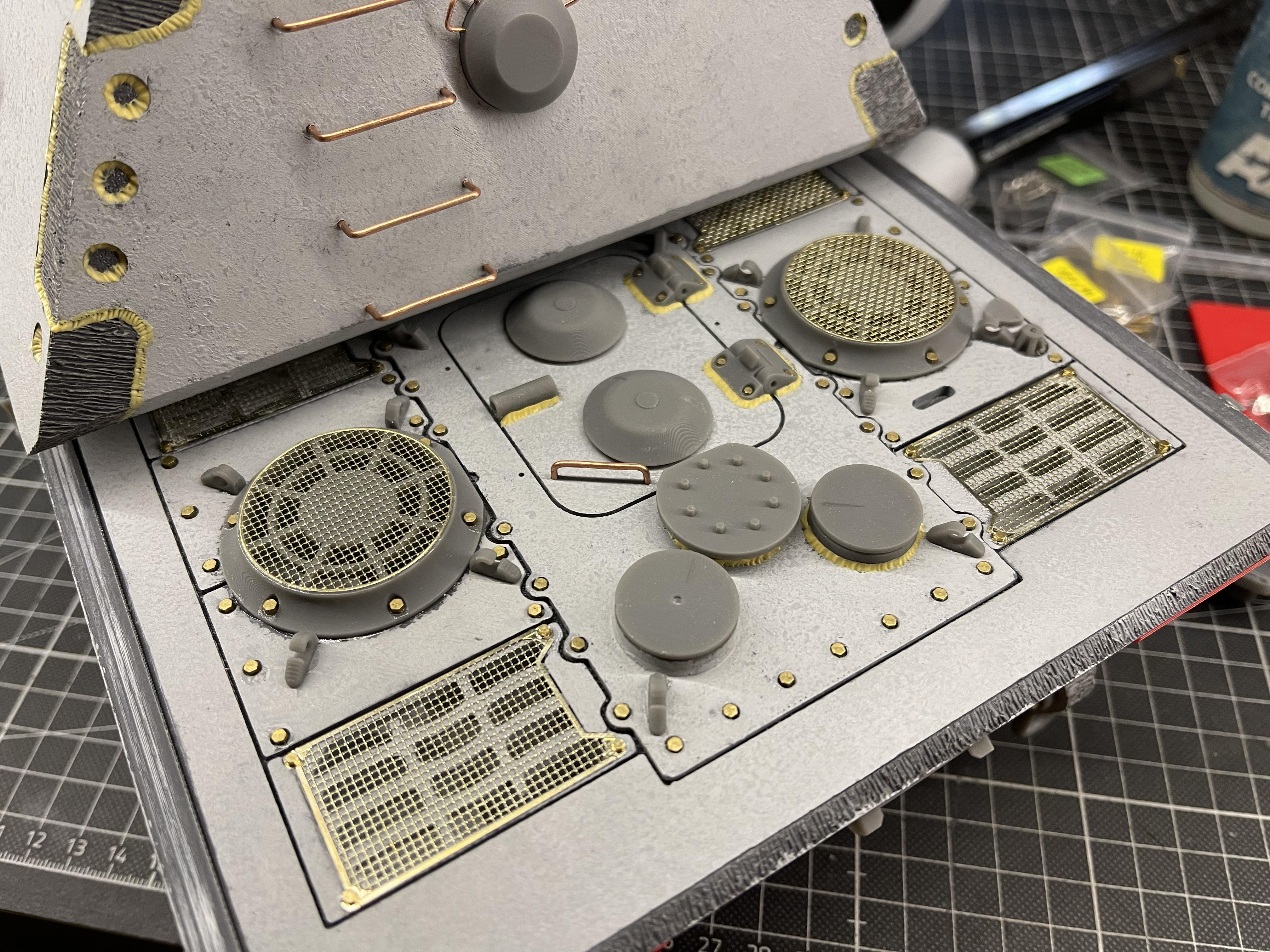

Last bunch of Screws arrived today allowing me to finish the Engine Deck ( among others ):
Attachment 2271921
I'm now going to let it sit for like a day before Priming and Painting it to give myself the opportunity for adding some other stuff to it that would benefit from being added before the Priming / Painting.
Should probably also start thinking about a paint scheme too 🤔 ( no half finished ones with the Hull done and the Turret still in Red Oxide Primer )

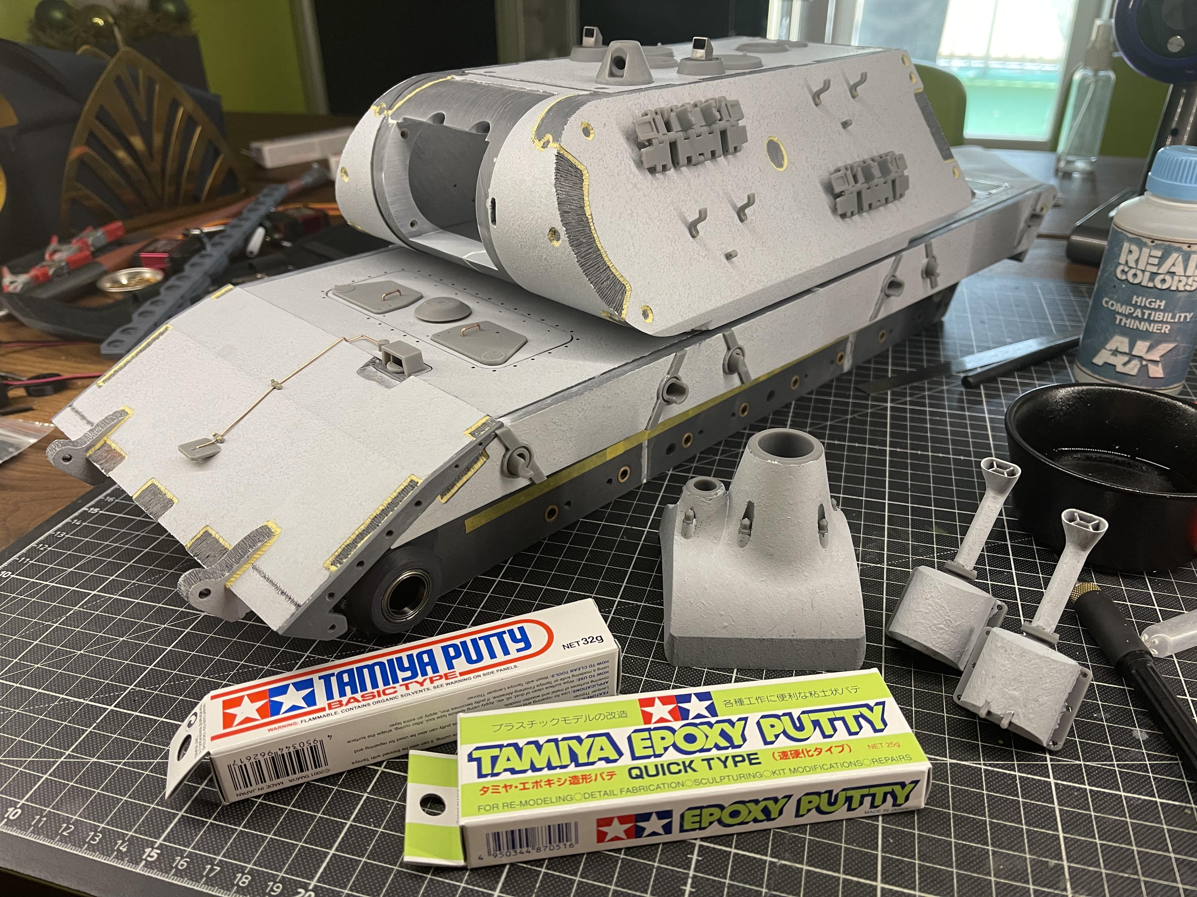

Most of the Tank has been primed ( with only the Running Gear & Tracks still left blank until successfully tested ):
https://i.imgur.com/BITWyaf.jpg
E-100 again in front of the Tamiya #56018 King Tiger
https://i.imgur.com/aaJF1ma.jpg
Rear view with the slightly modified Exhausts - Fairly pleased how the Cast Metal of the Exhaust Covers turned out - Despite having them glued on mirrored 😖
https://i.imgur.com/DQ2Rruy.jpg
View of the Engine Deck.
Magnetically Detachable Skirts:
Covering up most of the Tracks would kind of be sad which is why I've - so far - decided to only be 3D printing the Center Pieces.

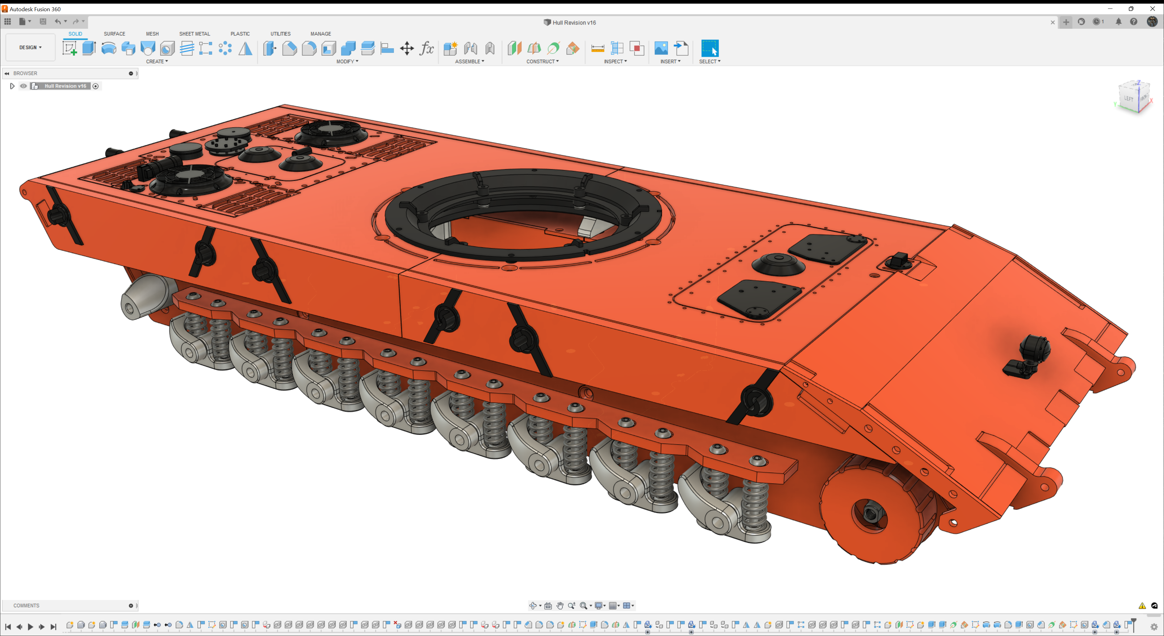

Have you decided how you will create the suspension / road wheel assemblies? Will you use the coil springs as the prototype
used or the Belleville (washer) springs that the original design intended.
Jerry
It's going to be a Spring one...
Attachment 2271935
To be honest I didn't even know Belleville was an option - And I also wouldn't know how to do them like that 🤔

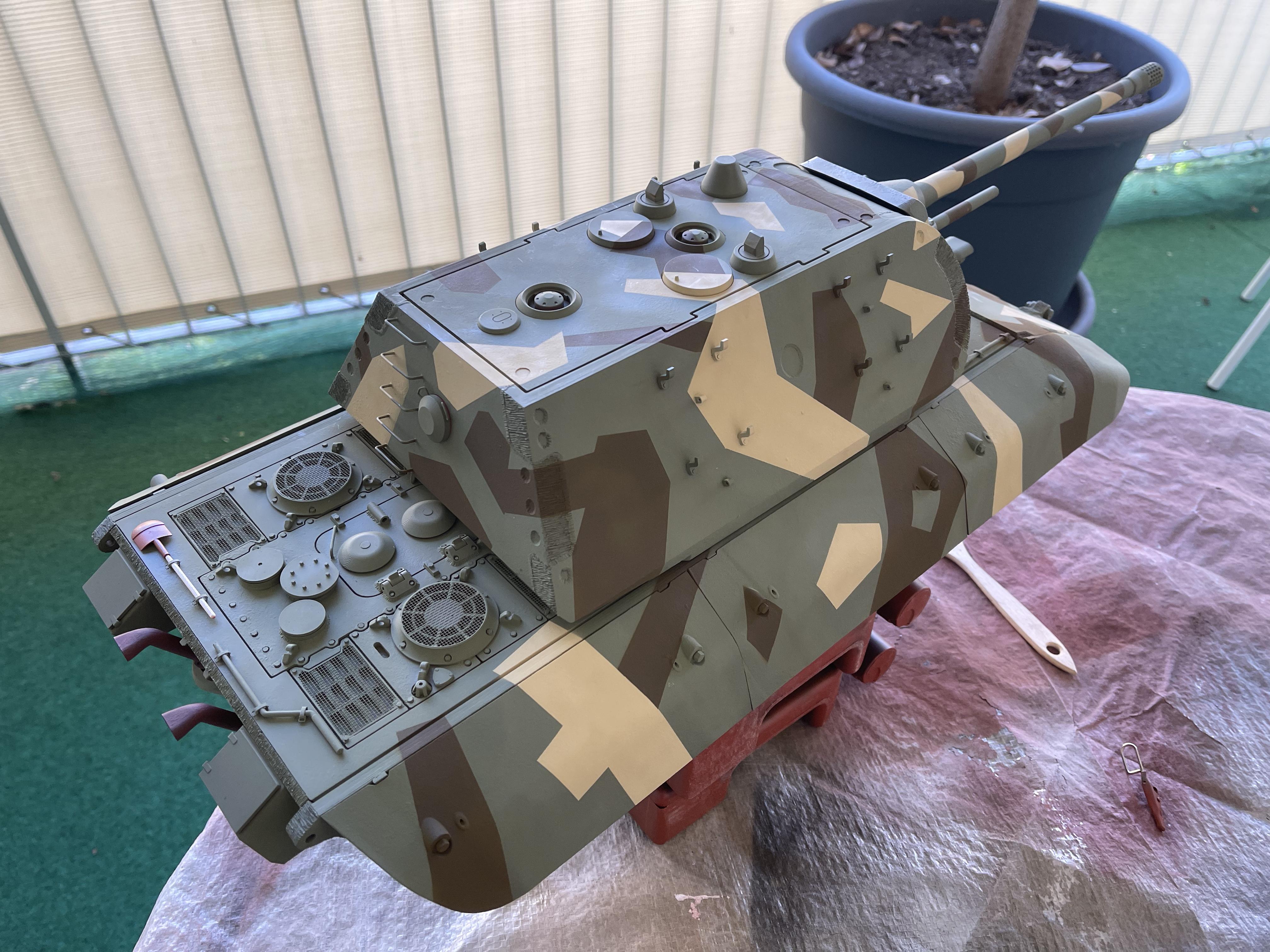

Durahl 07-02-2022 07:04 AM
We have Update!
6 Attachment(s)
Ayo... Been a few days since my last Update...

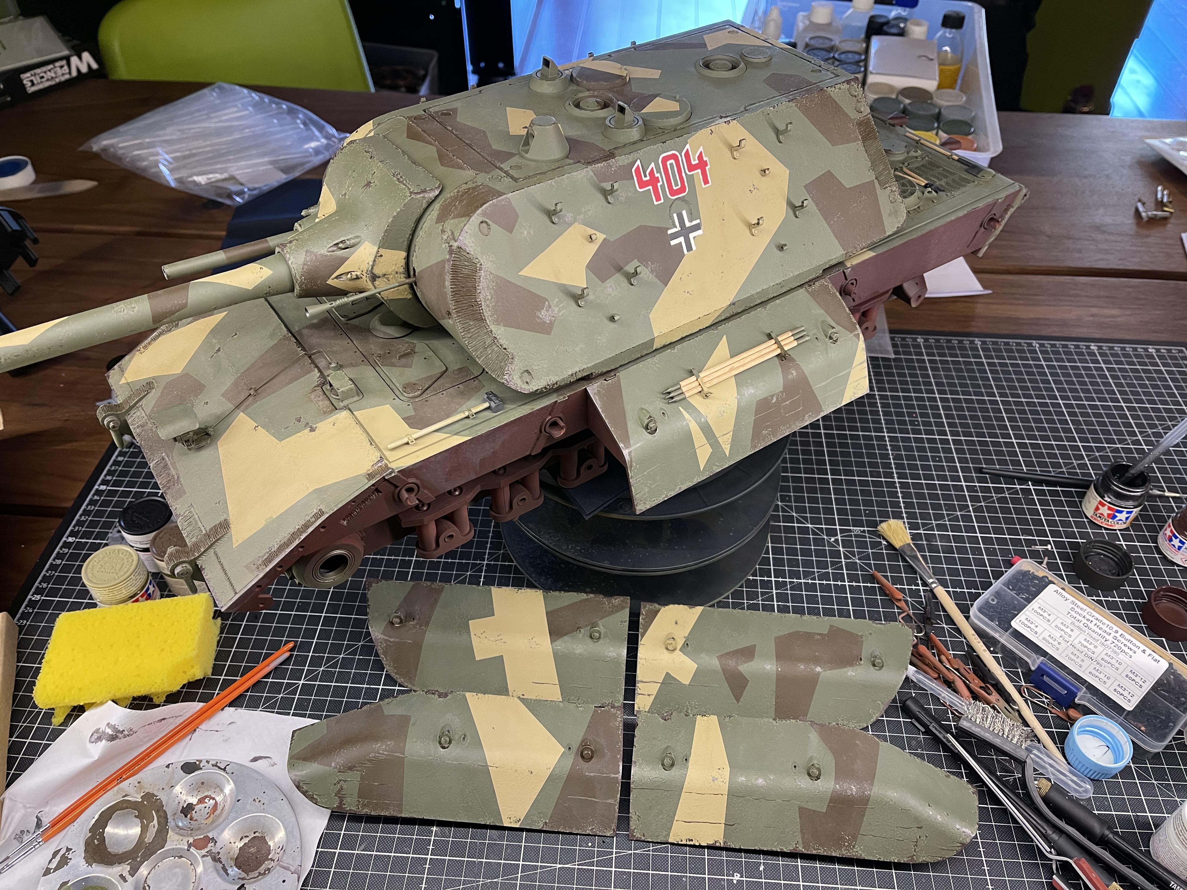

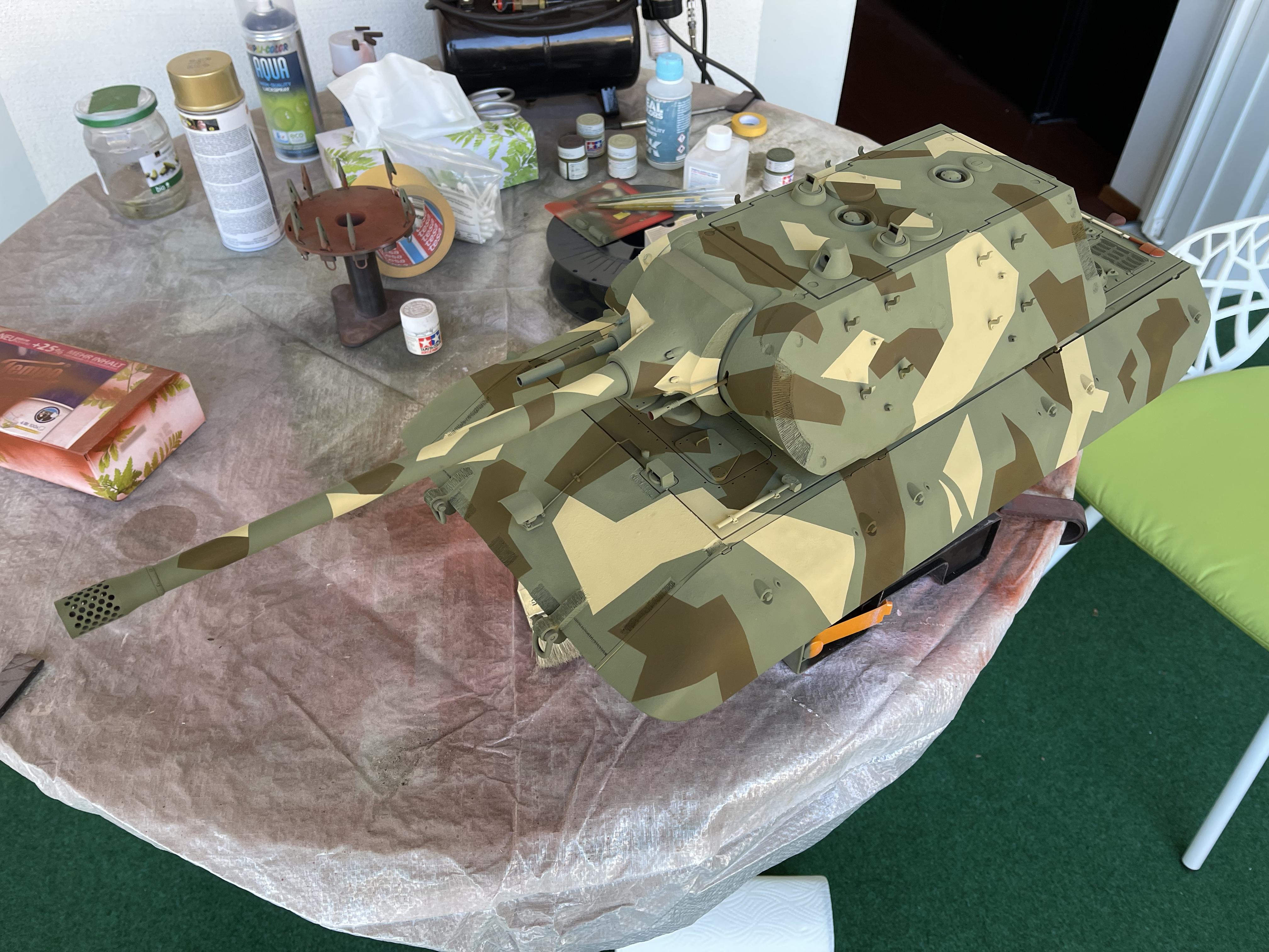

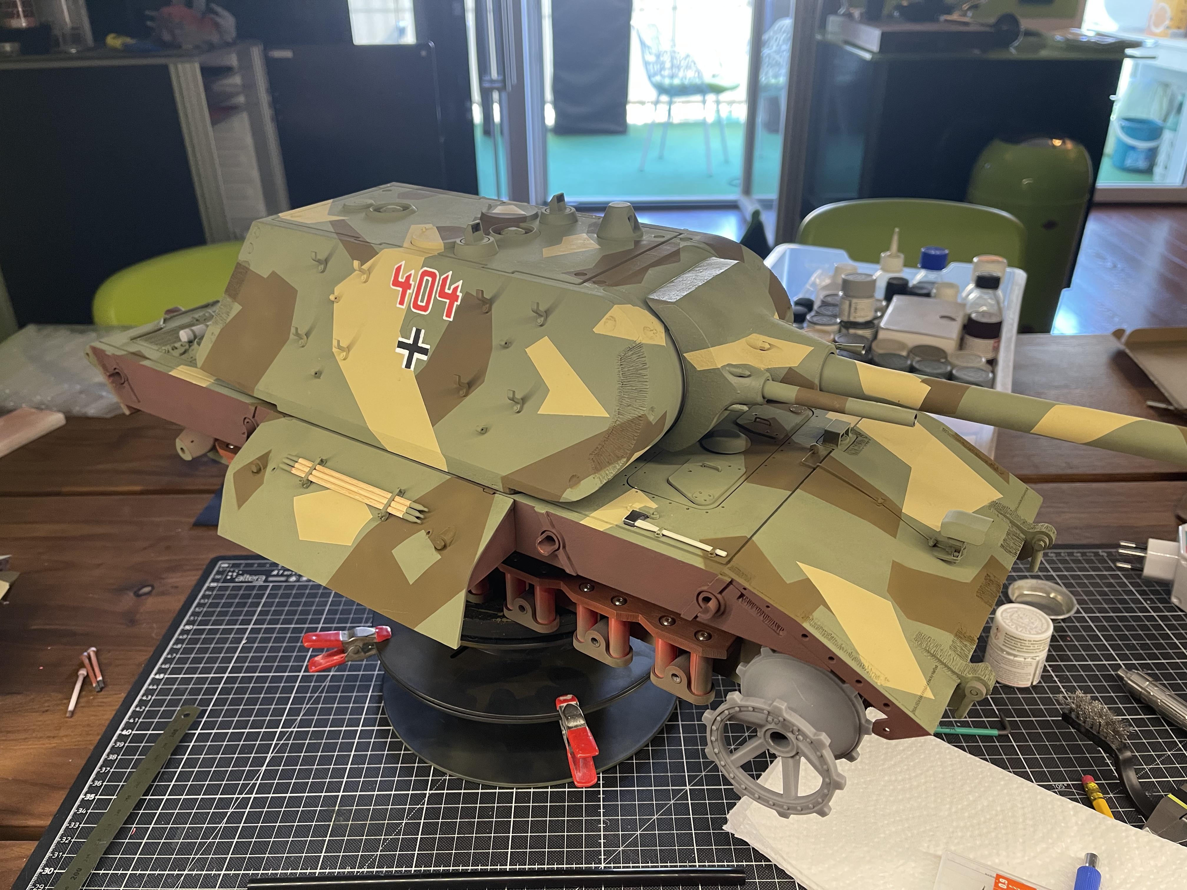

Painting has mostly been done requiring only for things like the tools to have their painting added😁
Attachment 2271965

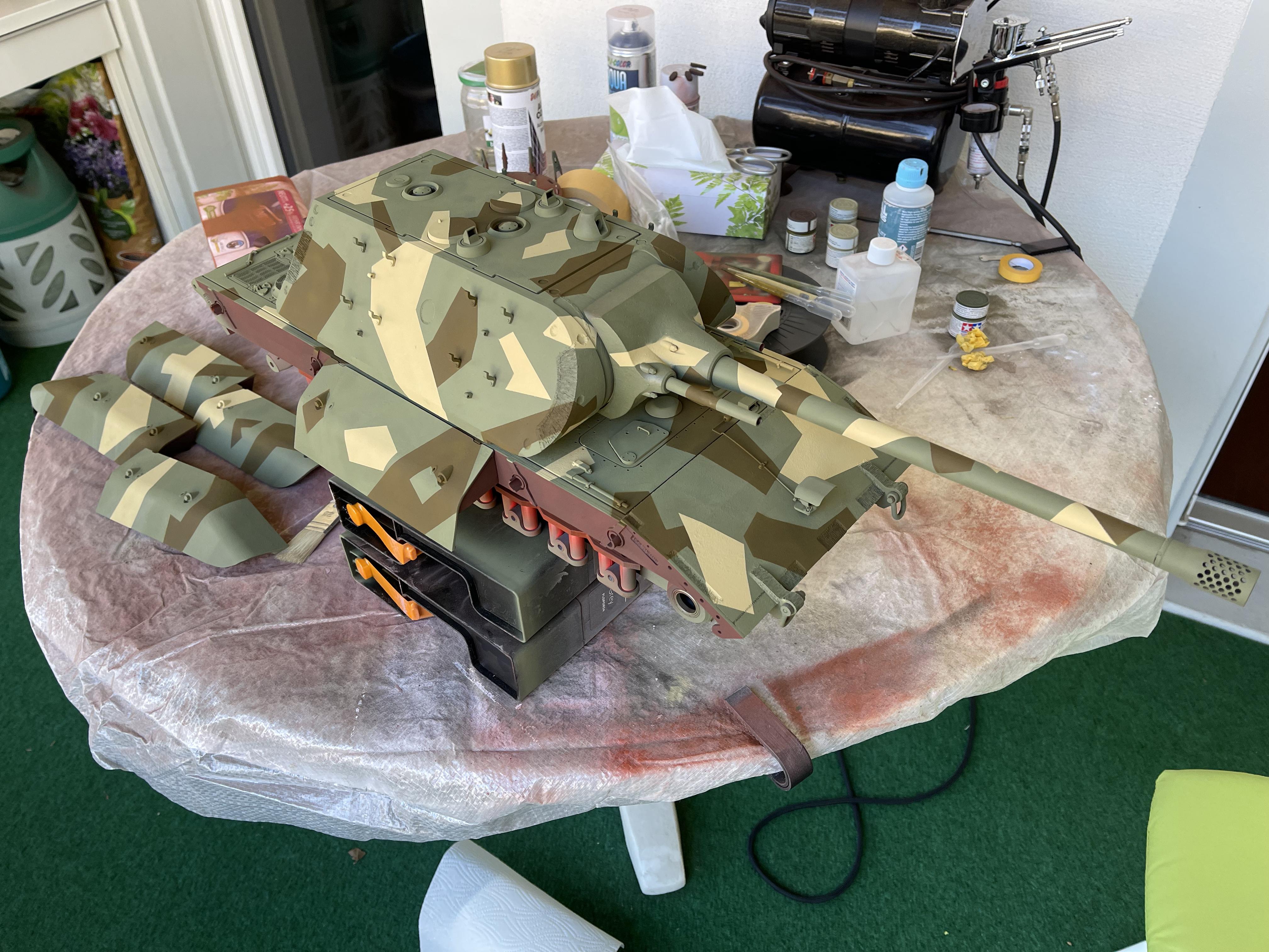

The Pattern is an almost 1:1 copy of a model I found while searching for Pattern Inspiration - I simply swapped black for brown.
Attachment 2271966
Masking and Painting was done over two days.
Attachment 2271967
Model with most of the Side Armor removed which is how I'll probably run the model.
Really digging how it came out 😁

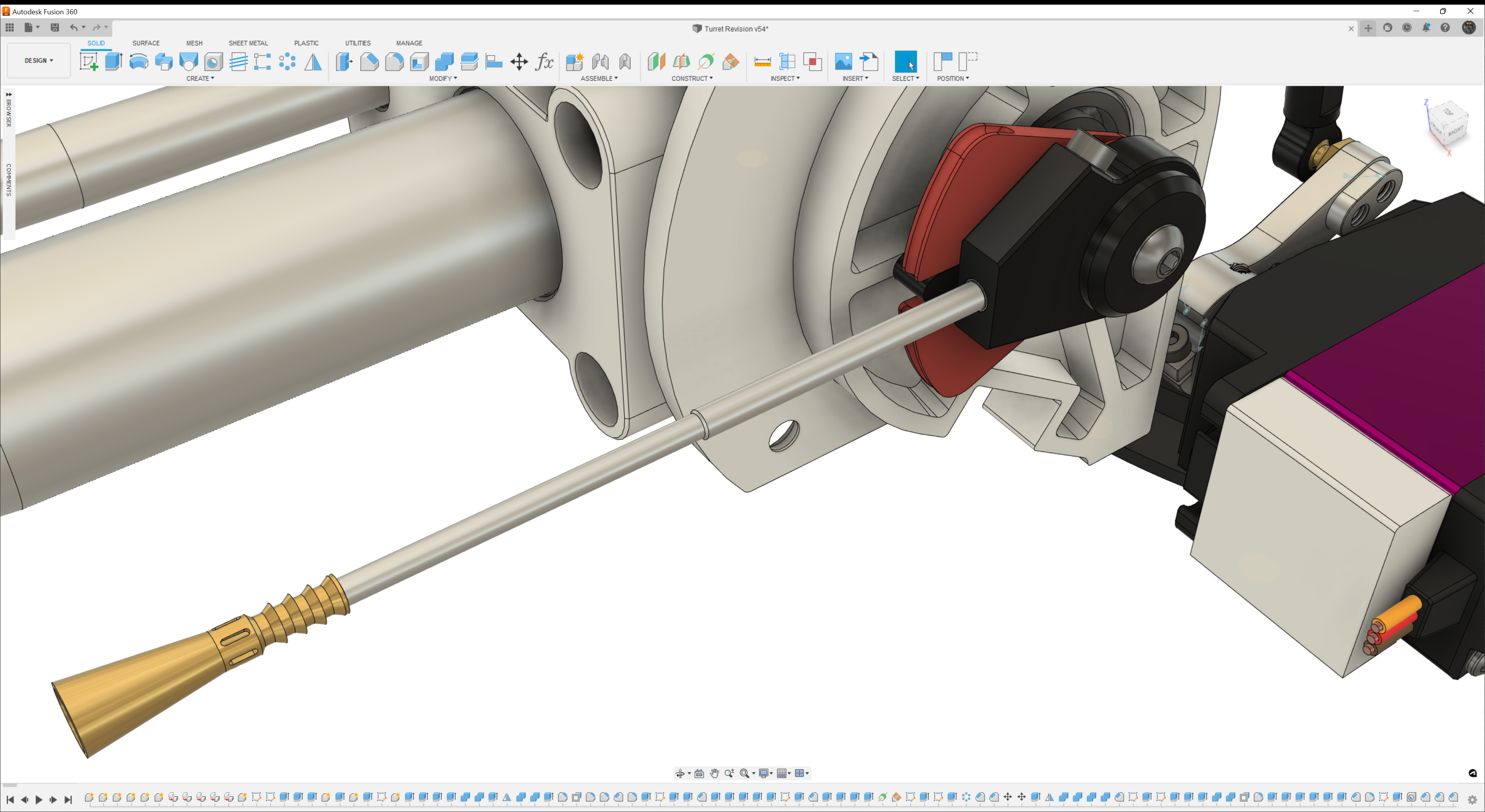

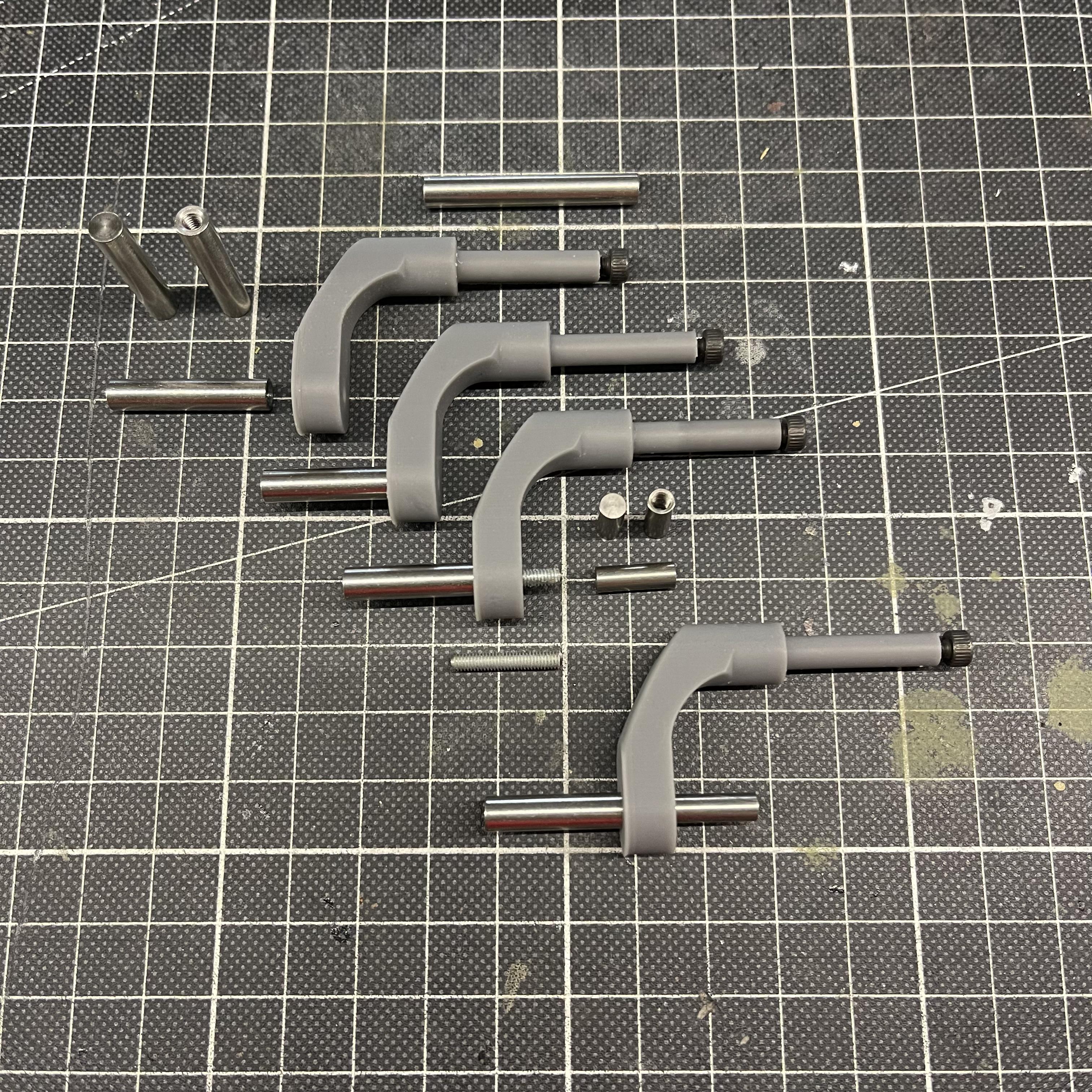

Still waiting for parts like the Dowel Pins to be used as Axles to arrive from AliExpress and while reviewing the order of operations for the weathering while watching some Night Shift YouTube Videos I noticed I'm missing one of the components my local modelling shop didn't have in stock either so I'm kinda stuck waiting for things to arrive via mail.
Kinda bummed I grabbed a set of ABER Barrel Cleaning Rods plus Photo Etch Mounts meant for a King Tiger and gave it a shot - Didn't get far with the PE 😑
Attachment 2271969
In the end I modelled and 3d printed the Mount and Wingnuts because folding that **** together would lead to nowhere.
I was at least able to salvage the hinged Thread the Wingnut would thread onto the Flap it would close and the Pin it attaches to - Good enough 😏

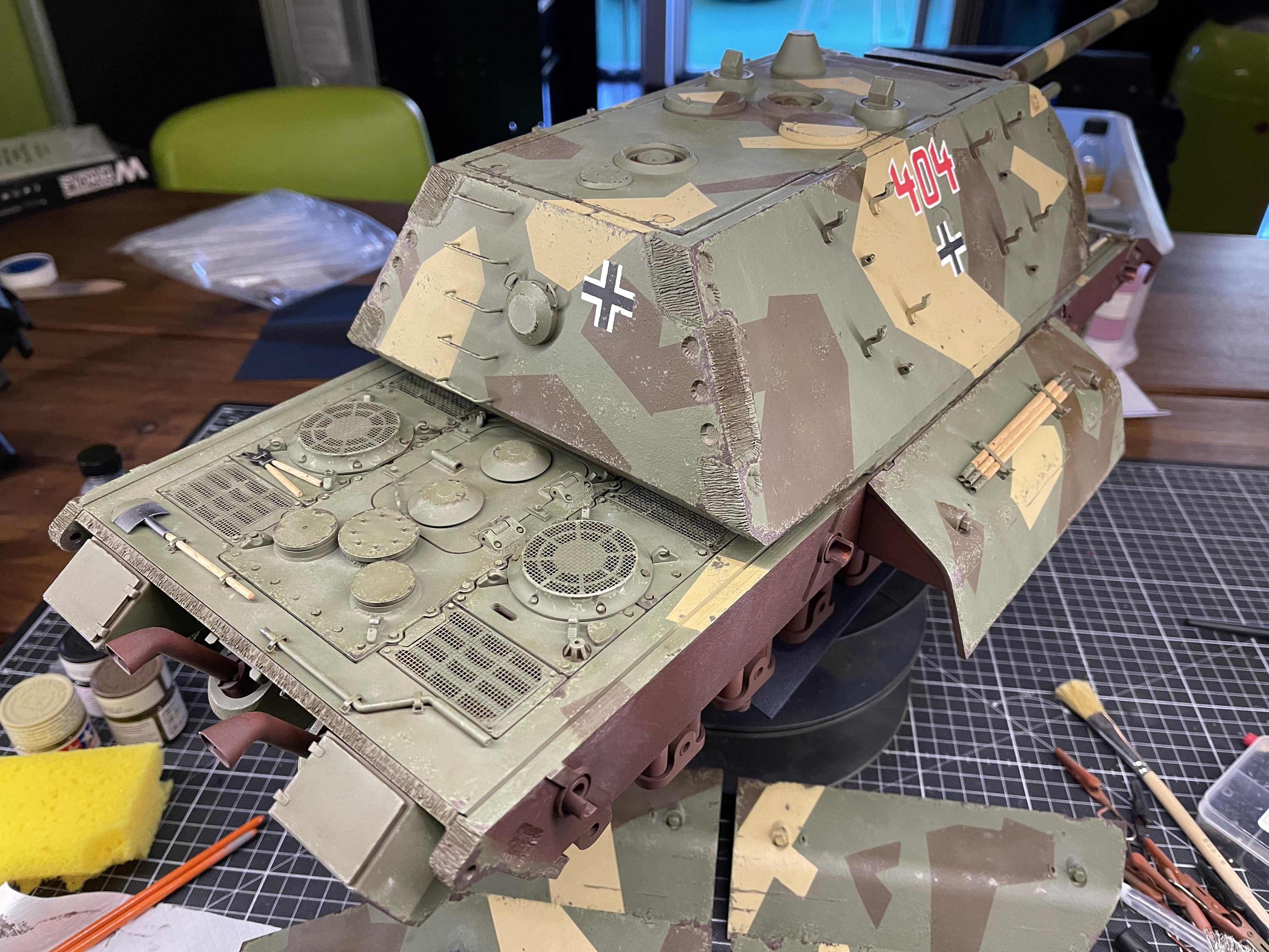

Durahl 07-08-2022 09:45 AM
2 Attachment(s)

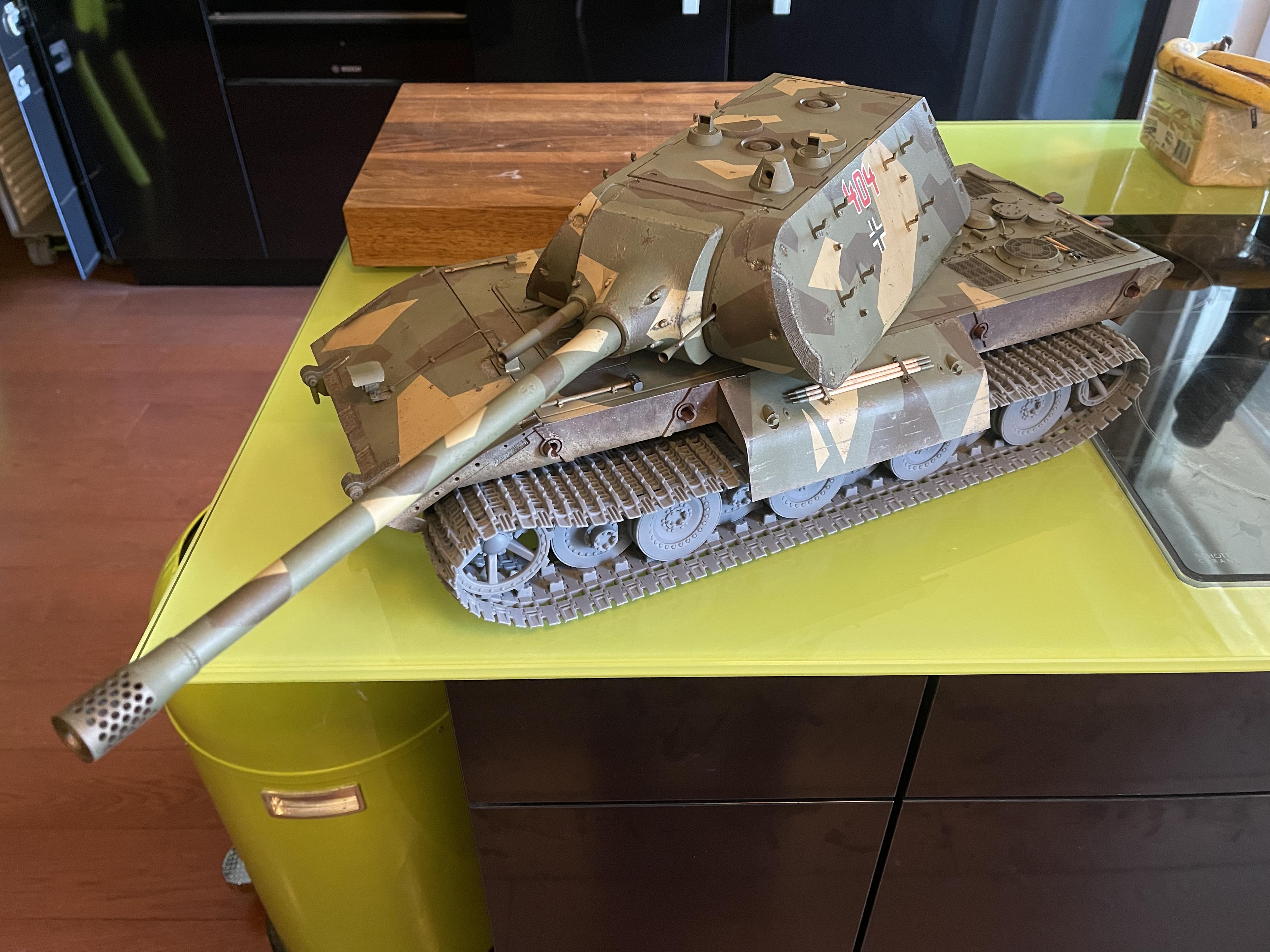

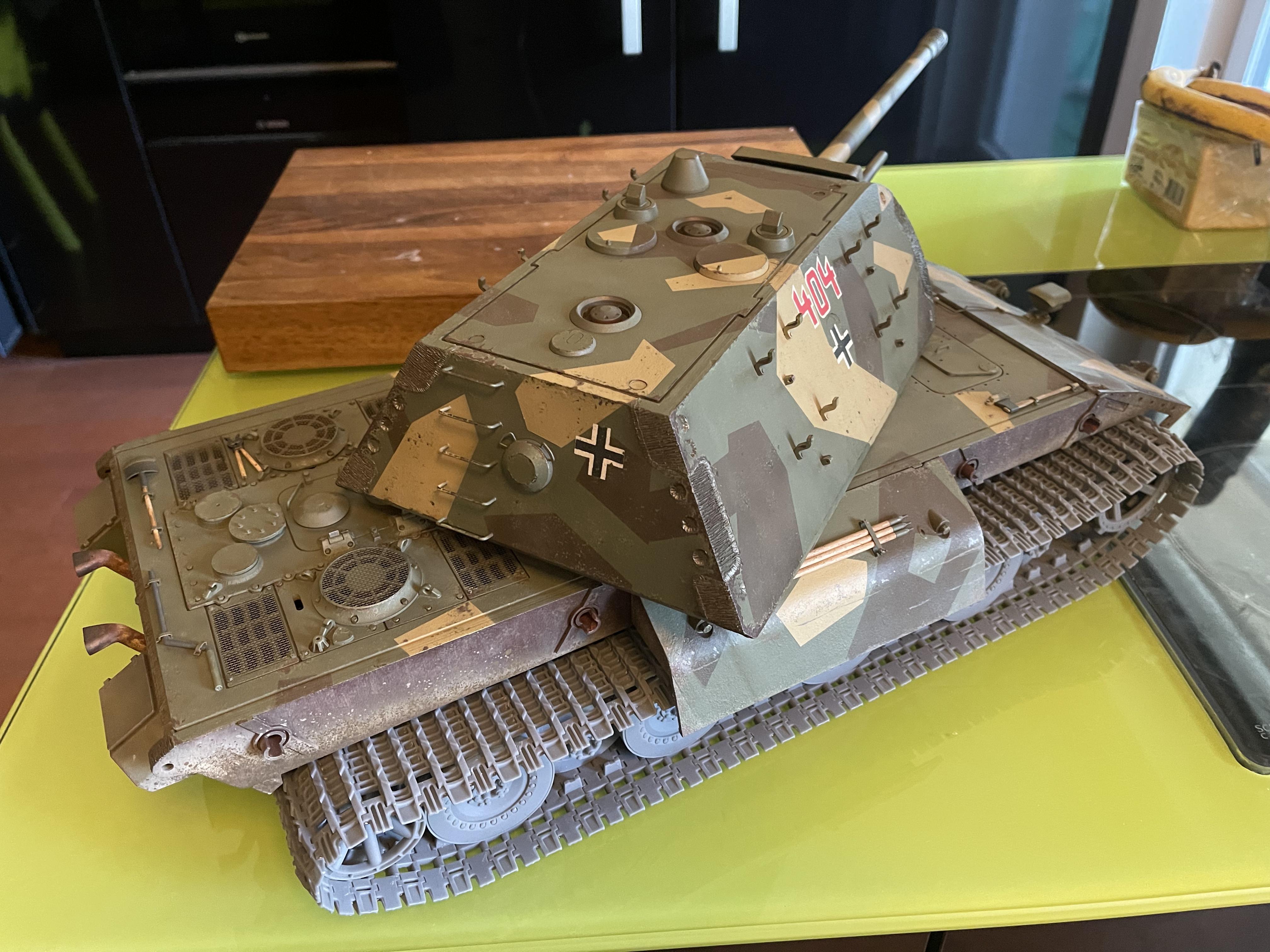

Two days of weathering including Oil Washes / Dot Filtering and Acrylic Sponge / Brush Chipping...
Attachment 2271975
Attachment 2271976
Lucky me I'm super picky when it comes to either buying Tanks of that size or making my own, so doing that again will most likely not happen in quite a while 😑
Next thing will probably be adding some rust and grime effects...

https://cimg6.ibsrv.net/gimg/www.rcu...c6b1fb876e.jpg
Unfortunately, the use of SLA 3D Printed Swing Arms has proven to be insufficient for the not even final weight model as over the course of just a few days they've experienced material creep causing the wheels to be pushed outwards.
Casting them in Pewter will thus end up being a necessity for the model to be turned into a Full Option ready RC Model.
https://cimg7.ibsrv.net/gimg/www.rcu...a019ec6101.jpg
By the time this happens I may also be remaking the Wheels in a mix of SLA 3D Prints for the detailed Covers and either 3D Printed ASA or machined Aluminium for the structural Rims as the fully SLA 3D Printed ones have proven to be quite fragile along the Rim edge they ride on. Knowing this I've still decided to paint them so the model wouldn't remain with an unpainted Running Gear for the foreseeable time ( Tracks will receive their paint once the replacement Tracks Pins have arrived ).
https://cimg8.ibsrv.net/gimg/www.rcu...4d408a71be.jpg
Only after fully assembling the model have, I found out that the Drive Sprockets too are kinda wobbly too necessitating a different approach there as well which I expect will end up a mix of casting a slightly oversized Wheel followed by CNC machining it down to spec as a whole or just the areas interfacing with the Gearbox Axles and Tracks. Quite literally the only Running Gear component I'm super happy about how it turned out would be the Idler Wheels - They run perfectly round. Sigh... Many lessons were learned in the making of my first - and still unfinished - scratch build Project but improvements can be made. Just not right now 😁
https://cimg0.ibsrv.net/gimg/www.rcu...821e1ae1ca.jpg
How the Towing Cables are being routed when the Model has its full complement of Skirts attached to it. Similar to how I did it with the Wooden Block strapped to the rear the Wire Cutters ( or whatever those are ) too have received some hold-down Straps made out of the Photo Etch Framing the Engine Deck Grilles resided in.
So, yea... Other than getting my hands on another one of the super sexy flexible Antennas from DKLMRC there's nothing much to add to the model for aesthetic reasons 🤔
The next most likely Update may either be one on the painting of the Tracks or the addition of working Springs but either of them are going to take their time 😁
