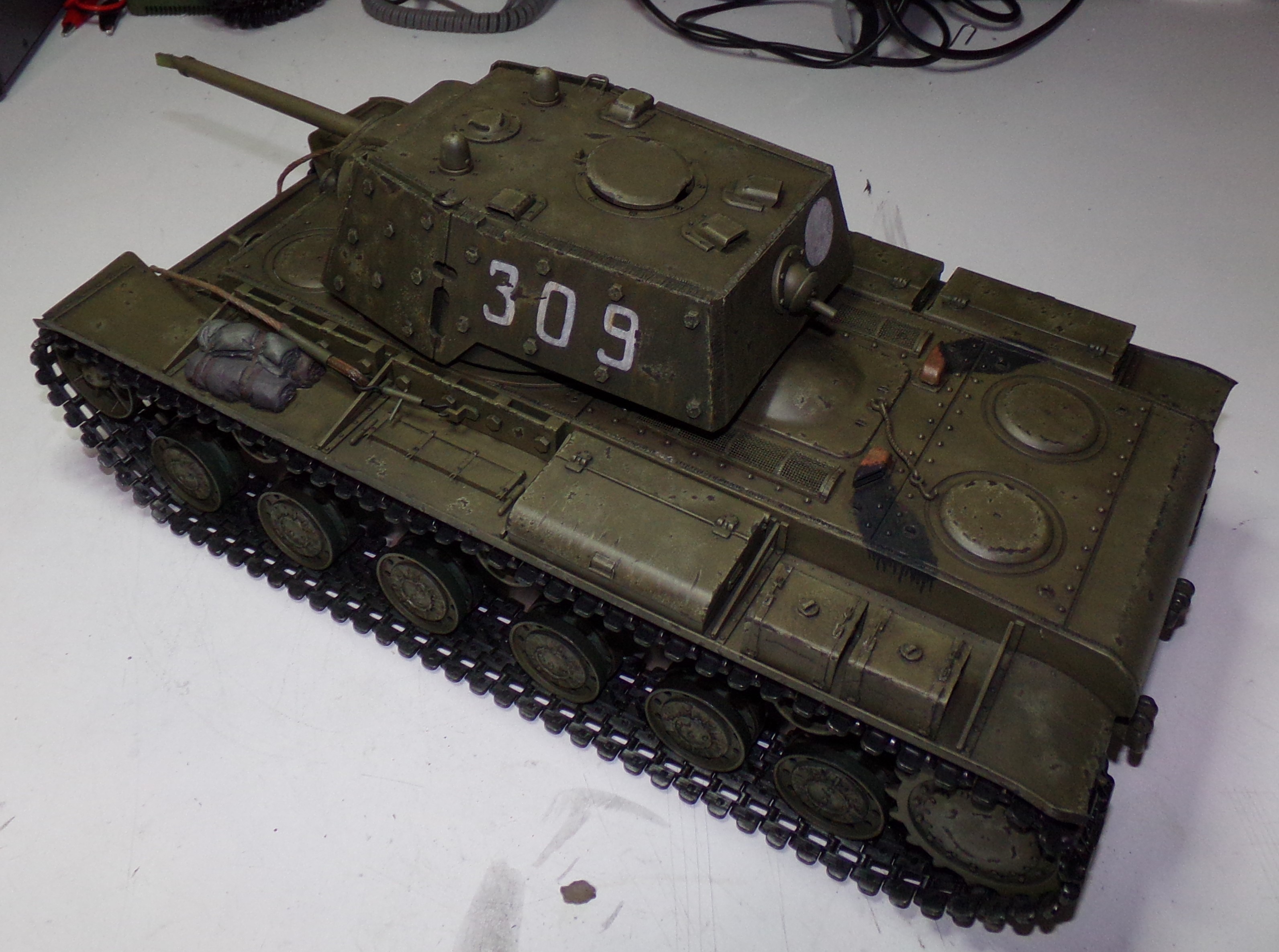

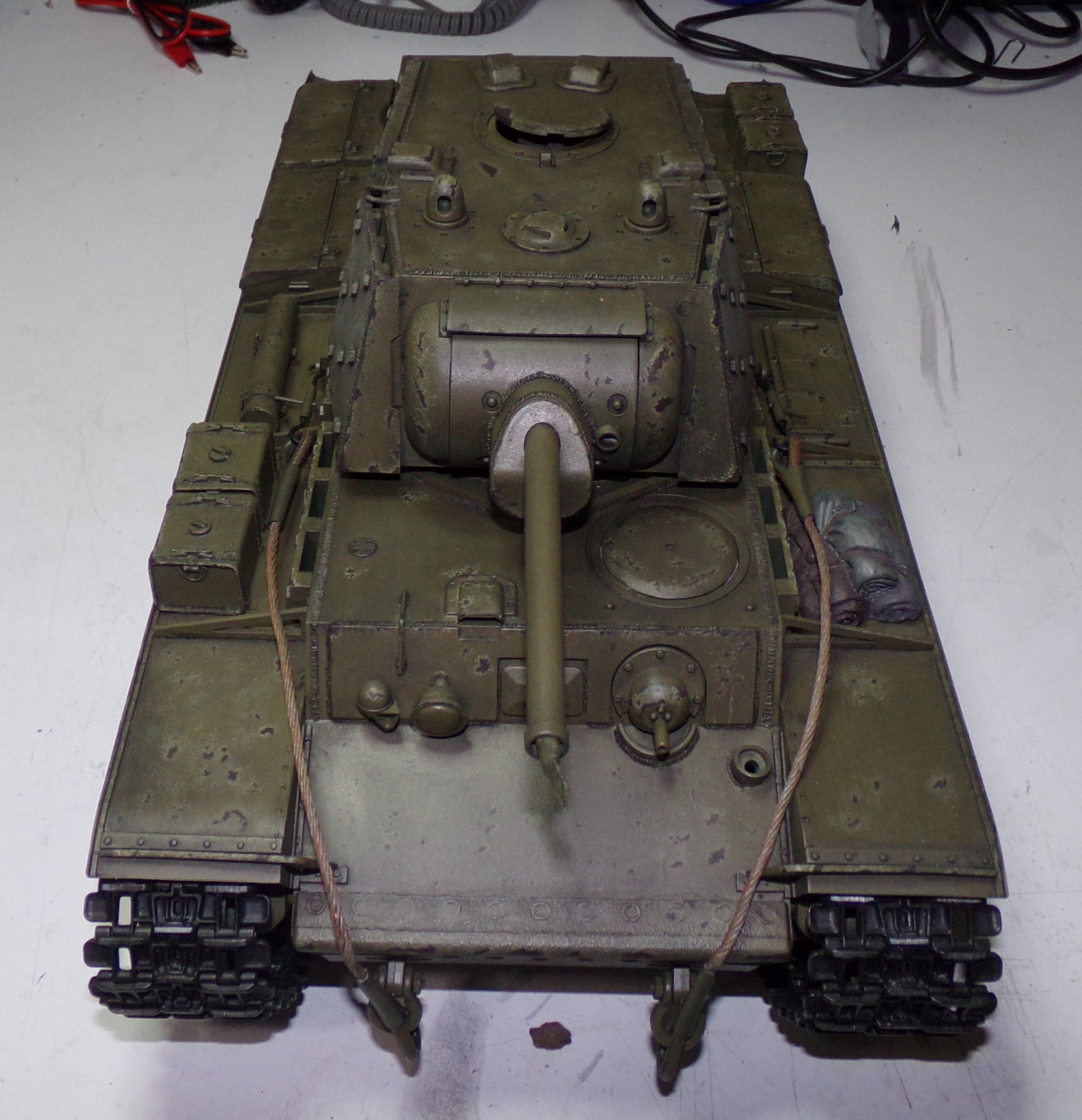

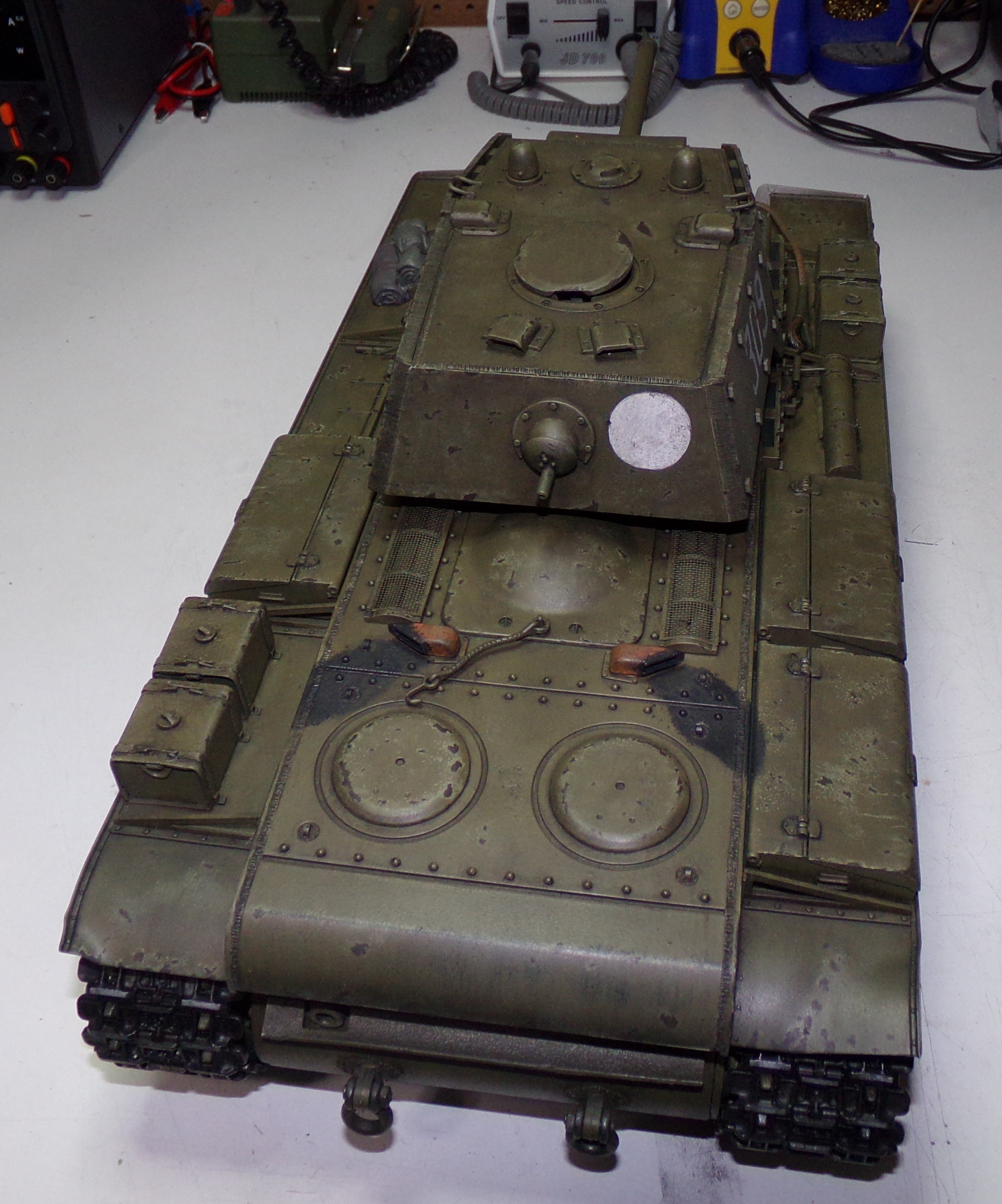

Decided that I was just going to use the decal sheets as a guide and paint the markings on. I scanned them on the printer and cut out some templates to lay down the markings. Afterward I removed the masks and hand painted them a little darker. The markings are based on a real KV-1E photo. I also decided to try my hand at some chipping effects. I've never done this before so I think it came out OK. I still have a lot to do and weathering effects to add after the chips are done.

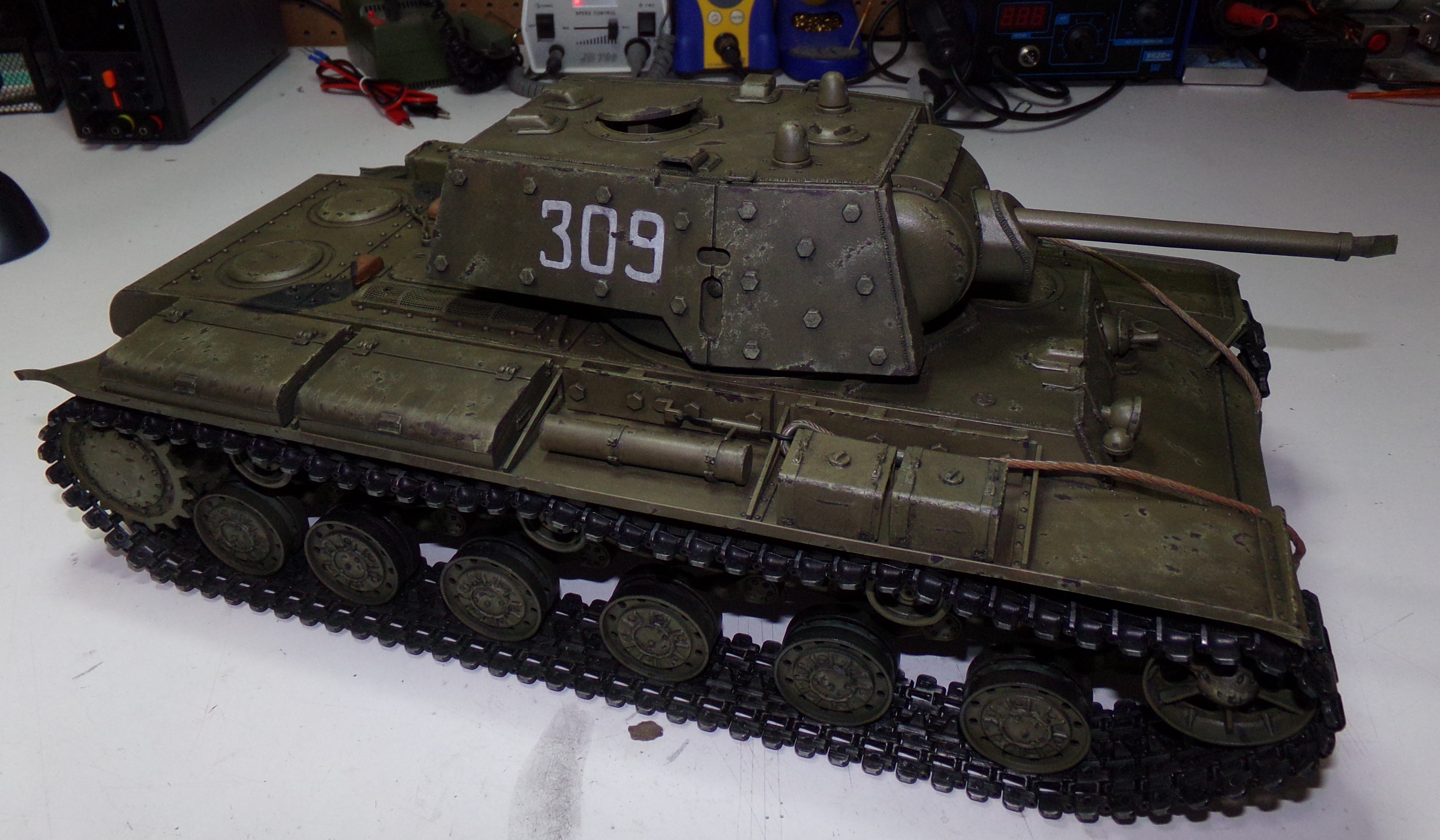

tankme 10-27-2022 02:07 AM
4 Attachment(s)
So I may have gone a little overboard on the chipping...it was a learning process. I tried to make it look like soldiers were sliding off the tool boxes after riding into battle. Overall I'm not completely dissatisfied with the outcome.
There are some dust effects I have to add yet, but waiting on some pigments to arrive to do that. The paint still needs to be sealed with a dull coat after that.

Looks good and I like the chipping effect. Can you please explain the technique that you used to get that? I have that SAS Jeep that's going to need a lot of chips so I'm exploring all the different ways of making that happen. You got good results so I would really like to know exactly how you did that.

Thanks. Found Night Shift's vids on YouTube and applied some of his techniques to do the chipping. The lighter chips (lighter green than the base coat) are done with a sponge for randomness and then the darker centers are added to the lighter chips. I think I used a rusty looking brown color for the bigger chips (simulation of the ones that go all the way through the paint).
