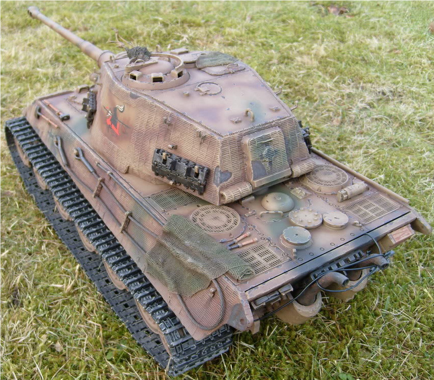

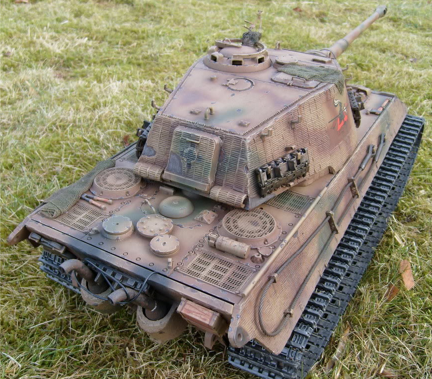

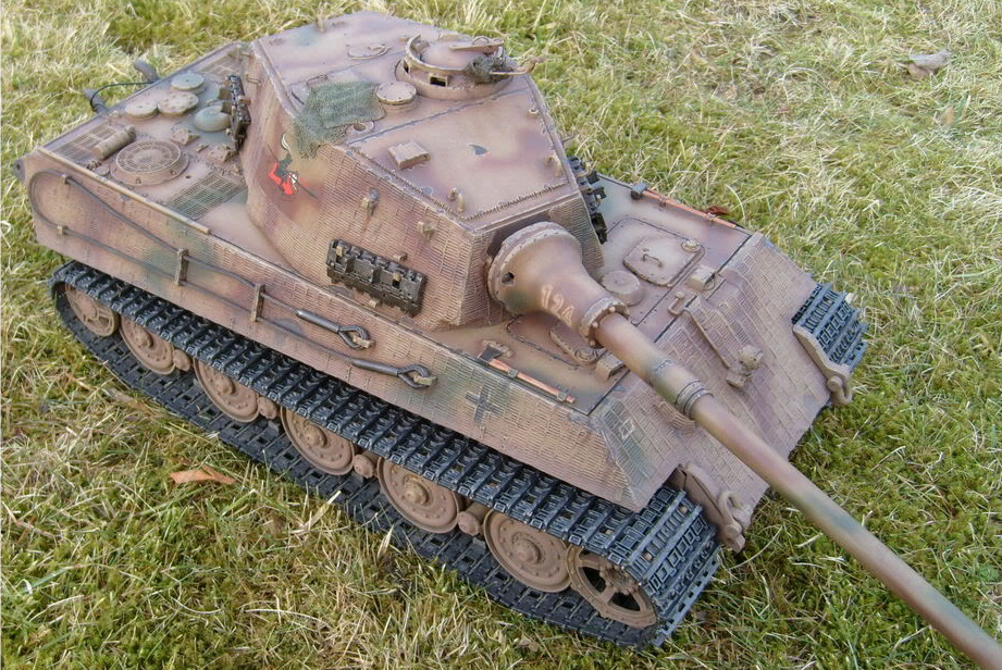

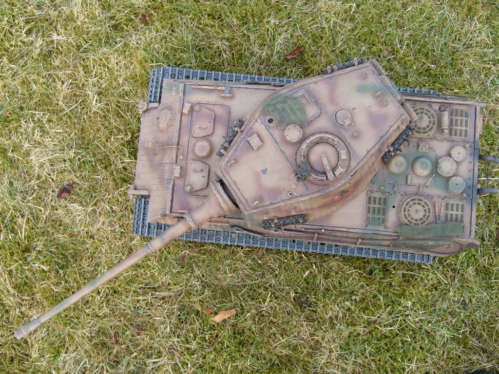

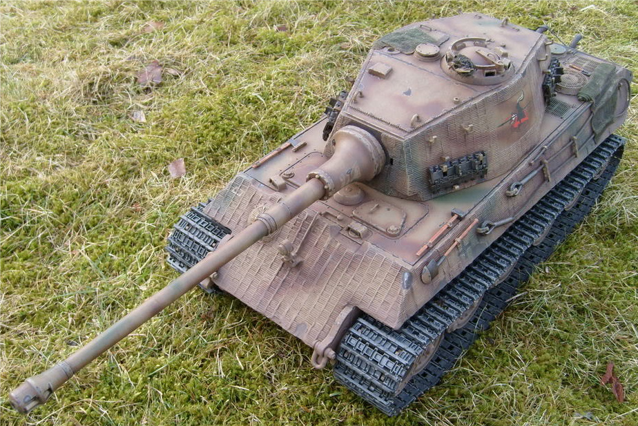

Another Toy! Some time ago I died and went to tank heaven.
Attachment 2238737
Attachment 2238738
Attachment 2238739
Attachment 2238740
Attachment 2238741

cracking job on the zimmerit!!!

Excellent work on that s.pz.abt. 505 Tiger! What is that cord on the back of the hull?

Is that the Zimmerit which is supplied with the kit, or did you make it yourself?
RSEA 02-06-2009 03:37 PM
RE: Royal Tiger
Also, are those the stock plastic tracks?
Alan123 02-06-2009 03:40 PM
RE: Royal Tiger
Apoxie 2 part Zimmerit and plastic fantastic tracks.
AL
RSEA 02-06-2009 04:00 PM
RE: Royal Tiger
Do not quite understand what you mean by "Apoxie 2 part Zimmerit". The Tamiya kit is supposed to include some sort of zimmerit panels that I assume are glued to the hull. I've not seen the kit supplied zimmerit so I have no idea what it looks like.

The Tamiya stick on zimmerit looks like this: (click on the photos to make them bigger)
http://www.rc-panzerketten-forum.com...threadid=15349
It is ok however I found that it tended to start peeling off at the edges on high wear areas.
Google the word Apoxie Sculpt for info on the 2 part expoxy resin that I used for the zimmerit. It is similar to the real thing, you smooth it on, press a stamp (with Zimmerit pattern) into it and then it sets rock hard and permanent. It is the only way to go. Takes ages to do and is best done over several days so you do not muck up the bit you have just done while working on another bit.
