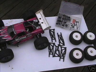

  #547
My Feedback: (12)
Joined: Mar 2005
Posts: 990
From: appleton, WI
Default RE: Official HPI Hellfire Thread
look what i got on e bay for 300.00!!!
Old 07-10-2006 | 11:26 AM
  #548
wmff82's Avatar
Joined: Jan 2006
Posts: 215
From: Marion, AR
I know a guy that is selling one that is BRAND NEW!!!Never driven,never even had fuel in the tank. it still has the sticker accross the engine head. The only thing is doesnt have is the electronics. I think it has the servo's though just not radio or rx. He is wanting 350 for it!!!!!!!!!!!
You better watch the STR.. it is having some pretty bad problems too,but is atleast winning races.
