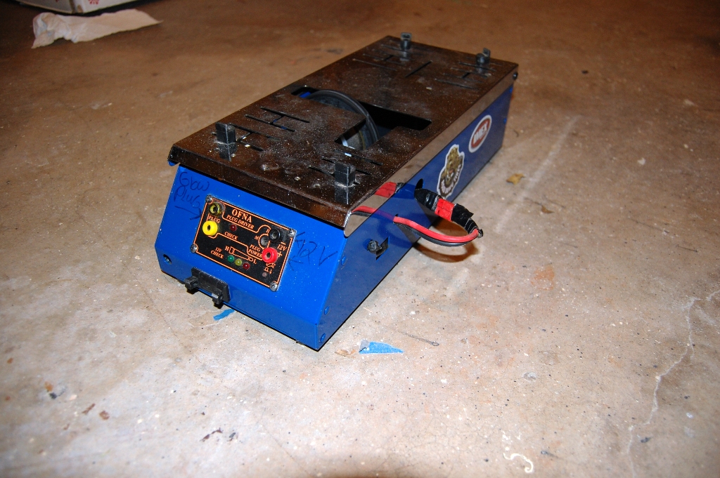

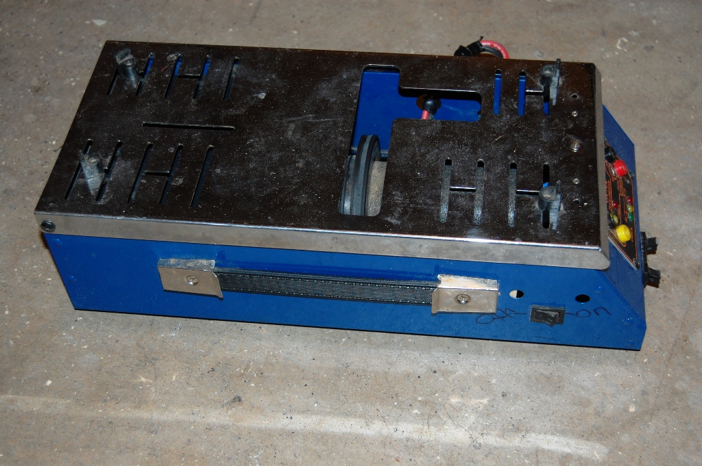

I bought an used Hellfire a few weeks ago, but the roto start is a mess. It is impossible to get my Hellfire started.
Have you seen this box before? What is it?
The roto start (motor) is broken.
Battery almost dead.
What can be done to repair it.
Should I buy a new one? If so where?
Can I get a used?
Links and advice would be helpful.
Can I get a used?

that is an ofna chrome top starter box. that is a great box. i use one but i am now upgrading to the ofna blue box.
and to the answer about you rotostart it should still be fine. we had an duratrax raze st and the roto start broke and we just used a bump box like that one and just ran it but i would see if you can find a back plate because you will have more power.

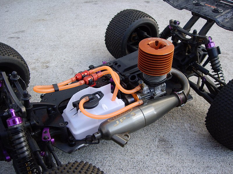

Anyway, here is the engine:
I see alot of videos where people use a "drill roto start" on Youtube, not the box. Can it be used on the Hellfire?

thats a nice looking truggy u have there. i think u should get a new battery for your box and u will be fine. that box is a starter / bump box not a roto start. there should be a screw on the top plate of that box. when u find it just take it out and u should be able to open the box. and u will see the battery in there. either order that battery onlien or go to the local hobby shop and get a new one OR if that box has leads on the side u can hook it up to a car battery which is alot better IMO. hope i helped a lil bit
