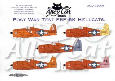

Hi Mirce,
There were a few brightly colored Hellcats including several which were overall yellow. I've posted pictures of some of the most colorful ones below. The Squadron Signal "Hellcat in Action" book also has a black & white photograph of an overall yellow Hellcat which is almost identical to the Wildcat I posted previously except that the Hellcat also has a black anti-glare panel forward of the windscreen. I don't know if any other documentation exists for that one other than that one b&w photo however.
A mostly yellow Hellcat Drone.
Overall red Hellcat drones and drone controllers. These came with lots of different colored tails.
Another all red drone Hellcat. This is how I am going to paint my 1/8 scale Hellcat.
Target towing Hellcat.
Sorry to Flakbait for hijacking his thread with Hellcat stuff!!!
