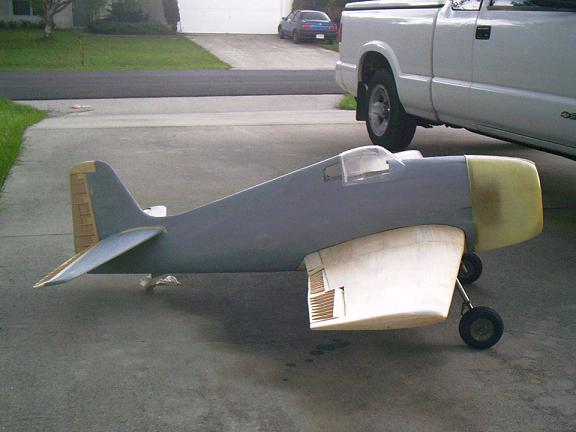

Hey guys,
Here is my Jerry Bates Hellcat. I have been working on this for some time. Just got the wings and fues glass and primed the fues. You know how you sand and sand all day and think you have it perfect till you apply the primer and find out you not even close. I used a different method to glass, sanded a little and shot the primer. I can't believe how well it turned out. Anyway, I'll post pictures online when I start the paint, panel detail, etc. I do have a few questionsl
1. the wheel covers on this plane... are there any fiberglass ones out there or do I have to make that from scratch?
2. I am going to cover the control surfaces in fabric, but was there stitching on the real one, if so does anyone have an documentation or know where I can find at least some close up shots of the stitching?
3. I know that there where some rivets on the front around the pilot and cowel. I can't seem to get a clear picture of the back. Anyone know how the alum. was applied to this plane?
Any other things anyone would like to post would be great. I would love to see pictures and hear stories of others who have built this plane.
Happy Flyen,
PJ

Picture 1
Old 08-04-2003 | 08:46 PM
My Feedback: (139)
Posts: 869
From: Lexington , KY
Default Just Another Bates Hellcat Project!!

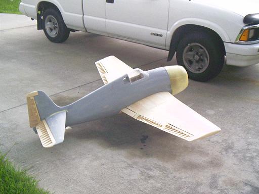

The gear is pushed forward a little. I'm not going to leave it that way, just havent gotten the blocks positioned right. (yeah...I know you scale buffs were looking..)

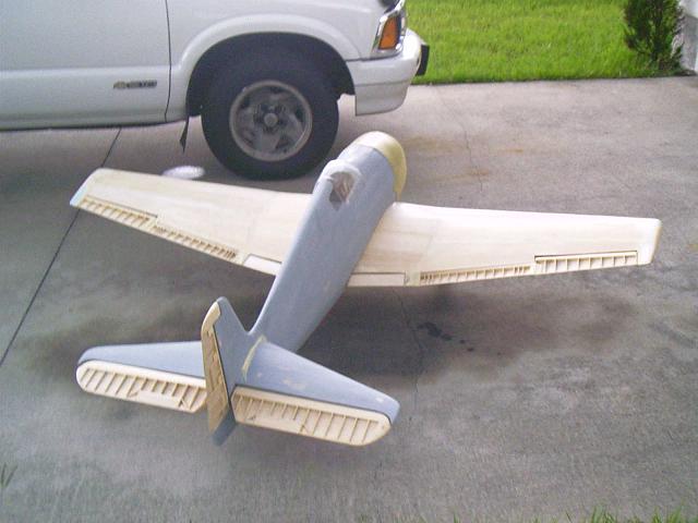

You get a clear shot of the trim tabs. I'm going to cut them out and fiberglass them as well. If you have any detail shots of those, that would be great.

I started building the Bates Hellcat at the end of last year. I am doing a construction post in the User Product Reviews section: www.rcuniverse.com/showthread.php?s=&threadid=363671&forumid=142. I have not worked on it in a while because I am building other planes for customers. I hope to get back to it in about a month. Anyway, to try and answer some of your questions:
I haven't found any after market gear doors. If you get a lead on some, let me know.
There was stitching. When I get home I will look through the pictures I have to see if I can find one that shows a close up.
From the cockpit forward there were dzus fasteners and the panel were butt joined. From the cockpit back the panels were overlapped and raised rivets were used. I will see if have any decent photos.
Hope this helps..

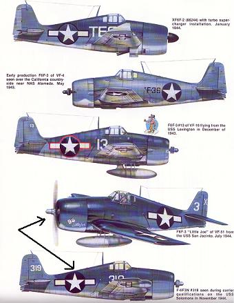

I'm going to go with something like the last two on the picture. I'm not sure exactly the airplane. I like to do some research so I know what I'm talking about at airshows. Keeping the memory alive is just as fun and importaint (I think) as building and flying.

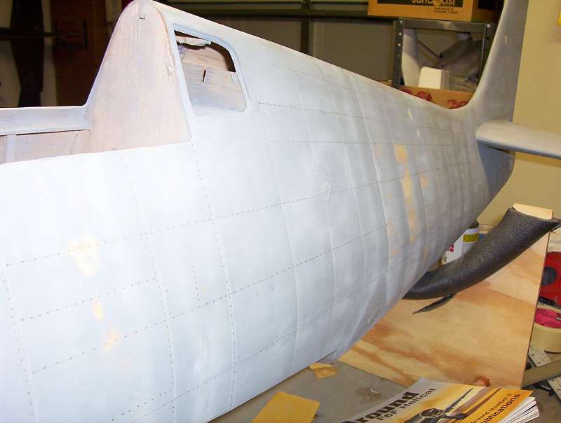

Here are a few pictures of the fues. I have sanded the thing till I can't sand no more. I decided to start the rivets and oh man are there many. My good friend Mike from the Lucky *******s said the plane was "dipped" in rivets and he was right. Many books/pictures/and online stuff later, I have the rivet plan down. I have only done one side and will be doing the other side soon. After that, I'm going to start on the panel lines on the wing. All my panel lines are raised in accordance with the books I have. I simply used the tape/spray/peel off method.

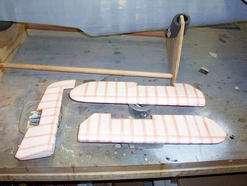

All I got to this weekend were the control surfaces for the Fues. They are fabric covered with Balsa USA's "Pink Tape". I will be primering the tape this week and do the stitching. I had to cut the jaged edges because the Hellcat had straight edges. That took a while! I will be glassing the trim tabs this week as well.
I have a paint question. I was going to use Testors Model Master paints for this project. Can you paint the silver under where you want it to show through, spray over it with the color of the plane, and then scuff the area? What I mean is, will the blue paint have a different shade around the areas that where painted silver? Has anyone used Model Master Paints on their planes? Is it fuel proof? It just seems the colors where right on with what scheme I want to do.
