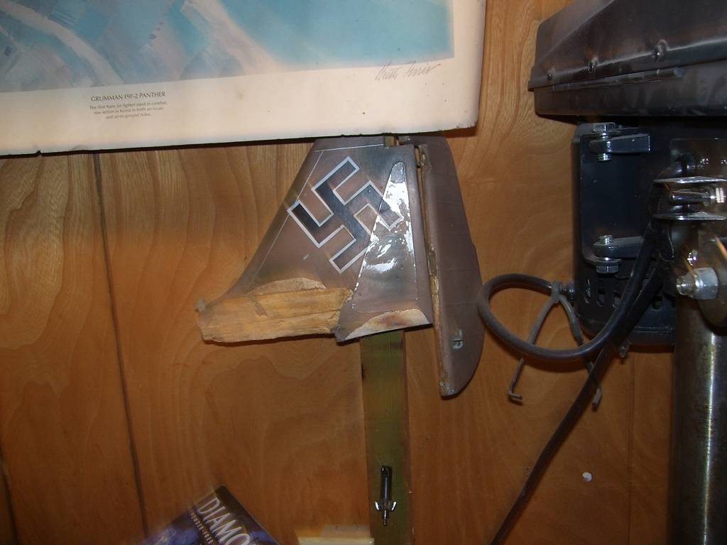

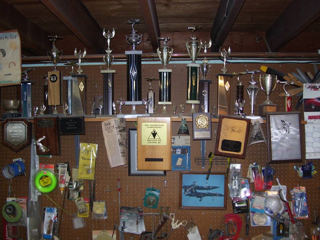

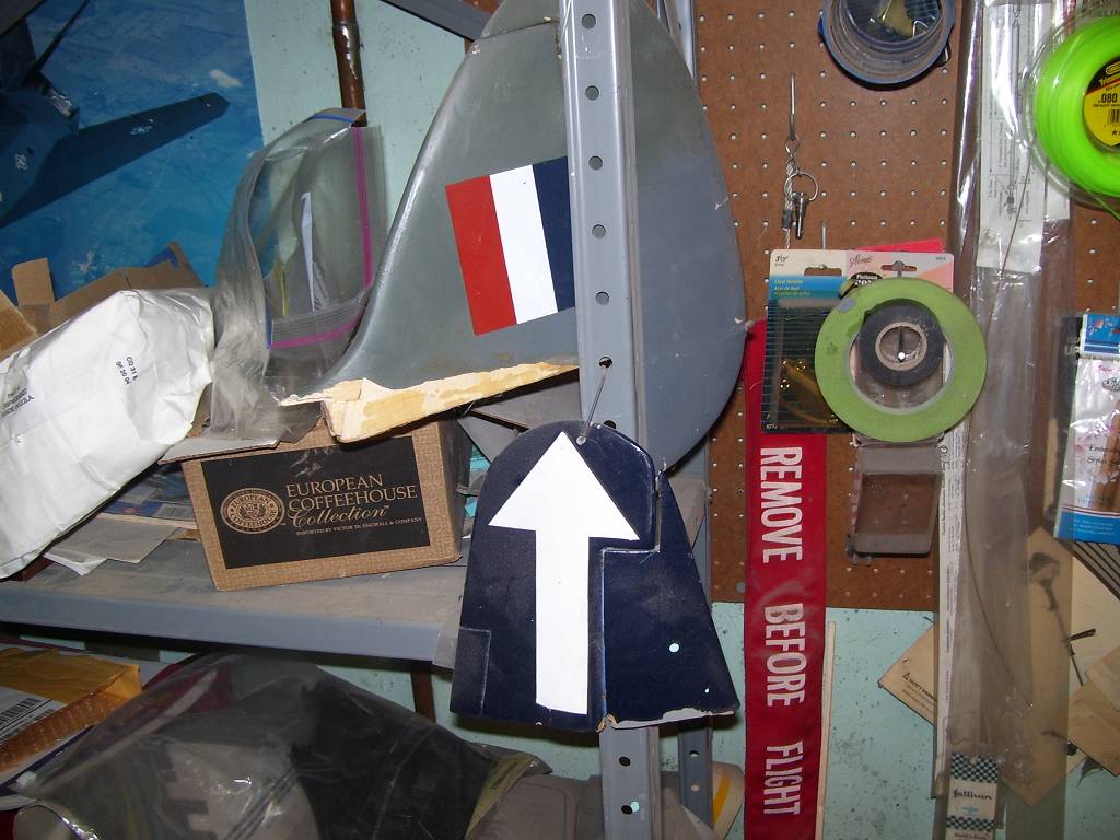

Hi Tony,
When I was learning how to fly warbirds , I was self taught. The only thing that survived my crashes were the fin and rudder. I used to hang them up in my workshop as a reminder. I had quite a collection. LOL That's how I know.
Were you reading my mind?? LOL Here are some samples. I did get better at it through the years.
Fred
