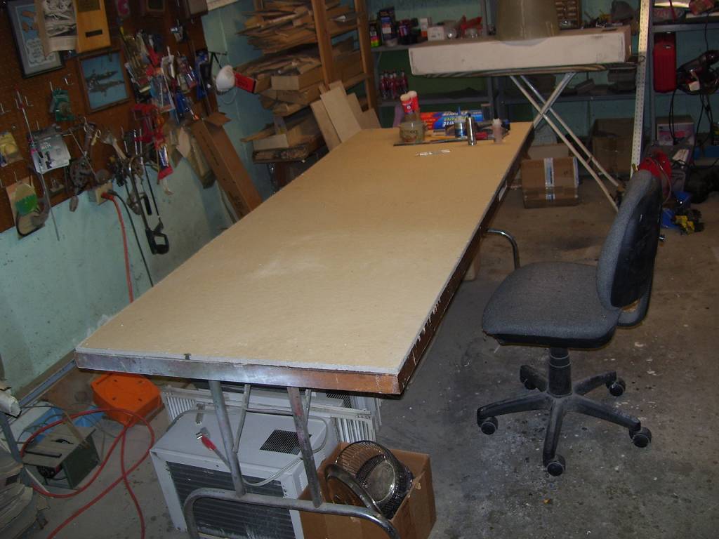

Default Another Ziroli Hellcat build!!

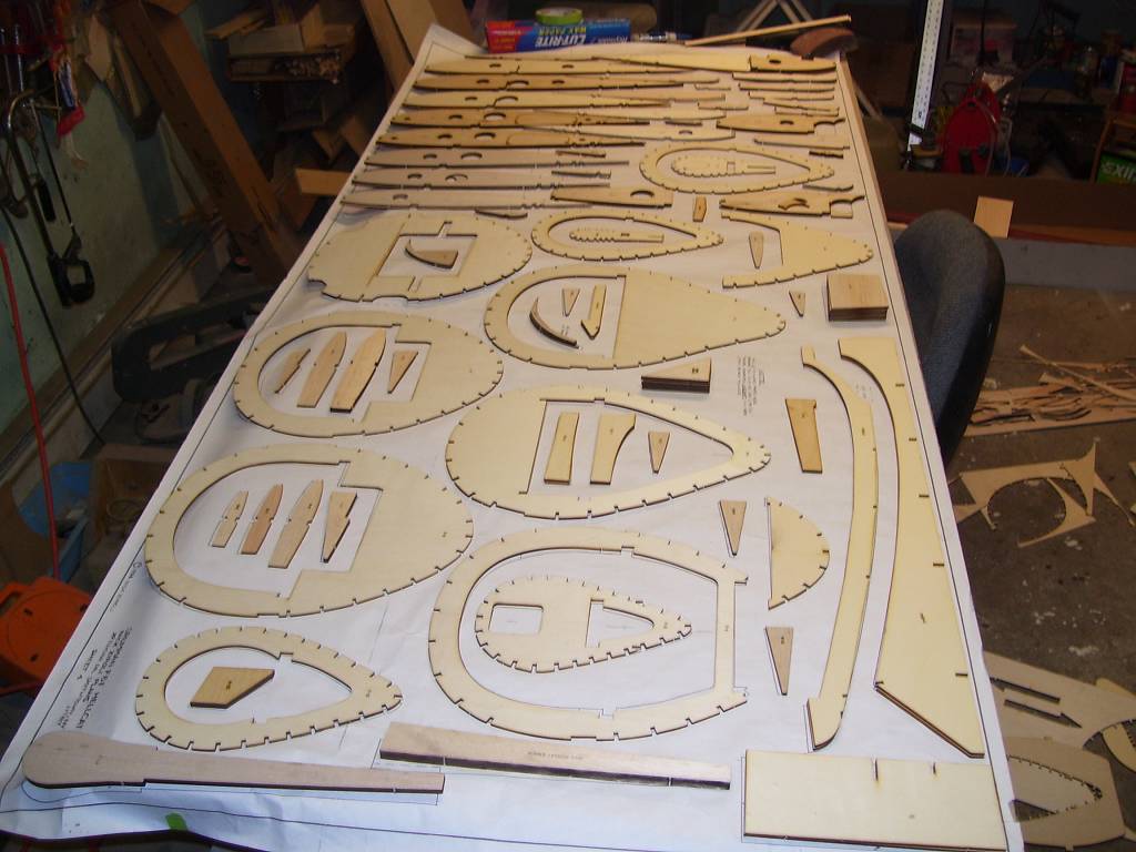

After trying to sell this kit on line without any success, I decided to just go ahead and build it. First pic is of the building room all cleaned and ready to go. Trust me, it won't look this clean once I get started. LOL I inventoried all the parts and found I have a few parts miscut. I will contact National Balsa and make them aware of this. Also missing all the strip wood for the fuse former notches. I have to say the lazer cutting is superb , very clean and the parts fell right out. Here we go, stay tuned and feel free to add your comments and recommendations as I go along. There are a couple of expert Hellcat builders on this site. Sam Parfitt and Mirce to name a couple. I'm sure I missed some others and I apologize for the oversite.

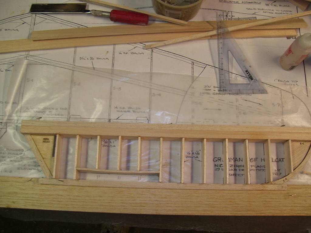

Hi Steve,
Just checked out your build , it looks great!!
I just started framing the stab. I'm missing all the stringers for my fuse build so I'm working around it until I get them.

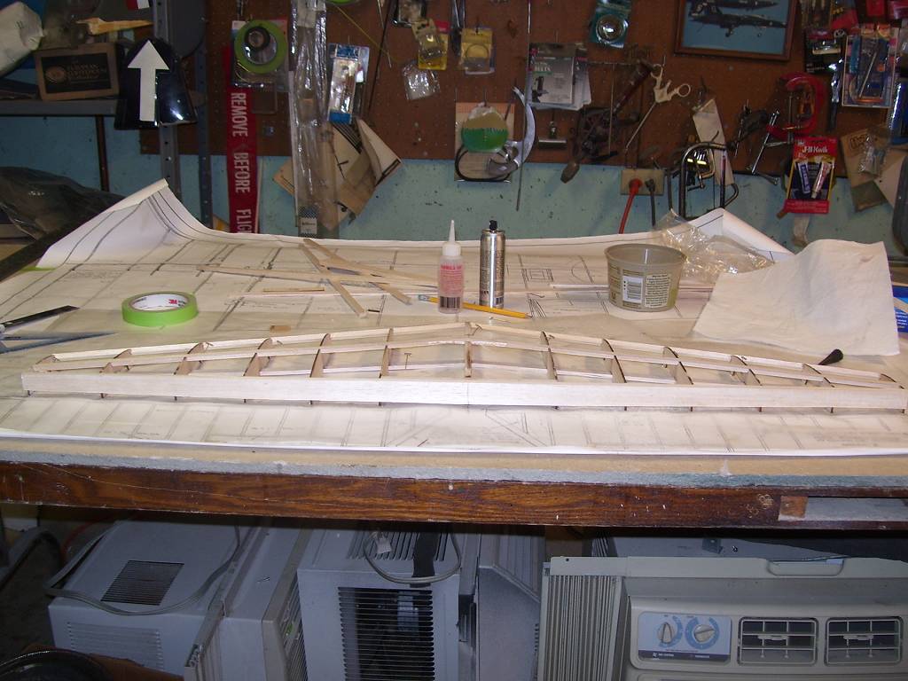

Old 12-28-2012 | 03:42 PM
My Feedback: (427)
Posts: 1,971
Received 6 Likes on 5 Posts
From: N. Scituate, RI
Default RE: Another Ziroli Hellcat build!!
OK I have the stab framed and sheeted, Elevators next.

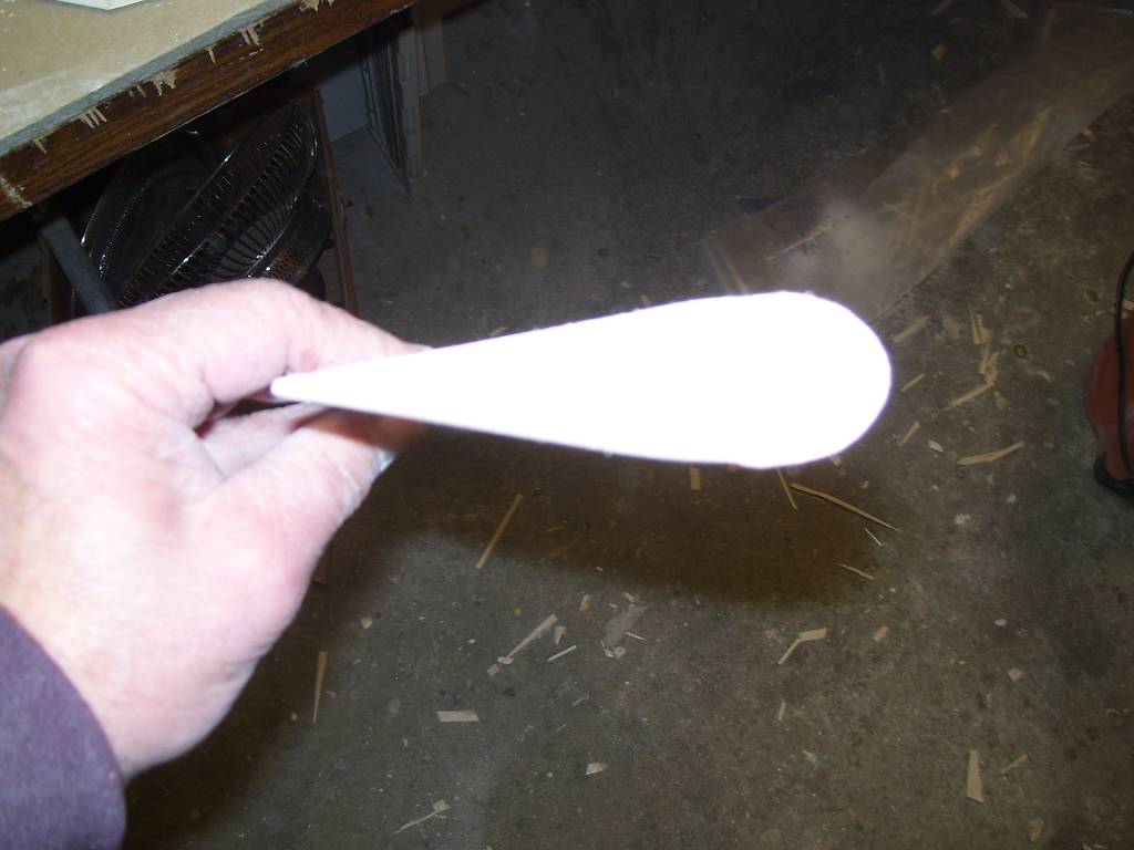

Completed one of the elevators. I departed from the plans by adding another 1/2 in. to the inside of the leading edge. I did this to bring the hinge pivot 3/8 of in. inside the leading edge. I will be using the large Robart hinge points. This allows me to make a nice radius instead of a V hinge at the LE. Also gives a more scale look to the leading edge while adding stiffnes.
ID:	1834382   Click image for larger version
Old 12-29-2012 | 09:08 AM
My Feedback: (427)
Posts: 1,971

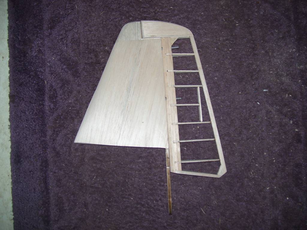

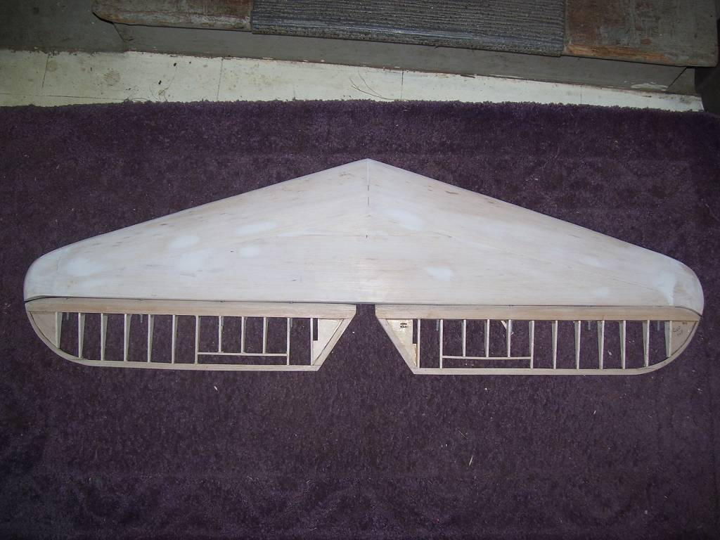

OK the elevators are rough out. The radius is a lot better on the leading edge as well as the recessed hinge joint
Will start on the fin and rudder next.

Old 12-29-2012 | 03:46 PM
tailskid's Avatar
My Feedback: (34)
Joined: Nov 2001
Posts: 9,554
Received 7 Likes on 7 Posts
From: Mobile, AL
subscribed....
Old 12-30-2012 | 12:32 AM
Joined: Feb 2007
Posts: 1,548
Received 63 Likes on 30 Posts
From: Senta, Serbia
Fred, on my first Hellcat I cover rudder and elevators with Oratex and paint it. After some time on those parts I saw some small cracks and on one - two edges oratex start to flipping out.
On next F6F (yellow) I cover those parts with 0,8 mm balsa, and made details with filler. First, construction is much stronger, no more worry about flipping out, and cracks, all in all, I think that is much better solution.
http://www.rcuniverse.com/forum/m_37...25/key_/tm.htm
Think about that...
Regards
Mirce

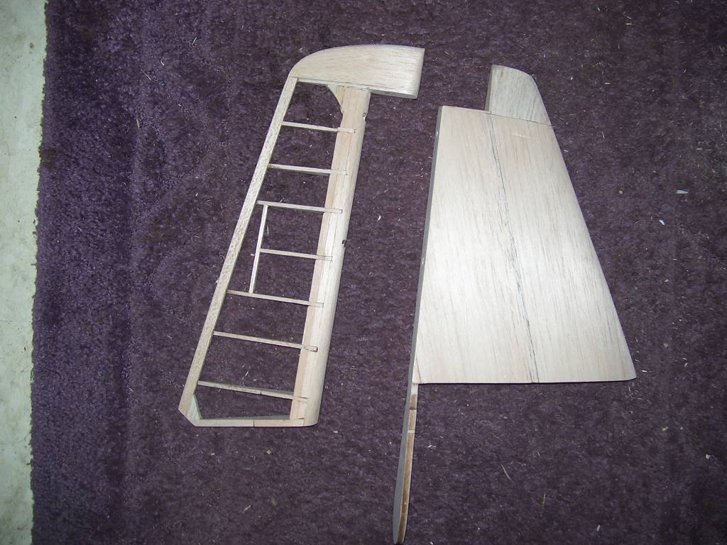

Old 12-30-2012 | 10:48 AM
My Feedback: (427)
Posts: 1,971
Hi Mirce,
Yes I saw your fix. I'm still going to cover the surfaces with Solartex. This fabric really covers well and stays tight and give it the scale fabric look. Although I must say your detail set you sell looks fantastic. I will be ordering a set for mine.

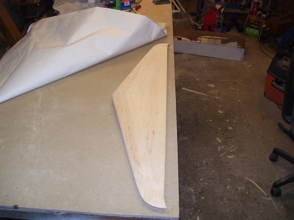

Just finished roughing out the fin and rudder. I guess I'll start making the fuse crutch. I have to order the stringers they were omitted from my kit

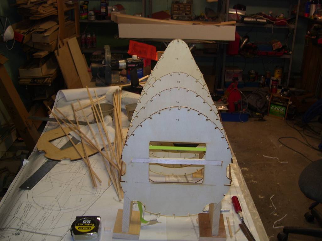

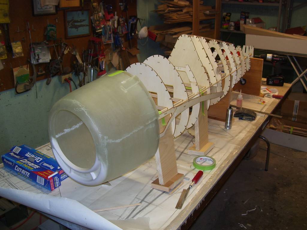

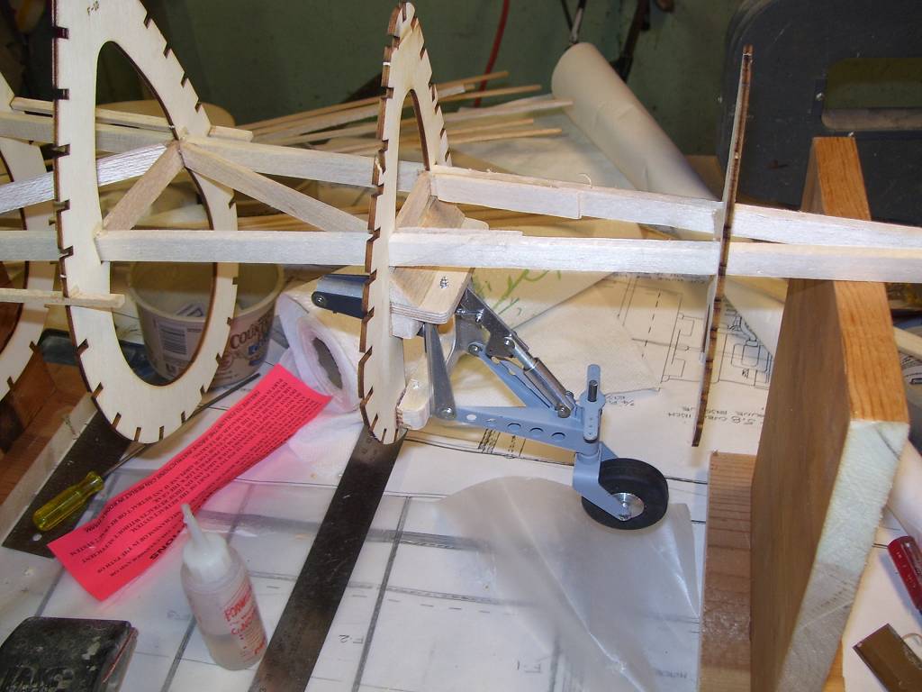

Old 01-04-2013 | 02:16 PM
My Feedback: (427)
Posts: 1,971

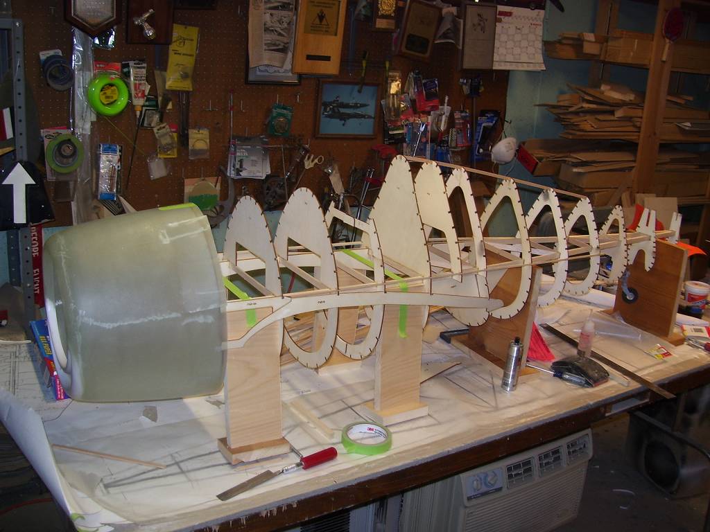

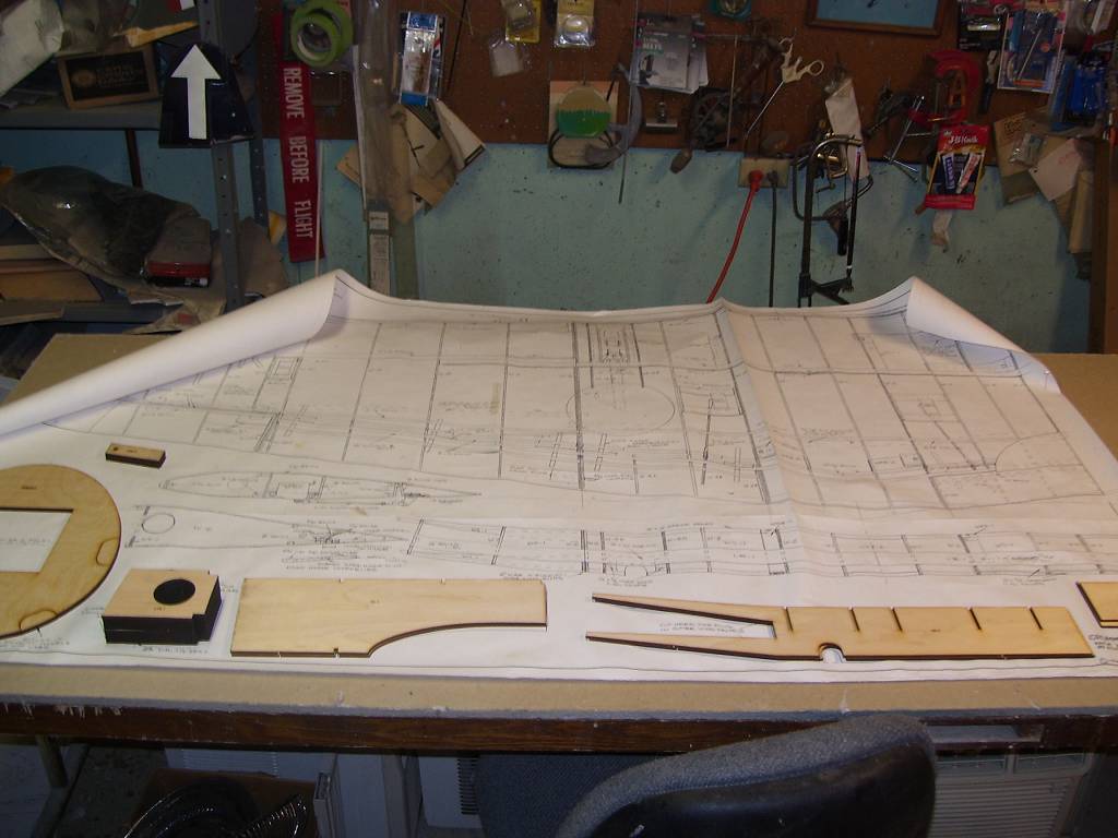

Ok I have most of the fuse formers glued to the crutch. Last 3 are still floating since I was installing the tailwheel retract. Also taped the cowl on as an incentive to finish the fuse. LOL I have to order the fuse stringers since they were omitted from the kit. I'll be starting on the wing while I wait for the parts to come in.

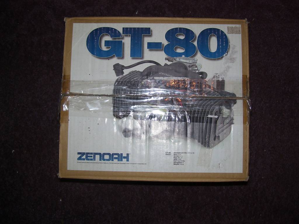

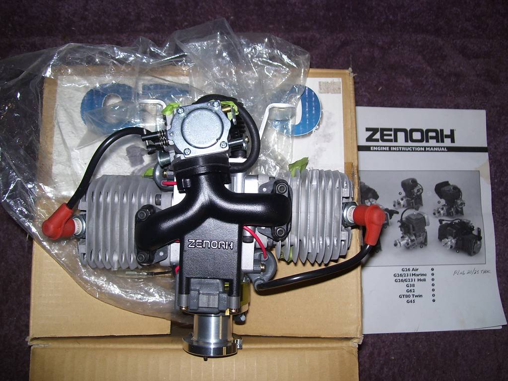

What are you going to power this baby with?
Old 01-04-2013 | 07:07 PM
My Feedback: (427)
Posts: 1,971
Thanks Mark, would have loved to have done a deal with you.
Here you go Jerry.
ID:	1836858   Click image for larger version

My son had one of those about 4-5 years ago and LOVED it....very reliable......so Good Choice!
Old 01-05-2013 | 01:54 AM
Joined: Feb 2007
Posts: 1,548
From: Senta, Serbia
Take care about weight.
If model is more than 20 kg GT 80 will not be enough. Other thing, that engine will deliver more and more power with every next gallon of gasoline...
Regards
Mirce

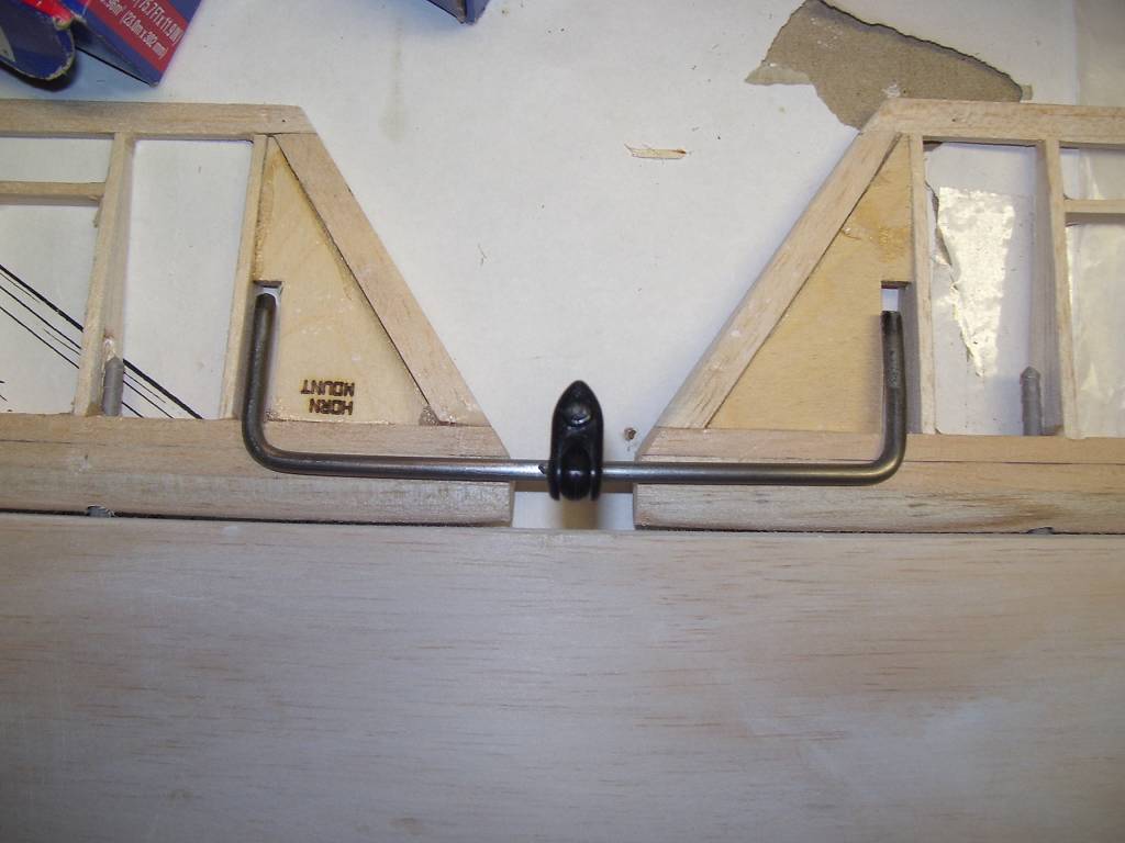

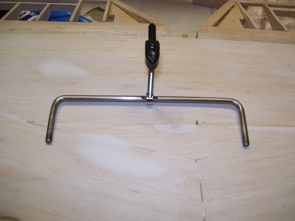

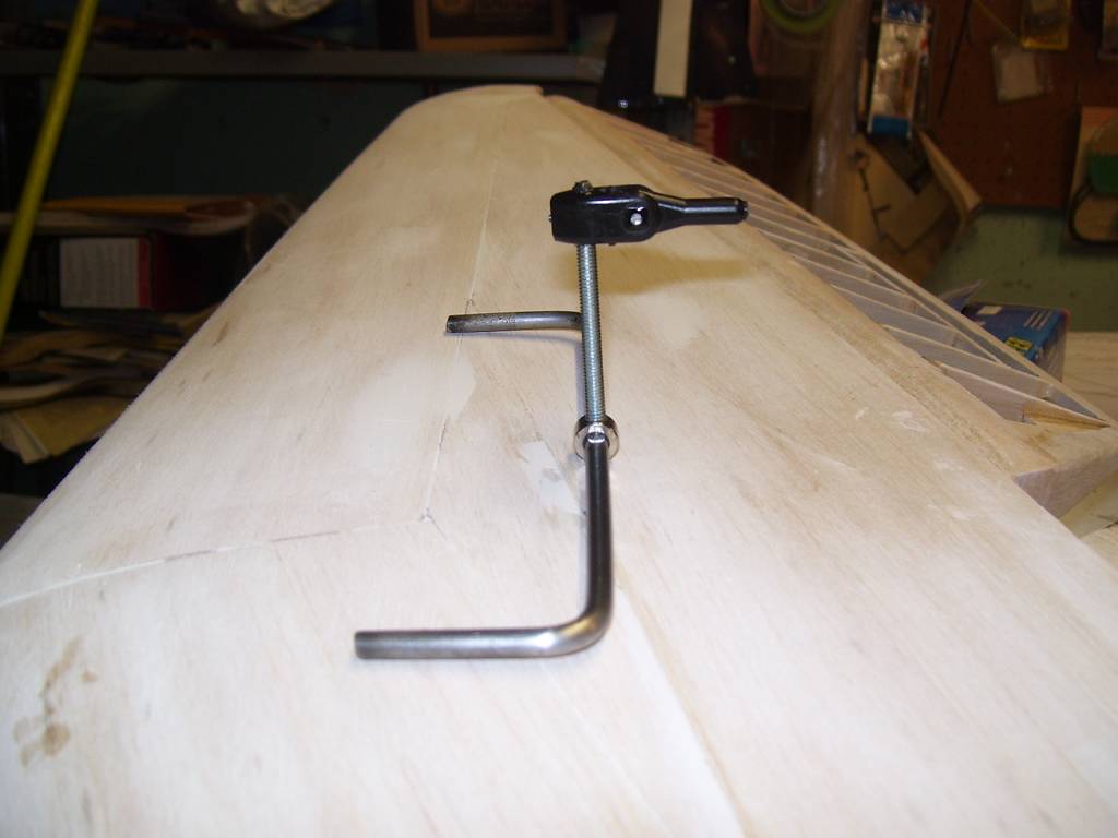

Old 01-05-2013 | 09:49 AM
My Feedback: (427)
Posts: 1,971
Hi Mirce,

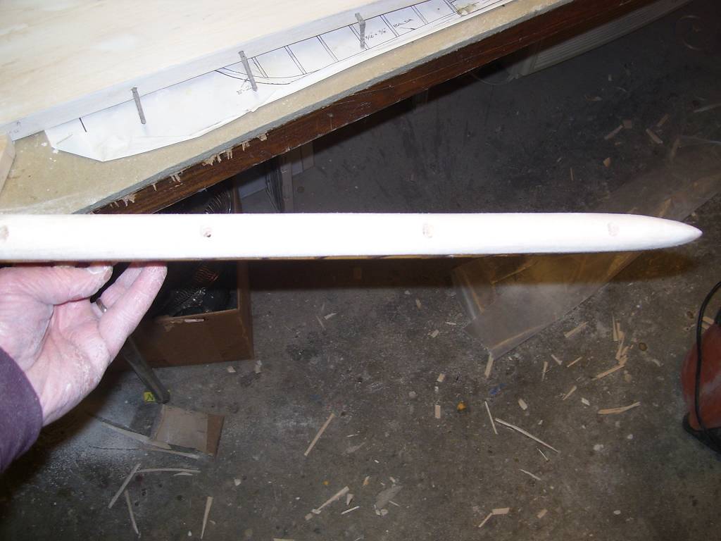

Hope I can keep it under 44 lbs. Just made up the elevator joiner wire. I don't like to use 2 servos for the elevator. Using one with a 3/16 in. joiner wire with an 8 /32 hardened bolt threaded into a 3/16 wheel collar. I grind a flat and then loctite on the bolt thread. Tighten it down and your good to go. Have used this method on over 40 large scale Warbirds without a problem
ID:	1837020   Click image for larger version
ID:	1837021   Click image for larger version
Old 01-05-2013 | 12:43 PM
My Feedback: (427)
Posts: 1,971

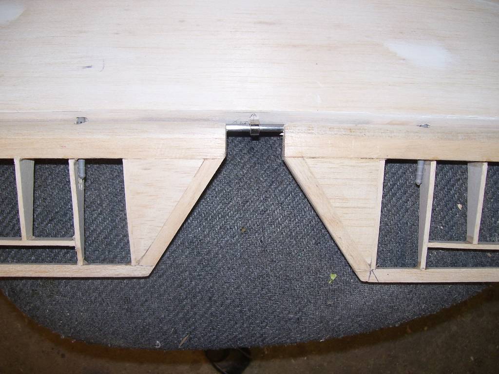

OK, I filled in the wire joiner area on the elevators with balsa, makes for a nice solid area to glue in the wire. Just placed everything on the fuse for inspiration. LOL

Old 01-05-2013 | 07:53 PM
Posts: 1,343
From: Orange, NJ
Are you sure the hole that the wire is in will not enlarge over time and cause the elevator to develop play ? This use to happen on my 40 size planes a while back and what I started doing was the slot that the wire is in I filled with either powder or micro balloon then soak with thin CA the whole area. No more soft area and no more elevator slop.
