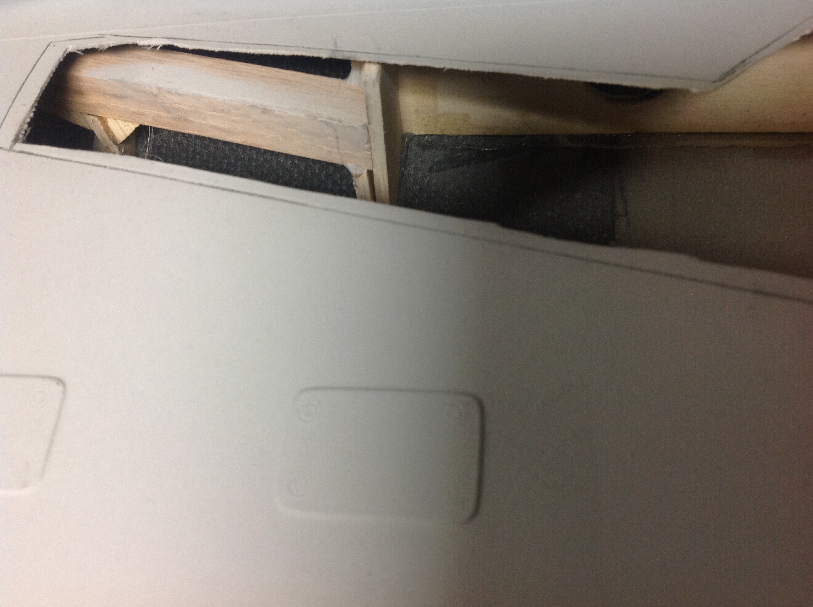

Hi All,
About to start on a 1/6th scale '47, using Sierra gear. First time installing retracts, so this may seem like a silly question...
What do you use to mount them to the rails? Some particular type of screw or drill through rail and use bolt/nut? Considering landing forces, weight, impact, etc,.. seems that using the right mounting hardware would be kind of important, but I can find nothing other than hooking up lines and such. Opinions and suggestions appreciated!

Plates flex before failing giving the structure a chance to absorb the impact and distribute the forces. A rigid mount assembly will transfer the load to the next weakest point.
If you cant use a plate then use good coarse thread sheet metal screws in predrilled holes. You want the drill size to be smaller than the minimum screw diameter (minor pitch dia) to make a pilot hole. The screw will then cut a nice clean thread in the wood. Unscrew them and use thin CA glue to toughen the wood grain. Assemble the gear and check fit.
If you use a blind nut and dont have access to the back of the rail then the blind nut will aid in splitting the rail because it has a larger diameter shank. You must predrill the hole on the back side to clear the shank diameter to do it right. It will be a stepped hole not a clearence hole all the way thru because then the screw can move within the diameter of the large hole.
Using a machine thread which is a fine pitch thread is ok but not ideal. The threaded wood doesnt offer as much leverage to compress the assembly when you tighten the screw. If its long then yes it does a better job but if its a short screw then I would change to a coarse thread sheet metal screw.
If the retract flange is about 1/8 in thick then you want a screw that is a minimum of 1/2 inch or longer if your using washers also.
Post a photo of your retract install and the guys here will be happy to give you better suggestions.

Thats some great info. Chris, much appreciated. I'll see if I can post this pic.. I havent relieved the area around the rails yet, the rail extends about another 6" to front spar. The flange is 1/8th. Basically planning ahead so when I'm done testing and ready to mount I'll have the materials on hand. Thanks again!

There is not always room for a plate, and even if there was, the original bounting beams are often installed so closely together, that any eccessive force (hard landing) will cause the retract unit to bend/break the beams, even if an additional mounting plate is used. I have several 40-50lbs jets/prop, and I use wood screws in them all. The screws just barely peeks through the beams/blocks/plate. As mentioned above, something has to give, and I want to "control" that as much as I can.
If you secure the retract rock solid with machine screws and nuts, the mounts might hold up on a hard landing, but on inspection you might very well discover that the struts are slightly bent;(
Other modellers might prefer this..
I prefer to fix the screw holes and put in some new screws

Hmmm, just looked at your photo Radical. Personally, I would cut out a good bit of the wing skin around the mounting beams, and reinforce or maybe change the stock ones completely. The wing skin part can either be glued back on, or made to function as a big access hatch for future possible retract repairs/maintainance. You can do it now, when everything is clean and new, or later when you have a mess after a hard landing /off the field landing.
Just a thought

I'm going to be cutting the area away, just haven't got to it yet, getting all the things I need together so when I start I can keep moving right on along. Planning on using G10 to make covers. Putting some reinforcement around the existing rails is no big deal, can do that. Sierra sent the wrong size wheels, got tired of dealing with Darrell and got right size from Robart, and now they've been delayed. Really not wanting to get too far along until I can make sure I have the wheels centered. Hurry and wait! Trying to figure how I'll get the inner doors to work is whats been keeping me bamboozled.. but that's another topic...
