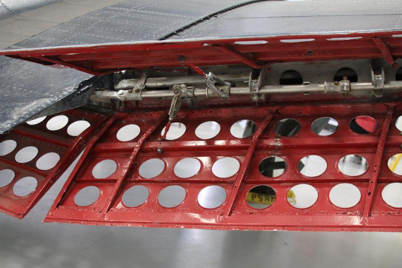

Here are some pics of the full scale mechanics....and if you look at SkyShark's instructions, they deal with that a little bit. You can download their manual for free.

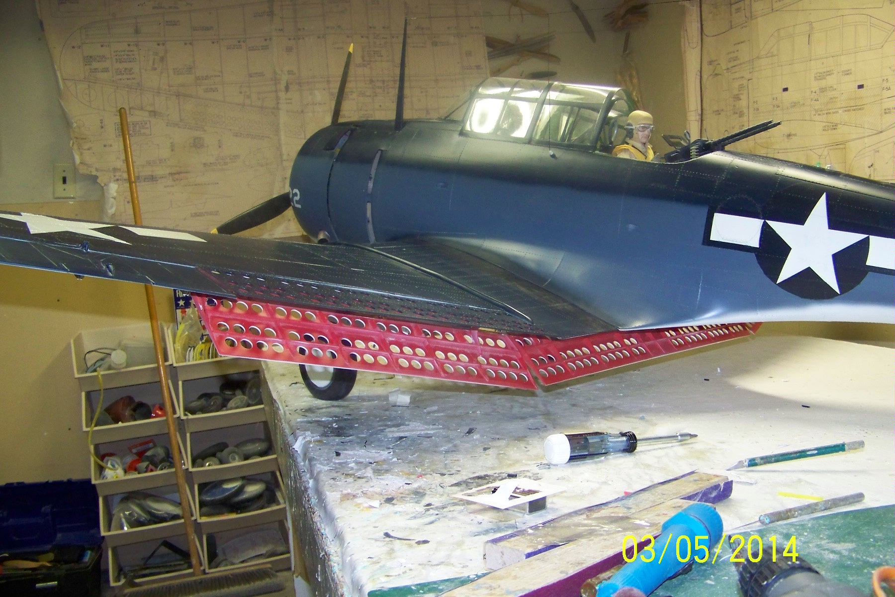

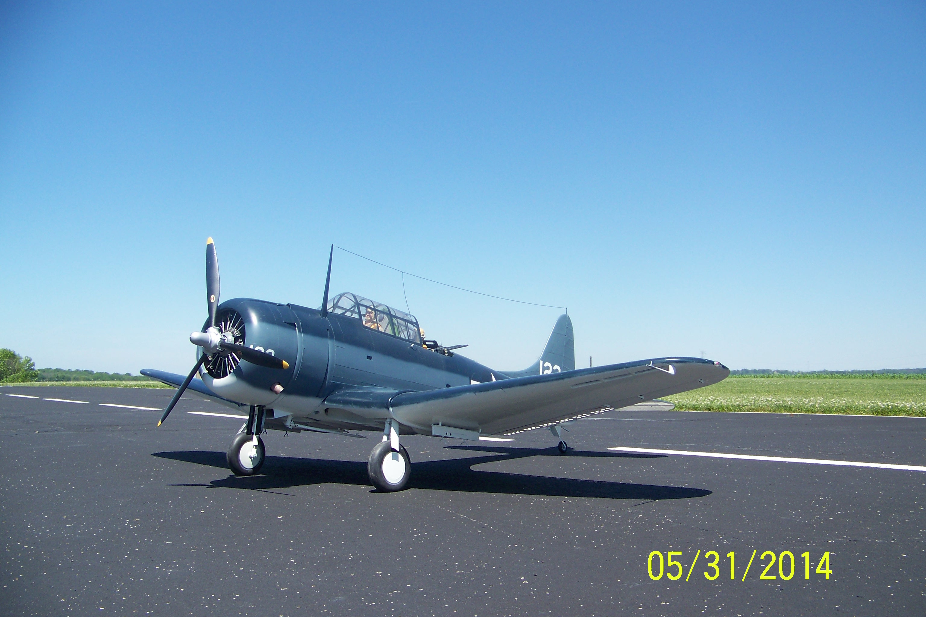

05-17-2015 | 03:26 PM
On my Bates SBD I have the three flaps on one channel (the flap channel) and the two dive brakes on a separate channel. The flaps are slaved to the brake channel so that when I flip the brake channel switch all 5 surfaces move.
Chuck
