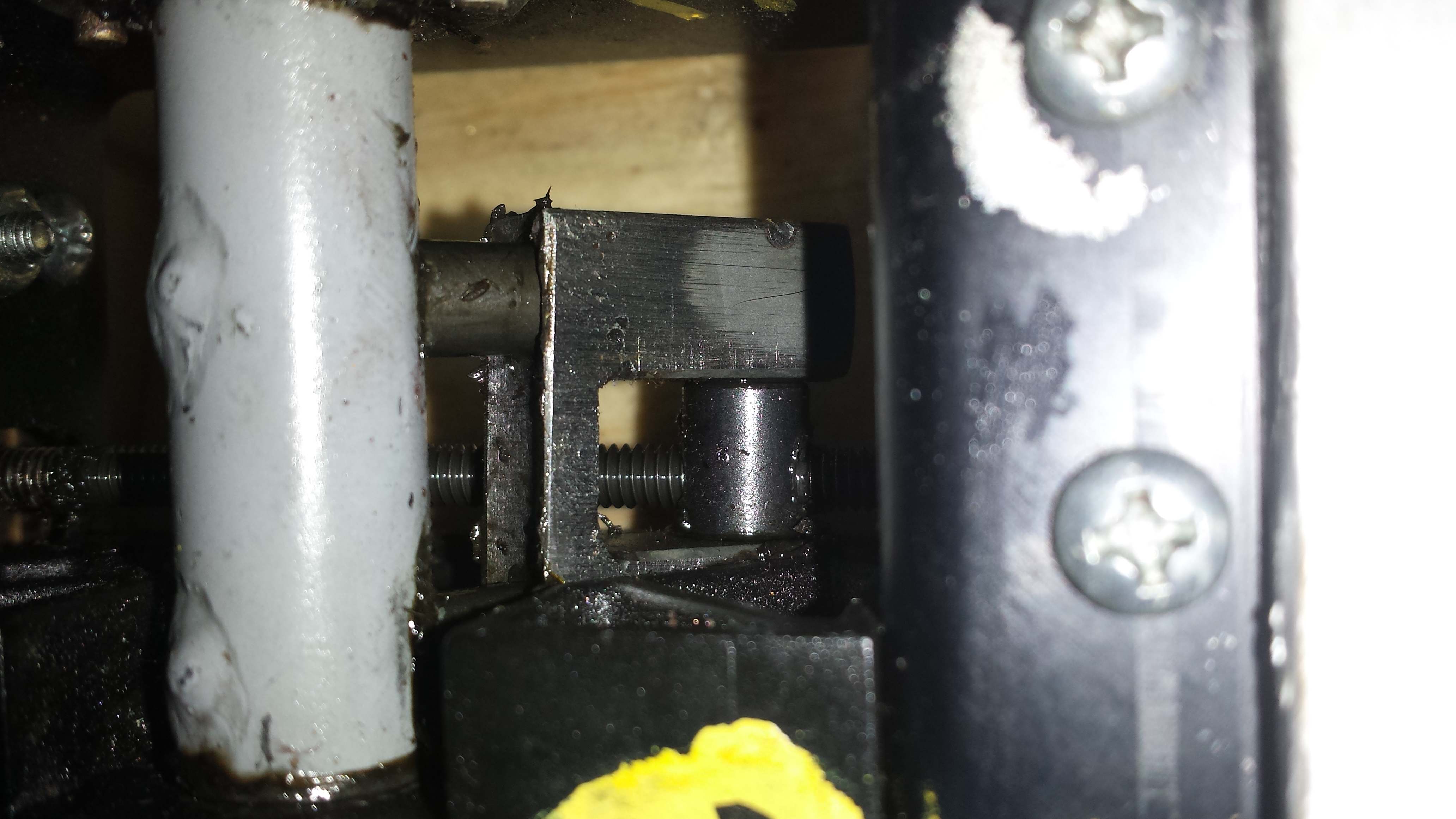

http://www.rcuniverse.com/forum/rc-w...t-arf-136.html post 3391
This shows how another guy did his on robart fw109 gear. Same concept as my fix. I Think we both thought it up at the same time.
As far as wing fixes, the are scattered in the 3 Mustang treads.
' TF 1/5 Scale P-51 ARF Assembly (1ST MISHAP!!!)'
is the biggest one.
In a nut shell, open the bottom of the wing from the wheel hole to just before the aileron servo bay. Expose the spar box. Double all the shear webs with light ply. Double the ribs that the gear blocks are attached to. Run blocks under the gear block and extend them to the spar box. These fixes will distribute the load better and keep the spar box from spitting.

Yes, the picture is for a fw109, but the mechanism is the same. If you don't capture both sides of the rods the jack screw rides in, the backside will twist.
I put 4 more flights on one of my mustangs today. Last year before the fix I ruined 3 set of robart electrics. Since the fix more than 60 flights no problems.
It is a design flaw. I talked to robart about it last August. I was told that something has to give if there is a bad landing. Let me tell you, t he gear I wrecked were not from bad landings. During a cross wind (crowed) landing the jack screw pivot would pop out of t he holding blocks and twist the back holding block rod. 50.00 to replace that piece.
I may not be explaining this well.
Good luck.

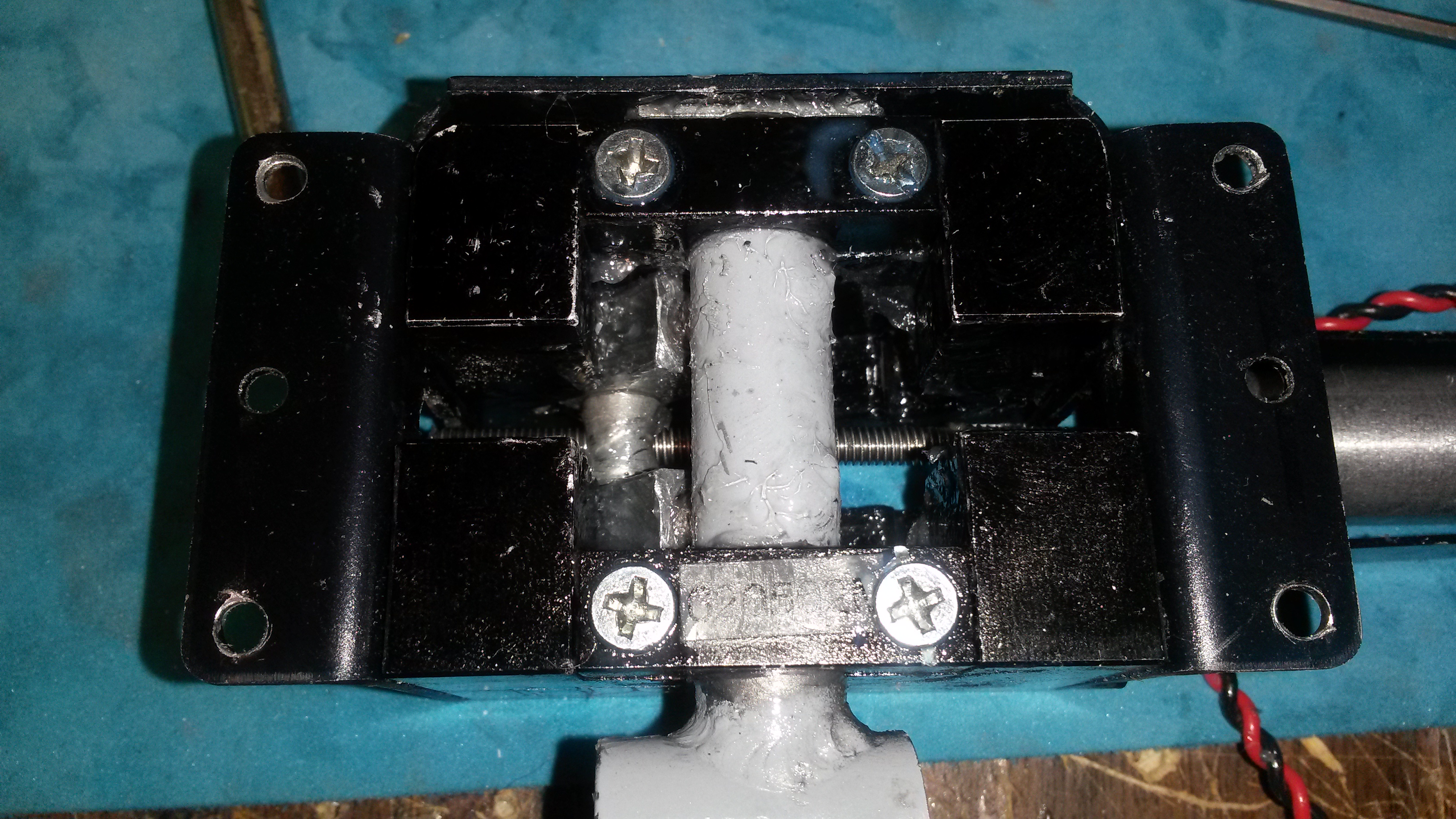

It's amazing that Robart has not fixed the problem with the holding blocks twisting causing the linkage barrel (part that the jackscrew threads thru) to pop out of the holding blocks. I had the same problem on a take-off on an asphalt runway at the Mint Julep in Kentucky meet last year. The motor then ran the entire flight until it burned out.
Down and Locked fixed the problem by machining a new part that combined the two holding blocks into one piece. Has worked perfect since. Now if they could just get an electric motor that is strong enough to operate the retracts without burning out or amping out before the gear cycle is complete.
There are several flyers in my club that have tried the Robart electric retracts on warbirds and all have gone (or are going back) to air retracts because of the problems with the motors and jackscrew. Down and Locks fix below: That is grease that looks like dirt.

I saw your post about Down and lock in the past. Down and Locks conversion is better then Robarts but way move expensive. I have one set from them and have never had an issue. Either way the problem can be fixed. I don't know what what D&L charge you for the fix, for 20.00 and 30 mins you can fix Robarts your self. It just requires a little engineering, but fairly simple.

Yeah, Down and Locked charged me $50.00 to install their new holding blocks plus shipping of $18.00. I agree either fix is a lot better than the stock setup. The motor problem is a bigger issue with the electrics. They are going to have to do something about the motors before I purchase any more electric retracts.
