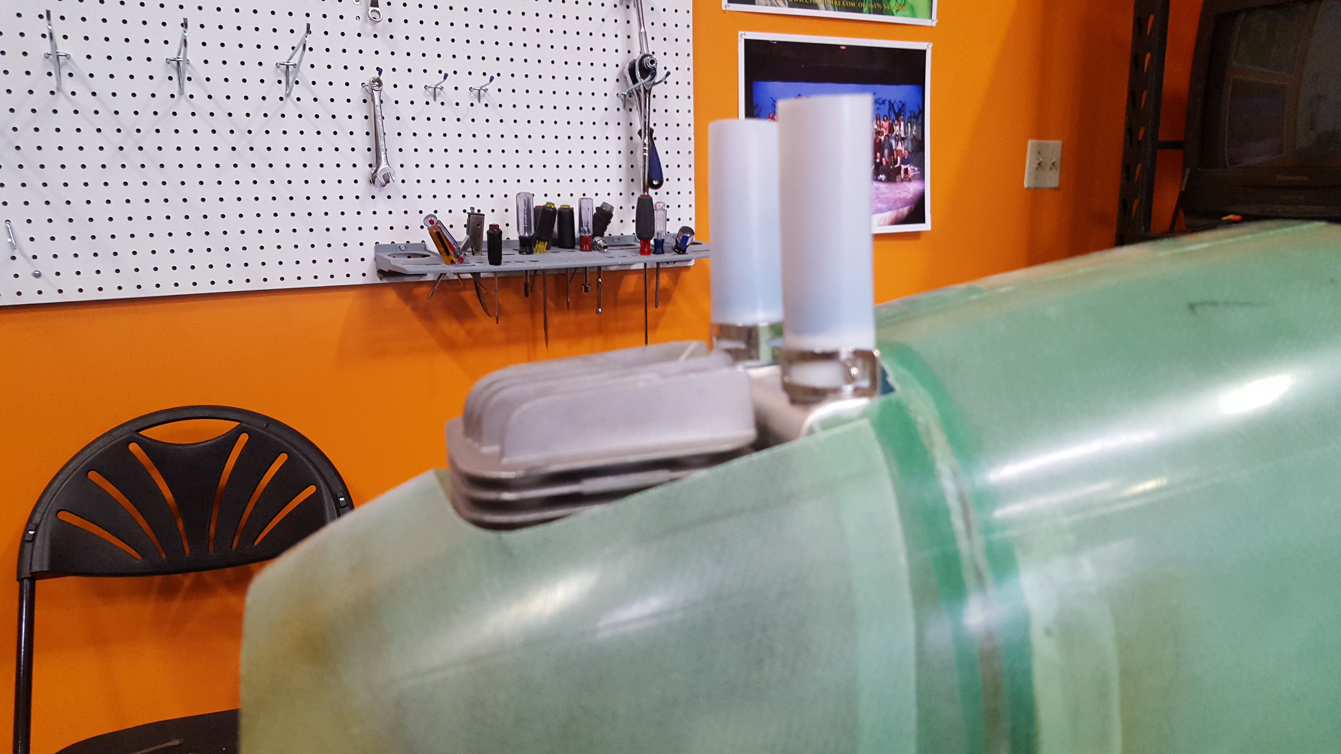

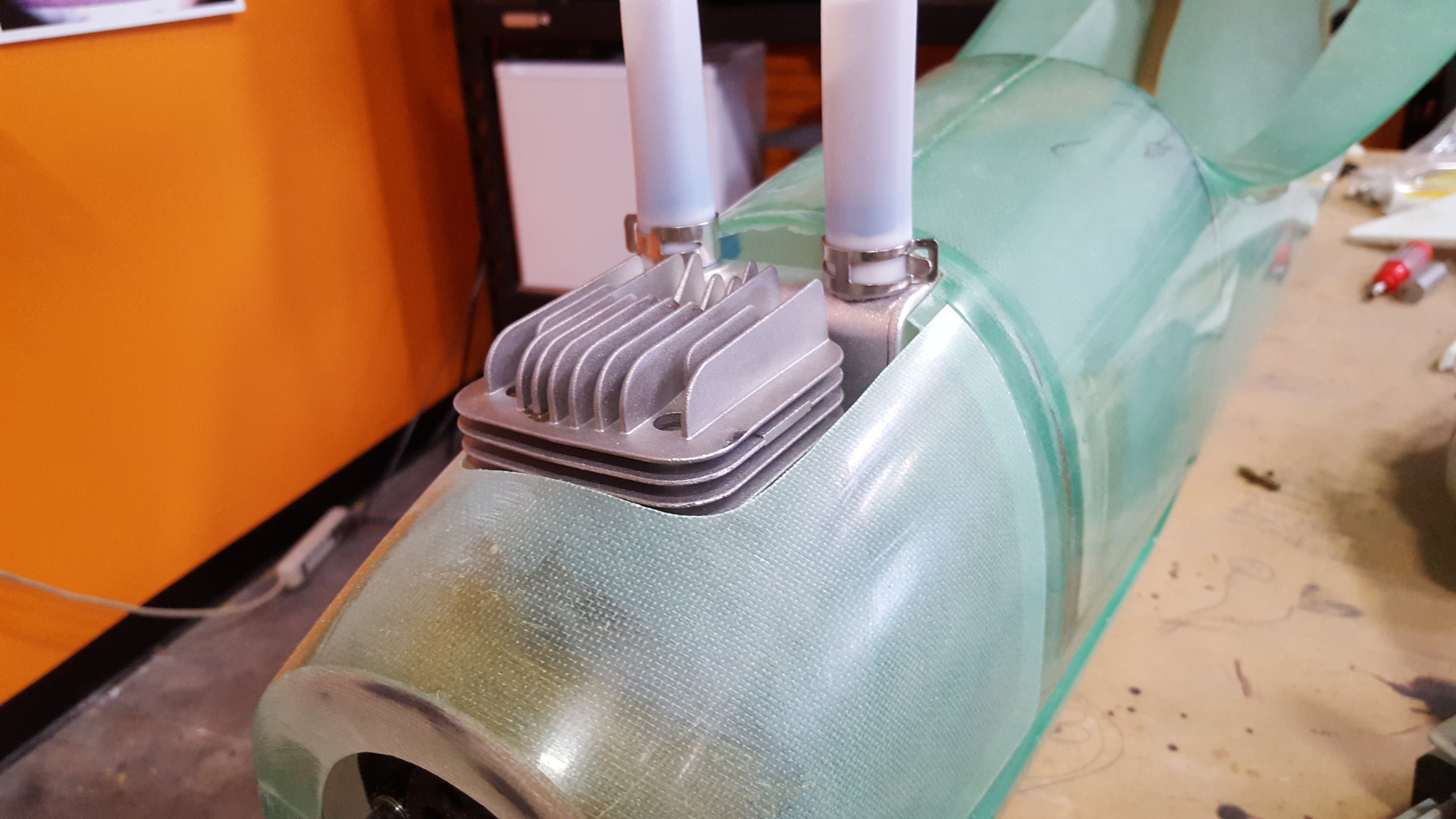

Hi. What do you guys think? Is there enough head sticking out into the propwash to cook this DLE 55?

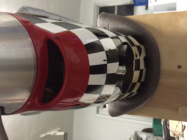

Originally Posted by Shaun Evans
Chris,
Could you post a pic of what your nose looks like on the Stang?
I'ts pack away for winter, but I'll try to dig up a picture. You have way more of the head sticking out then I ever had.

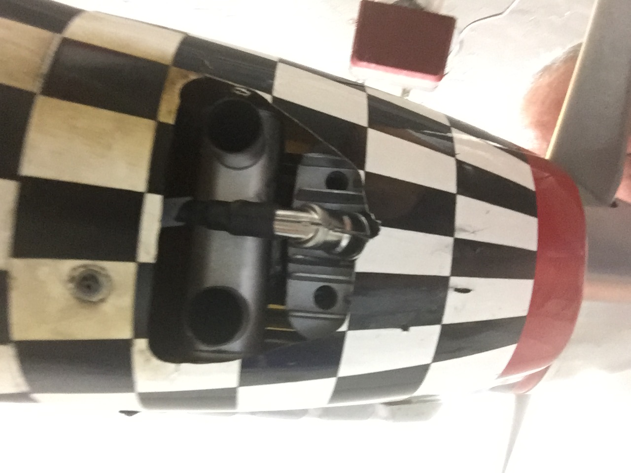

Old 01-04-2016 | 08:33 PM
jkeze's Avatar
My Feedback: (36)
Posts: 327
Received 4 Likes on 2 Posts
From: Ocala, FL
This is a DLE 55RA in a Top Flite Mustang. I have a couple of hundred flights on it with no issues of overheating. Sometimes I get a bit of vapor lock on a hot day if I try and start it again right after I shut it off.
ID:	2139779   Click image for larger version

You will be fine Shaun, just be sure you run good oil like Klotz or Bellray or something on that level and use 91/92 octane non ethanol gas.
As long as the head is getting direct cool air it will be fine. The head is the hottest part next to the exhaust port itself but it has the exhaust bolted to it which pulls heat off the manifold.

Old 01-06-2016 | 05:50 AM
My Feedback: (43)
Posts: 2,297
From: Carrollton, VA
I would think that you may have overheating issues on a hot day. Since the Spitfire has zero cold air intake, the crankcase, lower cylinder, exhaust, and carb will all run in a very hot environment. The radiated heat from the muffler will make the the bottom end of the engine run hotter and will probably vapor lock on you. The Mustangs have a some flow through with the chin scoop, and in flight there is a blast of cool air on the entire cylinder of the engine. Also the flowing air has a much better chance of sucking some of the hot ambient air inside the engine compartment out as it enters and exits the cowl area.
The Spit....no flow, no way to extract hot air.
