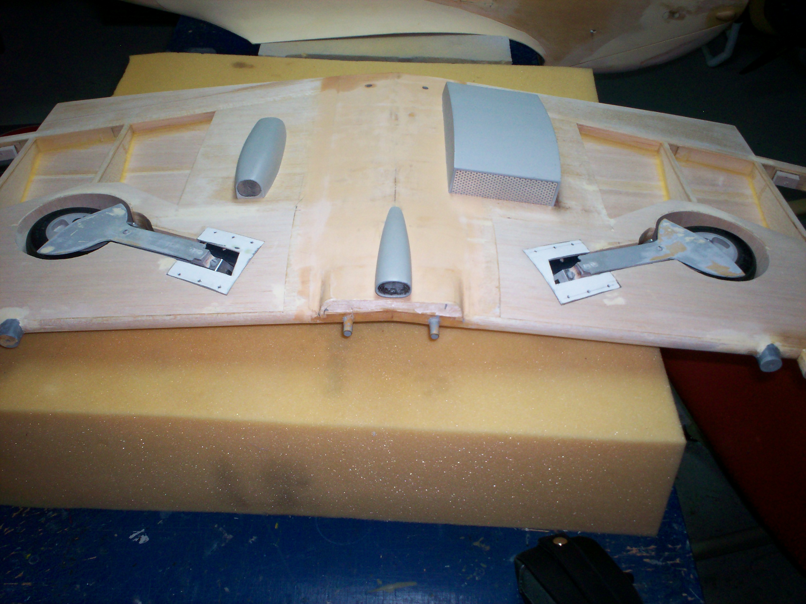

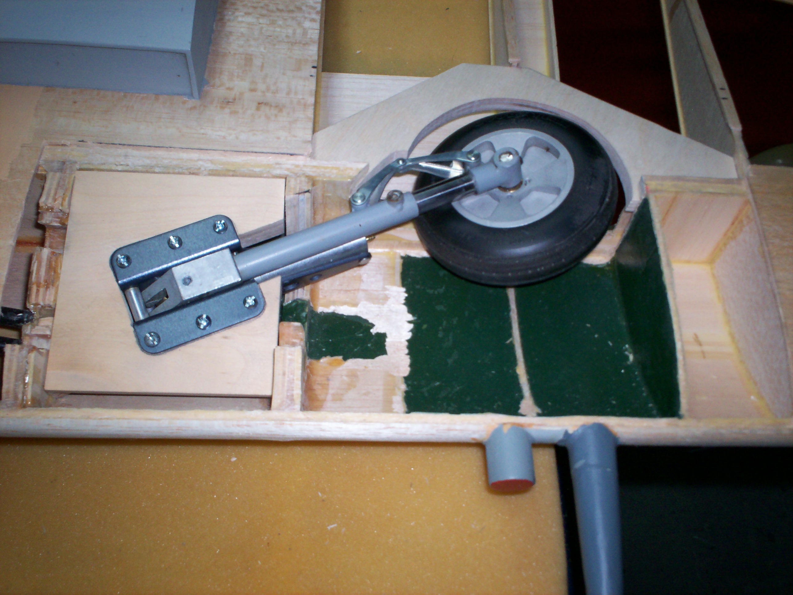

I did this on mine. It's a bit of work but scale position for the main retracts. Retract inboard to outboard and backward.

Yes I did modify the bottom spar to gain clearance for the wheel well. Originally the retracts were ahead of the spar but when I refurb'd the plane I decided to move them to a more scale position.
Of course the down side is I needed to add some weight to nose to balance it. I don't recall how much but it wasn't that much.
