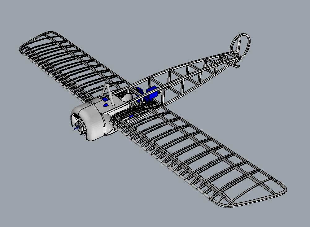

Project's parameters
I not only wanted to build a fully detailed model, but i also decided it would be interesting to make thinks even harder.
How?
What if we scaled it down to a 60cm wing span?
Not hard enough yet, what if we keep the original wing warping mechanism for rolling?
Well, wing warping in a 60cm wing span model?
Yes, we're getting there.
With all those initial parameters it was time to start planning and setting a few goals:
1. Weight should be around 160 grams
2. It should allow me to use a 1811-2000kv brushless i have had for the last 13 years and haven't ever used
3. It should allow me to use a 2s 450mah Lipo i have had for the last 13 years and also haven't ever used
4. It should allow me to use a two micro servos i have had for the last 13 years and also haven't ever used
5. It should have as much scale details as possible
6. It should have wing warping for rolling
7. It should be covered with craft tissue (not esaki)
8. It should be painted, aged and wheathered in order to look as much as the real thing as possible
9. It should use pull-pull for all the control surfaces
10. It should have a low wing loading
11. It should be able to fly outdoos
12. It shoud have functional front and rear suspensions like the real thing
13. I should not follow any plan, instead, i should project it in 3D in a CAD program (Rhino in my case) and use the 3D model to simulate and plan everything before start building it.
14. It should have an alluminium cowl and panels like the real thing
15. It should fly slow
16. Most of the electronic components should be hidden in the fuselage
Model data
Wingspan: 60cm
Wing chord: 10.5cm
AUW: 160 grams
Wing Area: 5,75 dm²
Wing Loading: 27~35 grams/dm²
Color: Aged light brown
Motor: 1811-2000 kv micro brushless
Propeller: 6x3 ou 7x3 (depending on the final weight)
Static thrust: 130~160 grams depending on the choosen propeller
Battery: Turnigy nanotech 2s 450mah Lipo
Servos: 2x 2.5g Turnigy S0251 micro servo for tail control and 1x 9x metal gear Tower Pro for wing warping mechanism
Receiver: Radiolink R6D
Esc: Turnig Plush 6A ESC
Bulding materials: Balsa, plywood, craft tissue, artist acrylic paint, thin and medium CA, carbon rods, barbecue wood sticks, and other stuffs available in the shop.
That's it, in the following posts i will be posting the pictures i already have and as the construction progresses i'll keep taking pictures and posting them here.
Fell free to interact with me, ask questions, suggest anything, etc....

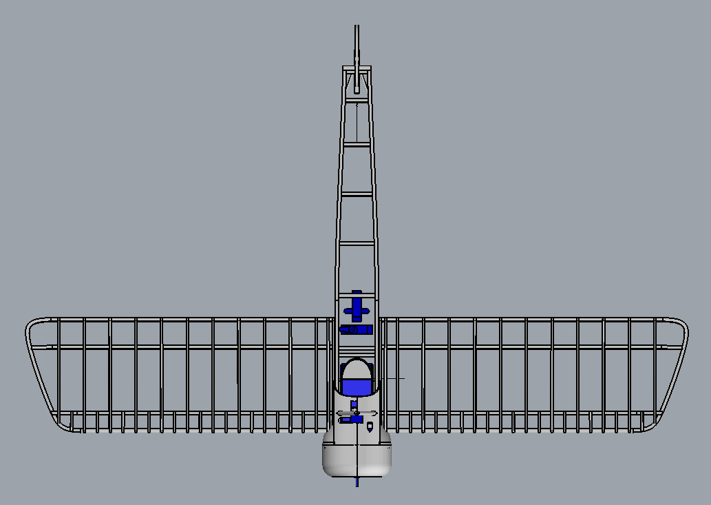

After a few days of planning and work i had it done and ready to be built.

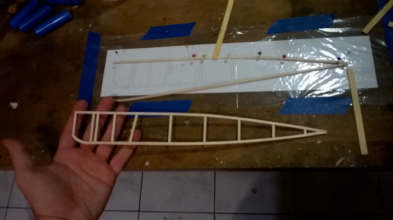

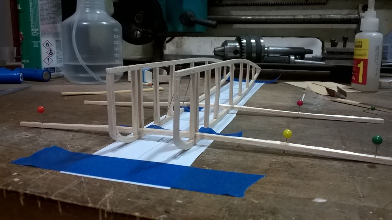

Lets start cutting and gluing some balsa..
ID:	2244618   Click image for larger version
ID:	2244619   Click image for larger version
ID:	2244620   Click image for larger version
ID:	2244621   Click image for larger version

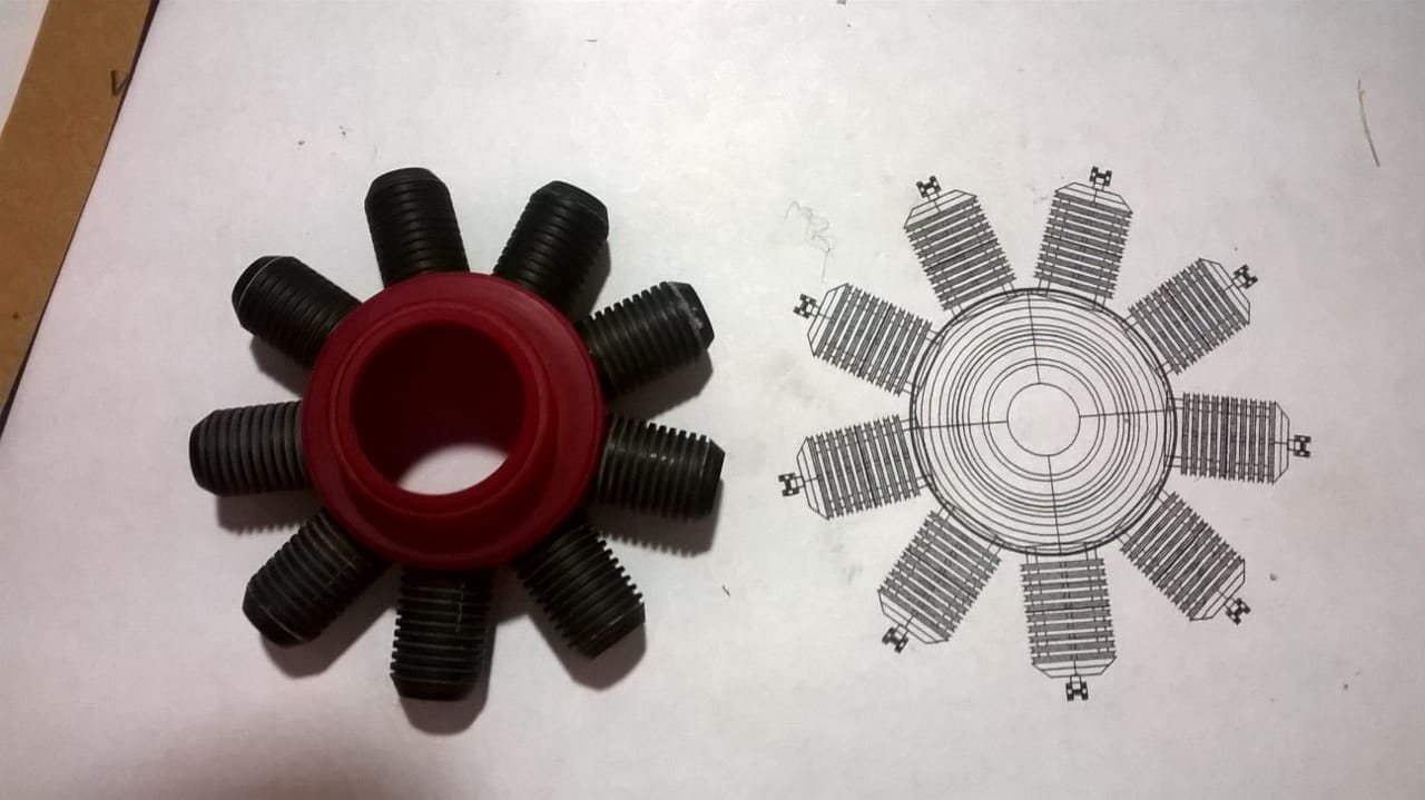

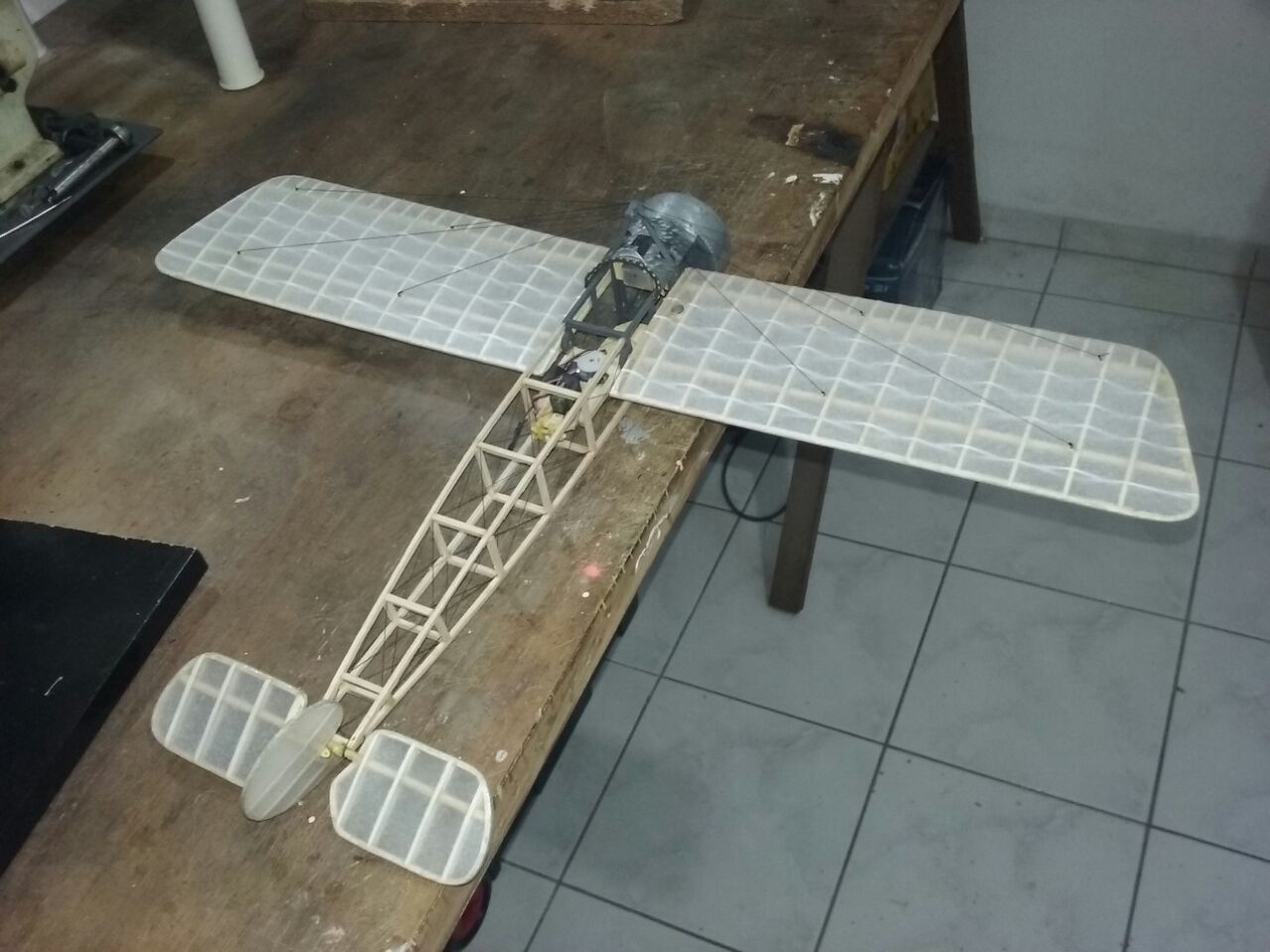

First scale details start to appear....
ID:	2244623   Click image for larger version
ID:	2244624   Click image for larger version
ID:	2244625   Click image for larger version
ID:	2244626   Click image for larger version

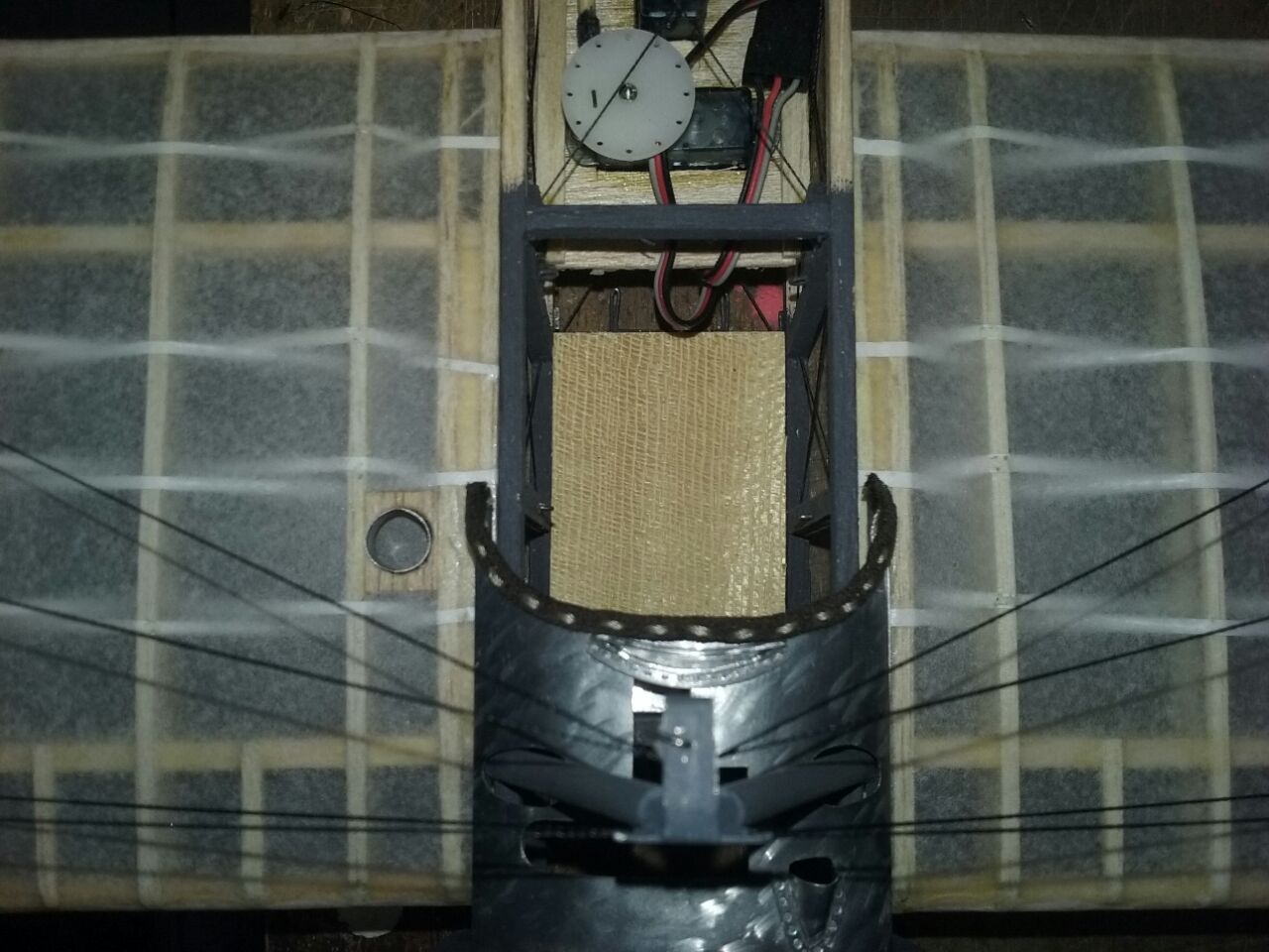

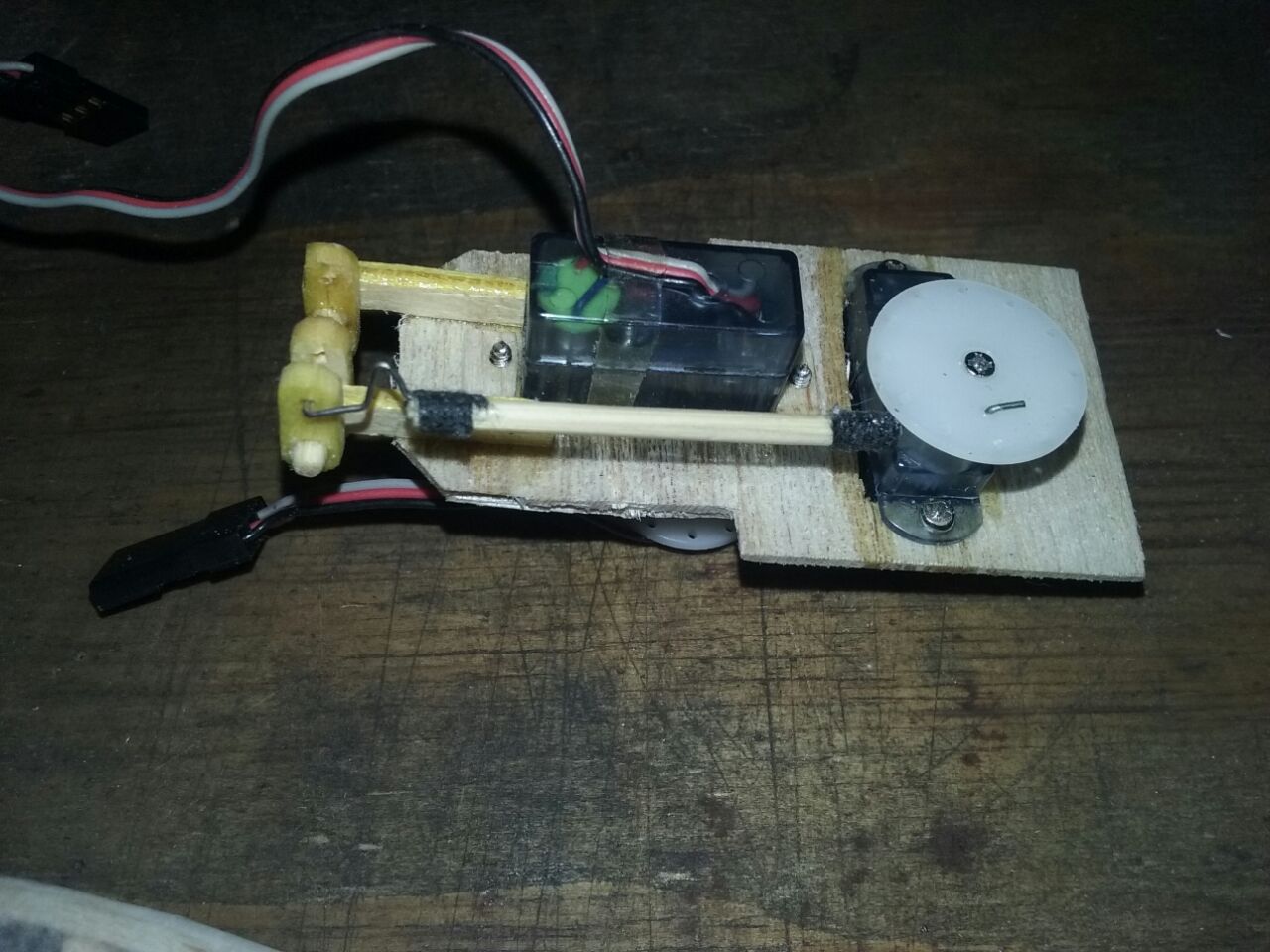

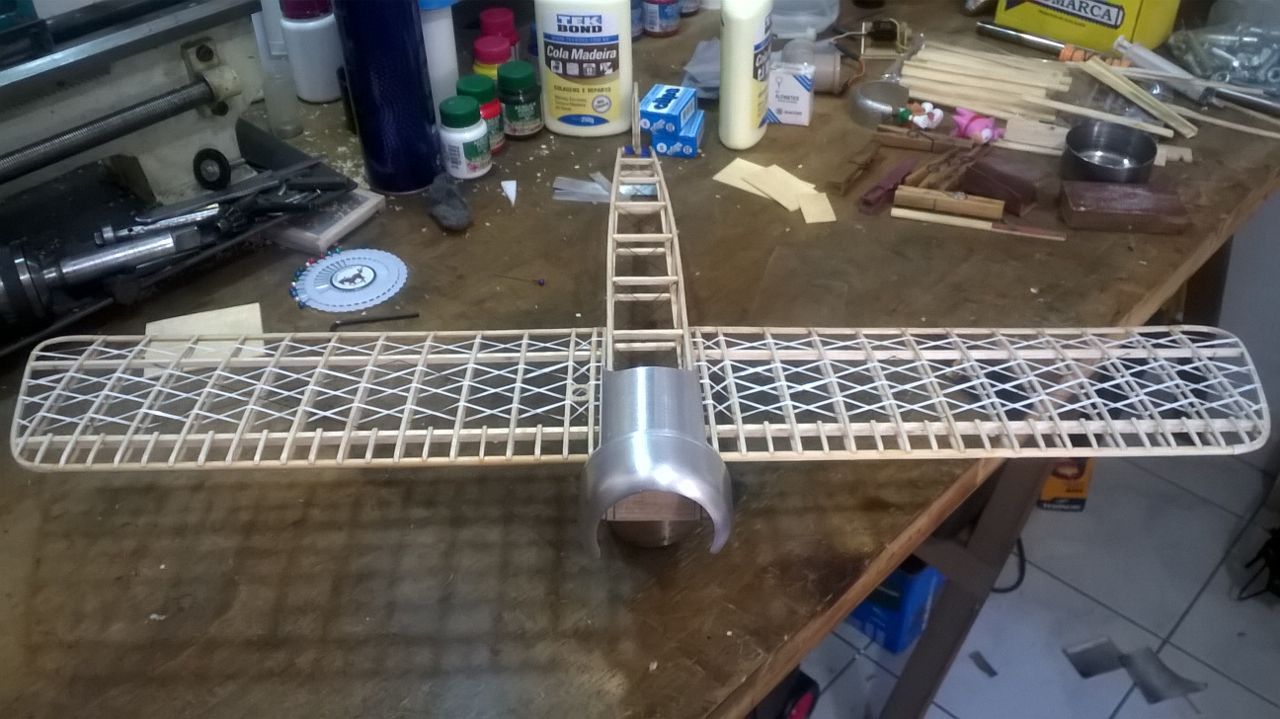

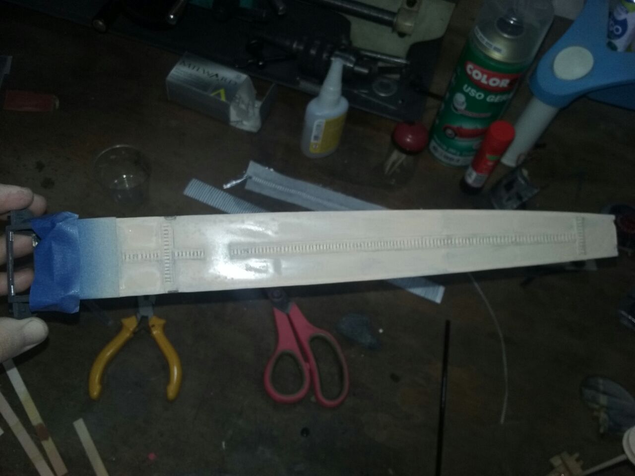

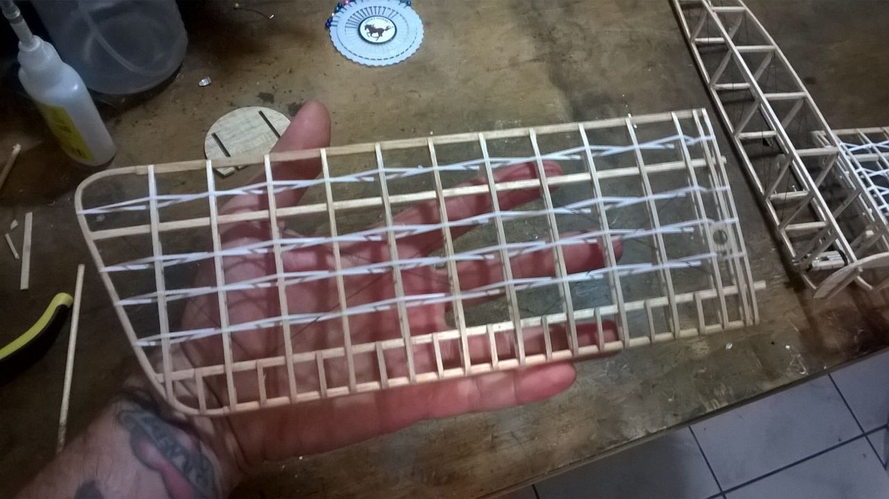

In order to have the wing warping mechanism working i had to have a very flexible wing
The strings and stripes are just scale details and have no function at all.
ID:	2244628   Click image for larger version
ID:	2244629   Click image for larger version
Old 11-12-2017 | 08:31 AM
Joined: Jan 2005
Posts: 65
From: , MS, BHUTAN

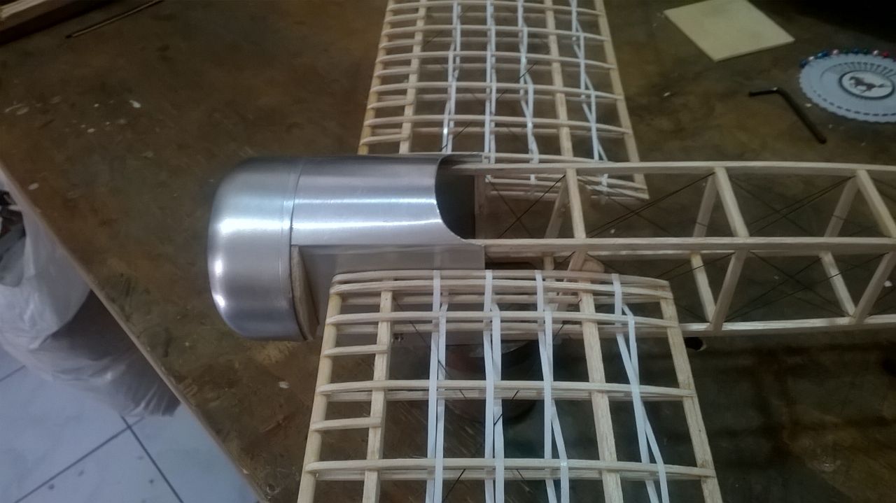

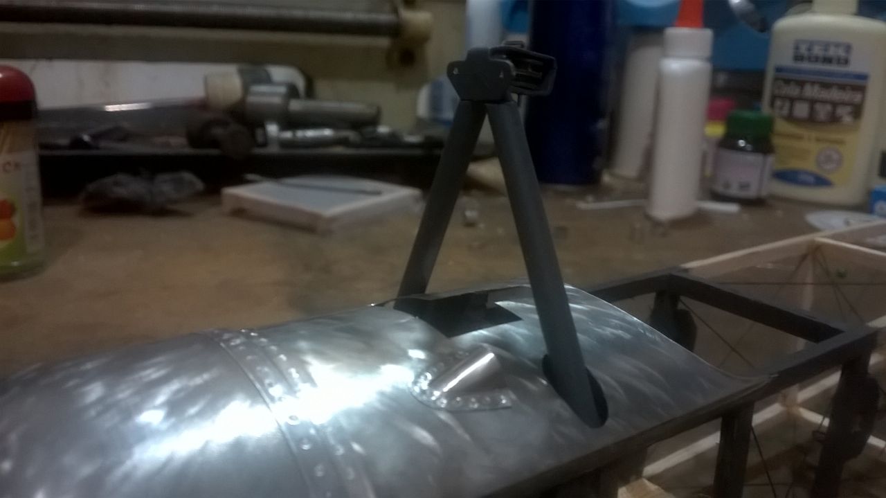

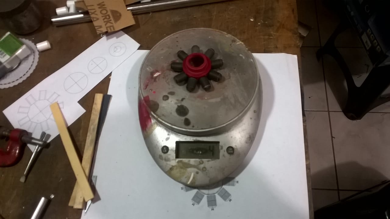

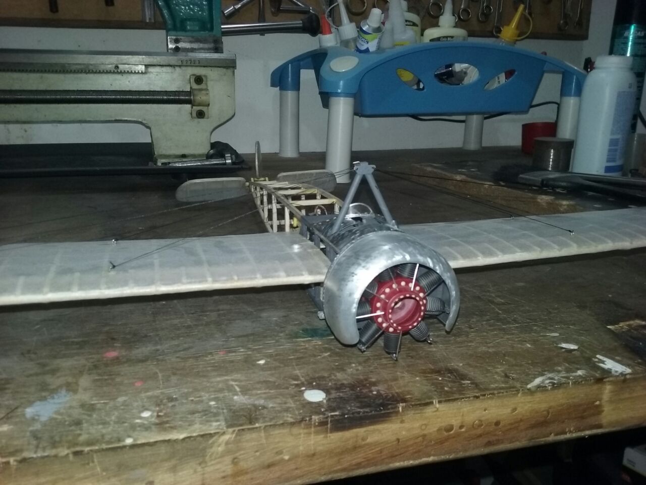

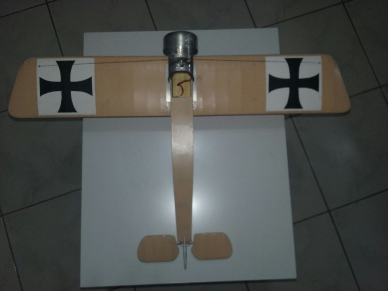

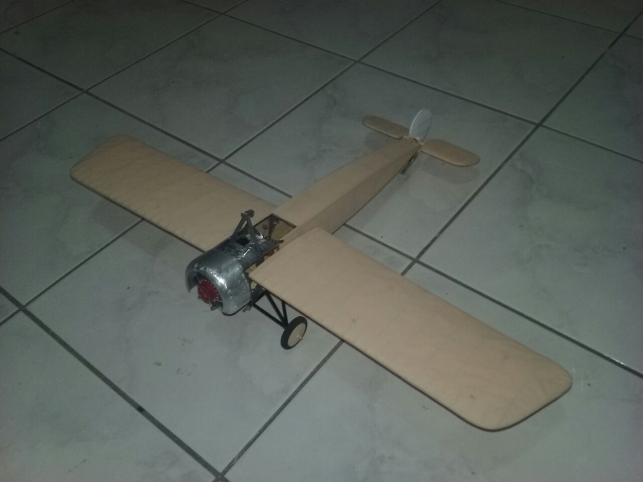

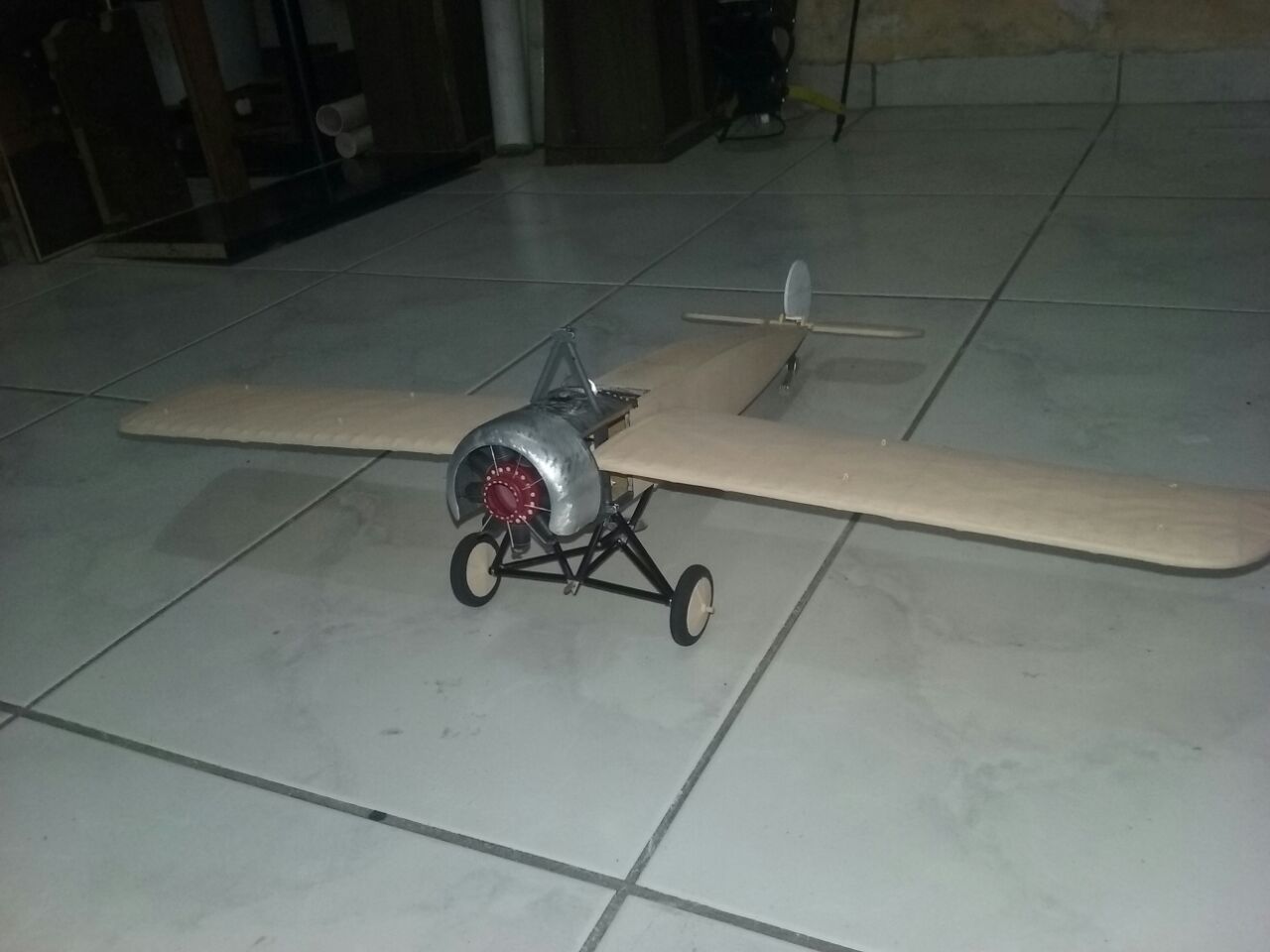

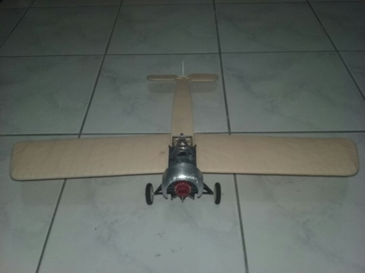

Cowl and metal panels done.
The cowl was spun in the lathe.
I have no experince with metal spinning so i had to learn it and i have to say: It was a pain in the ass.
I used 0.5mms roof alluminium sheet and it almost impossible to deform it without screwing things up.
I had to try 18 times untill i finally got a usable cowl.
ID:	2244633   Click image for larger version
ID:	2244634   Click image for larger version
ID:	2244635   Click image for larger version

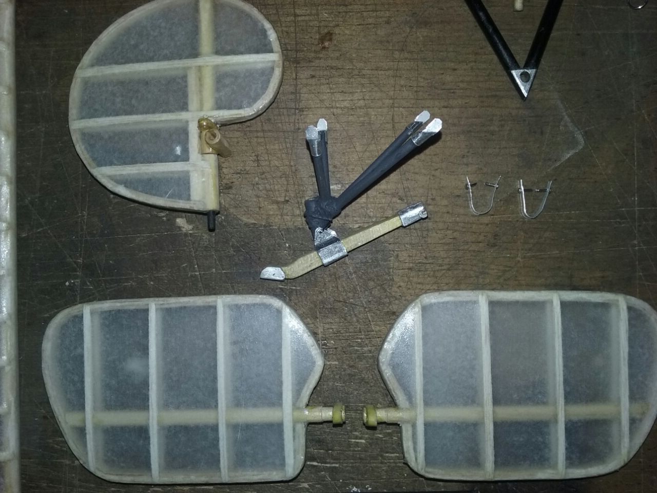

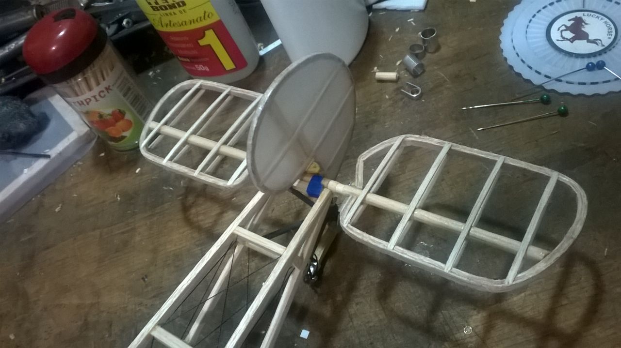

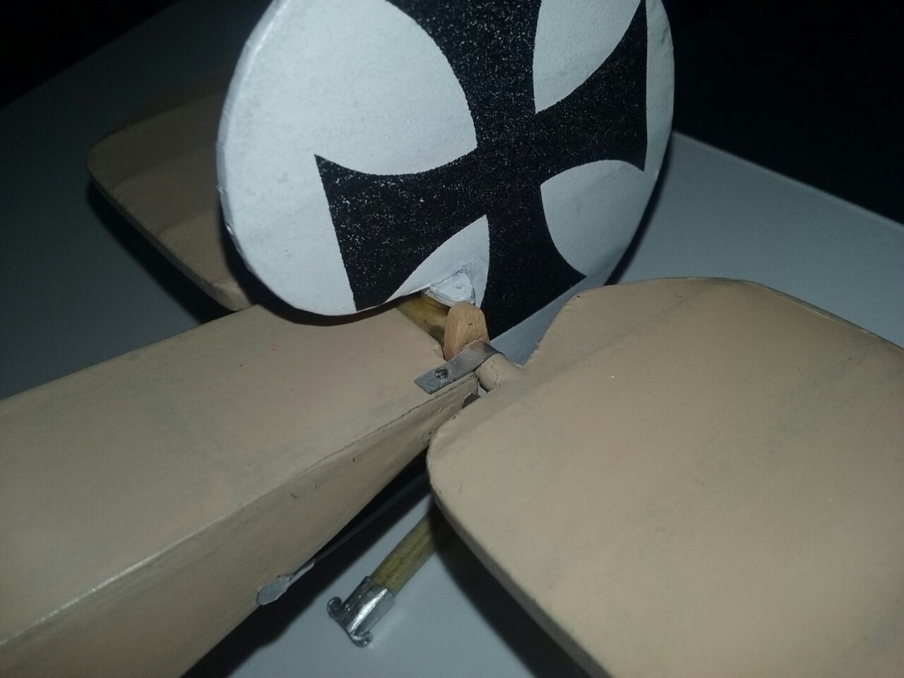

It's rudder time....
ID:	2244637   Click image for larger version
ID:	2244638   Click image for larger version
ID:	2244639   Click image for larger version
ID:	2244640   Click image for larger version
ID:	2244641   Click image for larger version

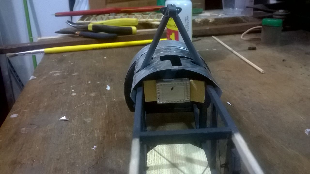

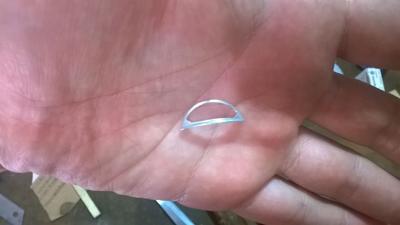

Decided to work on a few details on the metal parts...
Made some experiments with the metal finished used at that age, don't remember the name, and it was impossible to reproduce in these very thin metal sheets.
I didn't want to leave it raw, so with a dremel and a few set of tools i made a similiar effect.
ID:	2244643   Click image for larger version
ID:	2244644   Click image for larger version
ID:	2244645   Click image for larger version
ID:	2244646   Click image for larger version
ID:	2244647   Click image for larger version

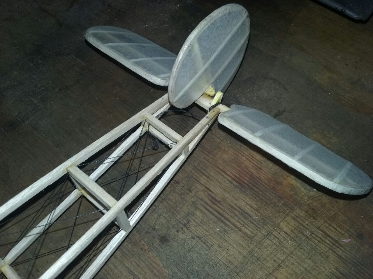

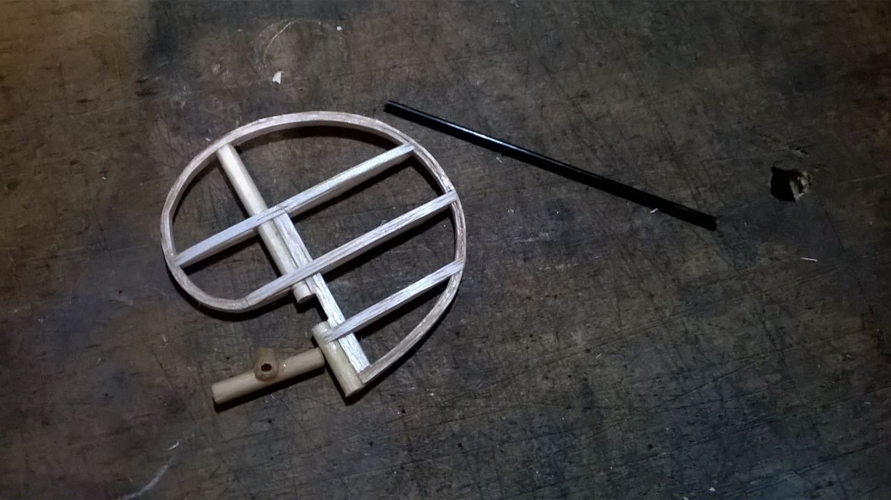

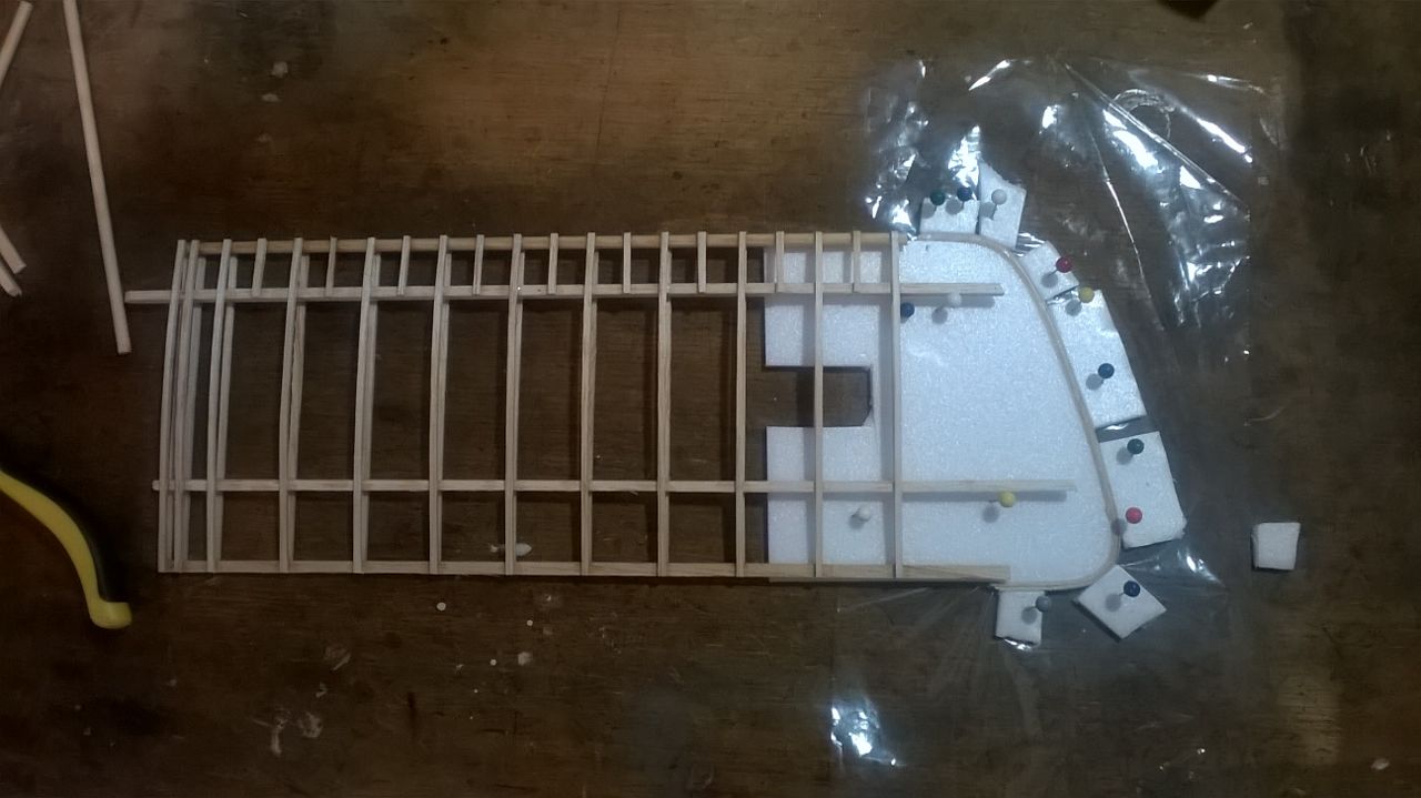

More work on the tail
ID:	2244657   Click image for larger version
ID:	2244658   Click image for larger version
ID:	2244659   Click image for larger version
ID:	2244660   Click image for larger version
ID:	2244661   Click image for larger version

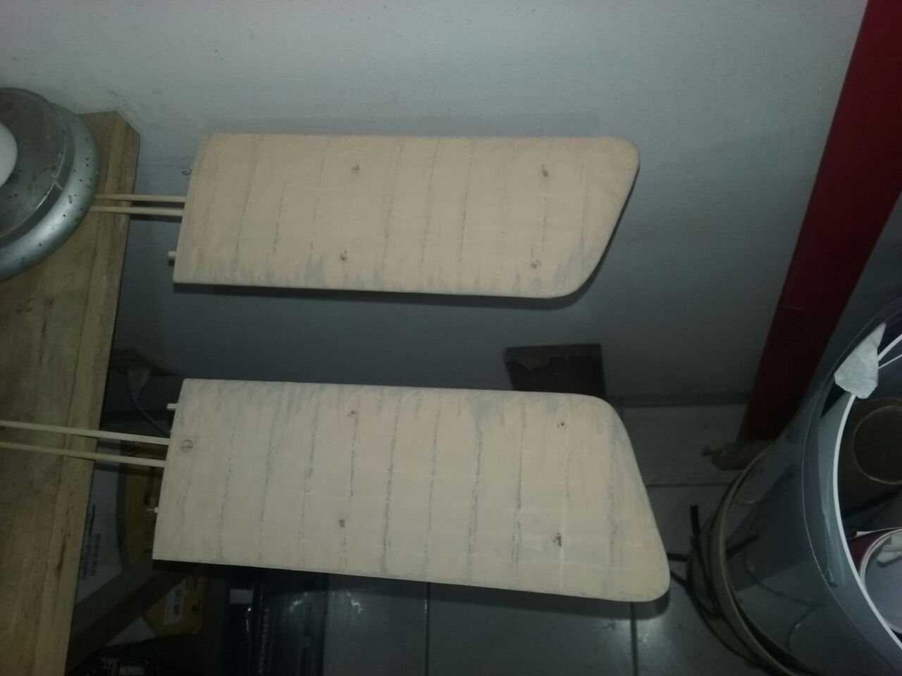

Old 11-12-2017 | 08:35 AM
Joined: Jan 2005
Posts: 65
From: , MS, BHUTAN

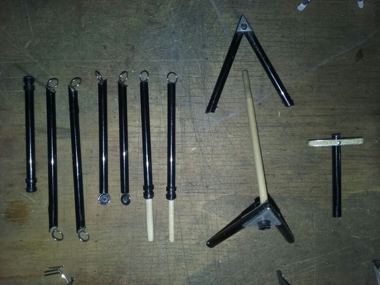

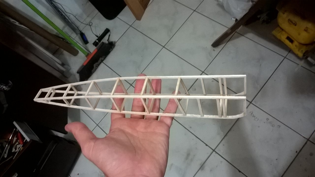

Wing cables support.
I made it with plastic tubes filled with barbecue sticks.
Glued them together, some aluminium on the tip, functional pulley for the two cables that will be used for warping the wing and it's done.
The pulley was turned in my lathe with a scrap piece of plastic i had laying around in the shop.
ID:	2244664   Click image for larger version
ID:	2244665   Click image for larger version

Old 11-12-2017 | 08:36 AM
Joined: Jan 2005
Posts: 65
From: , MS, BHUTAN
Tail servos in place.
They have a sliding bed for ease of access once it's very hard to work with my hands in such a small model

Elevator made and in place

Old 11-12-2017 | 08:37 AM
Joined: Jan 2005
Posts: 65
From: , MS, BHUTAN
Full airframe so far

It's time to loose some hair with the windshield.
Jezus, how to shape such a small piece of thin aluminium?

Obviouslly i wouldn't let the brushless motor in the nose without a dummy engine covering it...
Once again, coming from the 3D project to the real world i casted some polyester resin inside a tube and used it to machine the cylinders and the engine body.
The dummy motor will be splited in two parts.
The back part (backplate) will be used to mount the brushless motor and also will be screwed to the firewall, then, the front part of the dummy engine will cover it all and be kept in place just by press fit on the back plate.

Old 11-12-2017 | 08:41 AM
Joined: Jan 2005
Posts: 65
From: , MS, BHUTAN
Wing covered and test fitting everything together

Front suspension working as expected.

Old 11-12-2017 | 08:44 AM
Joined: Jan 2005
Posts: 65
From: , MS, BHUTAN
Every fabricated part so far

Old 11-12-2017 | 08:45 AM
Joined: Jan 2005
Posts: 65
From: , MS, BHUTAN
Fuselage covered and painting started....
