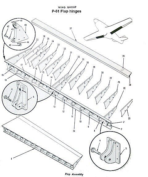

I have a little delema at least for me. I have an old TF P-51 kit and have it mostly framed up and most of the wings built up. My problem is on the flaps where do they hing at on the real P-51. Are they kindof like the P-47 or is the piviot point a little back from the leading edge of the flap. I just don't know can you help.[]

nchrome, The P-47 flaps are actually fowler type of flaps and the P-51 are not. The mustang flaps hinge on the leading edge of the flap section. Check out Mustangsmustangs.com for pictures of stangs.

ORIGINAL: BobH
Which would mean that the hinge point would be the center of the flap's L/E radius, like a rudder?

rich, to answer your question.. yes. Like a rudder, sorta. The hinge is right on the leading edge as much as practical.

This should help! It is the D model if that makes any difference.
