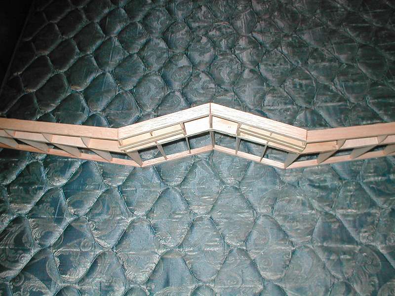

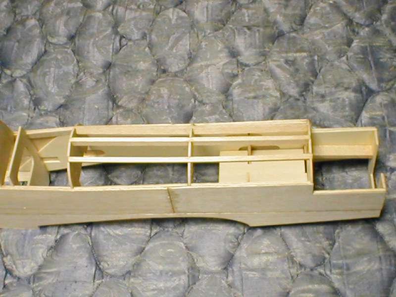

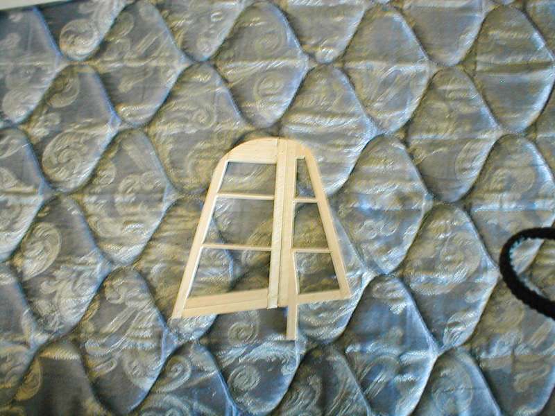

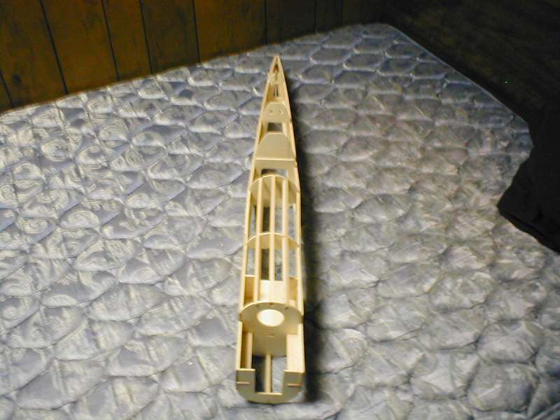

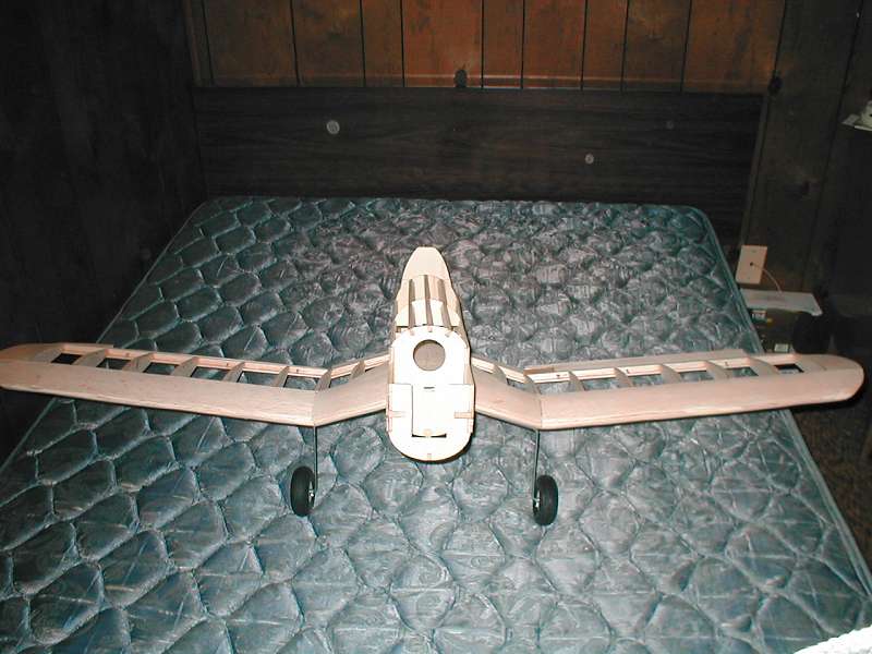

here is an update on my progress. wing is 99% complete and fuse is about 70% complete.

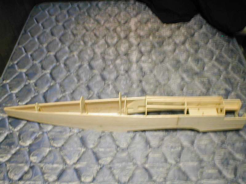

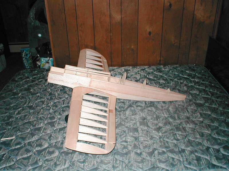

heres 2 more pics

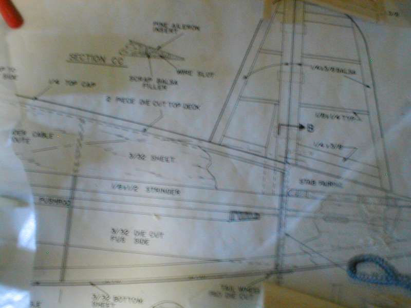

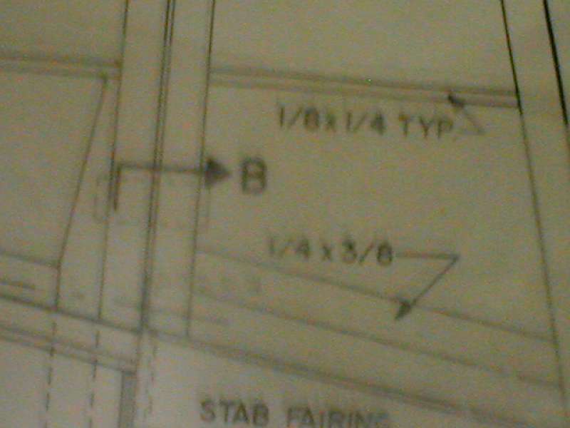

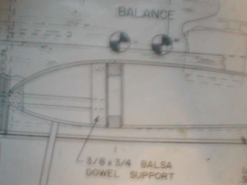

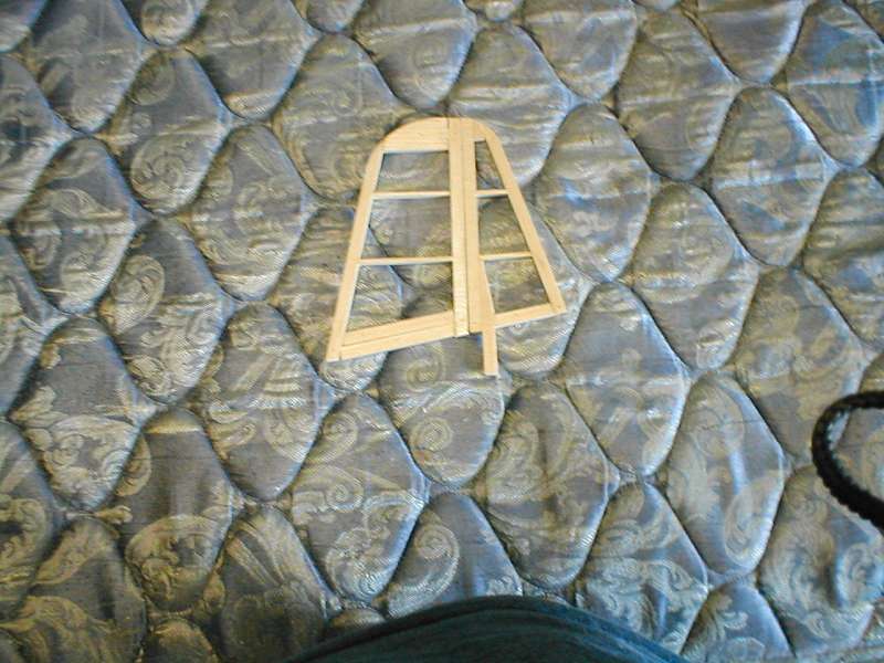

here are a couple of pics of the plans. One shows where to balance the plane the other shows the rudder. unfortunatly it dont show where to mount the horn. When I find this out I will let you Know.

Thanks alot for the help.The C.G question is done.I'm beginning to think that my pushrods are exiting the fuse in the wrong places as last night I discovered that the elevator pushrod exits the fuse too close to the control horn to allow proper movement.As I say,I built her a long time ago & did not have a lot of building experience...& was maybe a little hurried!If the plans show(I hope)the location where the pushrods exit the fuse I would certainly benifet from a picture of that as well.I may likely have to resituate my pushrods to allow proper movement.What a hassle...I just want to fly her!

ok here is a pic of the plans that shows where the rudder cable comes out of the fuse.

I have printed the pics & will compare them to my model when I get some time.I may end-up removing the sullivan goldenrods(?)& replacing them with good old fashioned dowel-type pushrods using the exhisting(correct or not)holes.They are alot more forgiving with regards to placement...although a sloppier arrangement in most cases I've found,what with all those dog-leg bent wire linkage & such!

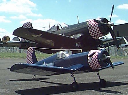

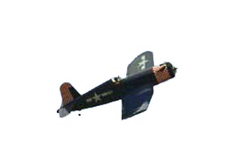

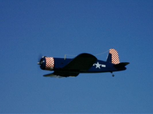

Her's mine (the one in front). It has a Great Planes Corsair cowl (available from Tower for about $10), modified Hobbico mechanical rotating retracts, and Saito .50 for power (.56 wasn't available when I bought kit).
It has well over 1,000 flights, was my 1st warbird, and flew absolutely GREAT! I still have it, but it could stand a re-build (too much pilot abuse). I highly recommend ANY of the old DynaFlite funscale warbird kits as a 1st warbird. The have some of the flying characteristics of the more scale warbirds, but but are still easy to fly. Great for the transistion (sport to warbird).

That looks pretty decent Corsair Jock .Ill have to try to find a cowling like that .. 1000 flights !!! Must be on your favorite plane list ..L.O.L... I bought this one used and Fed Ex half killed it . [:@] Cant wait for the snow to melt ..Maybe a Corsair with retractable Skis ??? L.O.L...
