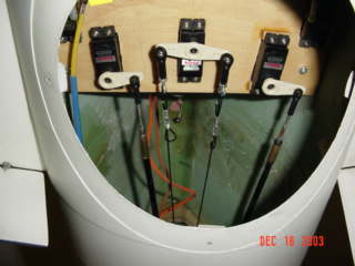

My Feedback: (52)
Jay,
I use one Hitec 615MG servo for each elevator half. These servos, as well as the rudder servo, retracts and kill switch servo are all located on a servo tray that I designed and is located directly under the belly pan opening. The elevators use carbon fiber rods and 4-40 harware.
I took one look at the flap design and asked myself one question . . . why? It is not only easier, but far more reliable to simply put one flap servo in each wing panel. I highly recommend doing that over the stock plan.
I love my Hellcat and you will too.
Give you guys a short war story on just how stable this model is (and by the way mine weighs in around 32 lbs). The last flight I had, I made my final approach all the way until touch down without my flaps deployed. I thought I hit the flap switch, but I did not get it all the way down. The Hellcat slowed to a crawl before she just started to wobble a bit. Then I realized my mistake, powered up and went around again. This time, the flaps were down and she slicked right in.
I included a few shots of the servo set up. Also one of the Cat stored away awaiting its next sortie.
Good luck and have fun.

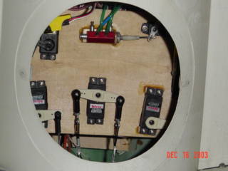

My Feedback: (43)
FYI,
I finally put in a new tray per Mark's suggestion.
I had severe flutter on the elevator last year (when I bought it).
After opening up the bottom, I found a JR 507 moving both elevators with 1/8" plastic guide rods (I'm lucky I didn't lose her).
pic 1:
The new servo tray.
Six screws holding the tray in to triangle hardwood epoxied to the fuse (screws used in case I need to remove the tray: not too much room to work in there!).
I used two 133 oz servos for the elevators (that should do it!).
The rods are carbon fiber with 4/40 rod on each end.
The two new servos are on each side and I moved the rudder/tail wheel servo to the center.

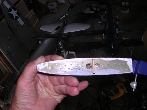

My Feedback: (43)
Got my maiden flight in after the servo updates.
She flew great. The G-62 is more than enough power.
I was flying 1/2-3/4 throttle.
The right stab came loose after the landing.
I had too much trim throttle and she kept on trucking into the grass and hit a small ditch and flipped over.
I'm glad the stab came loose: it didn't look like a good epoxy job and 'better on the ground than in the air'.
pic 1:
I used a carbon fiber tube that was a total 17" long.
7" into each stab and 3" for the fuse spacing.
I just drilled a hole in the external ply on the stab and fuse.
Since the stabs are foam core, I just pushed the CF tube into the foam.
There was a 12" X1/8" X1" piece of ply that cracked where the stab and fuse meet.
I just used the ply as a guide to push the tube in.
I leveled the stab and supported the tube so it would go in parallel.
I sanded the ends of the tube so it would kind of cut into the foam.
I drilled a bunch of holes in the fuse and stab where the two met so the epoxy could form tiny rivets.
pic 2:
Stab end.
The hole on the left is the one used.
The initial hole on the right had some brass tubing in the way which was probably for the pin hinges.
pic 3:
Ready to rock and roll!
It fit so tight that I didn't even have to touch up the paint on the top of the fuse.
The CF tube is very light but I used a lot of epoxy so I'll have to check the CG again.

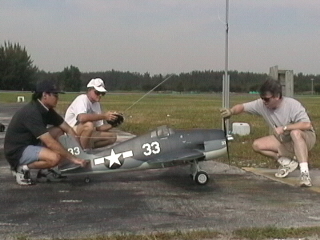

One nice thing is, if you can fly here, you can fly anywhere.
Another nice thing is no trees and, except for a power plant about 1/4 mile away, it's all unrestricted.
Pictures showing looking east, west and north.
Of course the best part is: you never know what you'll see when you come out to fly on a weekend!

Sam ... how did you do your flaps on the Hellcat? I have mine the way the instructions called for but Im not to thrilled with the setup.
Charles
Charles

Sorry on the delay: didn't know you asked me a question plus I've been busy working on my new yellow P-38.
With the weight of mine, she gluides forever so I modified the flaps (some might say butcher!) to get more 'down' in them.
I bought the plane RTF but the flaps hinges were connected so the flaps would not fully deploy.
After re-hinging, the internal ball/socket control rod was binding so the flap would not come down.
The angle of the flap control horn was such that it would just sit there when the servo was thrown.
I left the internal horn on the flaps and added surface control horns (at least you can't see any bolts from the top!).
I then cut a hole in the bottom of the wing near the TE and ran a straight connection between the servo and control horn.
Not pretty but the dark blue hides it and I'd rather have a good flying warbird than a pretty one that I don't care to fly!

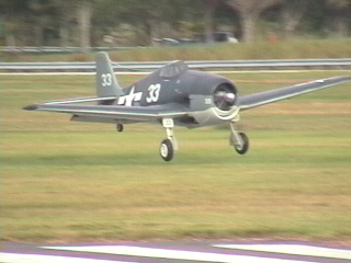

Well ... yesterday I did the maiden flight! All balanced and fueled up it weighs 32 lbs. I couldnt believe it would actually get off the ground at that weight but WOW .... it flew great! After 10 minutes of flying I lowered the gear, came around base to final and dropped the flaps. There was no terrible or even noticable pitch changes with the flaps deployed. Flew her on down close to the runway, flared and she sank right in nicely for a great landing! Even though I had shaking hands and knees ...
WHEW ... glad that flight is out of the way. Taking it back out again this Friday.
Charles
WHEW ... glad that flight is out of the way. Taking it back out again this Friday. Charles
