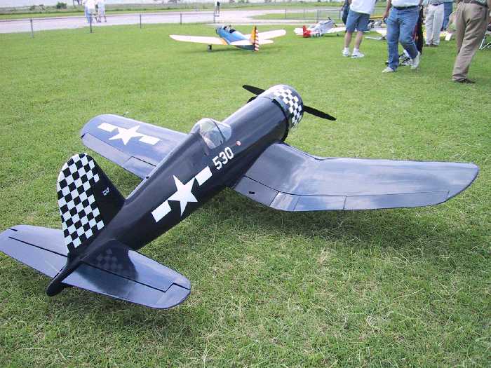

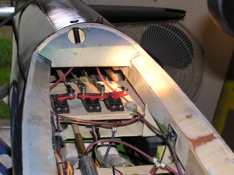

This past weekend I flew my Ziroli Corsair with Brison 5.8 at the HOTMAC Warbird flyin in Waco Texas. During my last flight I pulled into a big loop. All was well until I began to pull out of the loop. I used full up elevator to come out about 10' above the ground. The push rod broke during the loop. The plane has about 60 flights. I used 4-40 rod epoxied into a 5/16" hardwood dowel.
Talk about having a free airplane...WOW.
When I put in new push rods, what suggestions do you have to prevent this from happening again?

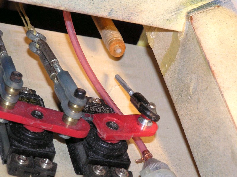

Peter, the steel rod broke near the end of the dowel rod. The dowel did not break nor did the steel rod pull out of the dowel. Your method sounds good but I don't think it will solve the problem other than maybe change the resonance frequency.
A friend suggested a possible fix. Use several layers of heat shrink tubing on the steel rod to build it up near the diameter of the dowel and then put a length of heat shrink tubing over the dowel and the rod. This combo should give a shock absorbing effect to the assembly to keep down the resonance vibration.

paradiserceer, the elevator is separated and driven by two separate servos. Here is a little different view. The elevator servos are on the outside and the servo in the center operates the rudder in pull-pull.

Actually you only need enough build up on the 4-40 rod to allow the the heatshrink on the dowel to be able to grip the rod diameter. The failure looks to be a classic section transition type of failure.
As others have said vibration damping and a higher strength material will also help. Gradual section transition will be the easiest approach.

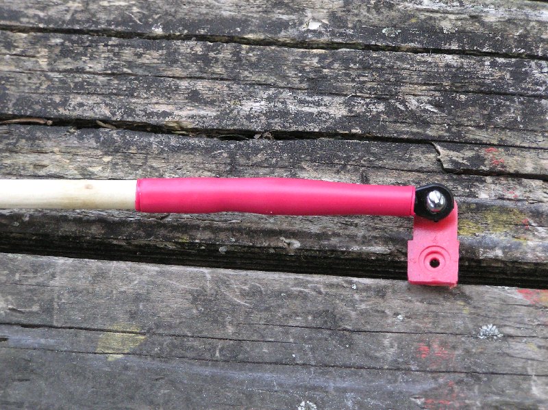

First of all I want to thank you all for the suggestions. There are some good ones. I have no way to get in the fuselage to brace the rod without major surgery. Here is the transition based on Gremlin Castle's suggestion in person. The steel rod area is filled with heat shrink and one layer goes over the ball joint fitting tail end. The final red heat shrink goes over the dowel and over the fitting. I think this will sufficiently dampen the high frequency vibration. I'll do the other side the same way.
