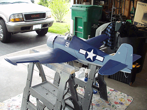

Can water-base Polyurethane be used as a clear coat on a warbird that has been painted with latex exterior paint?
How fuel proof will it be?
Is there something better to use?
Any and all advice is welcomed.
Mike

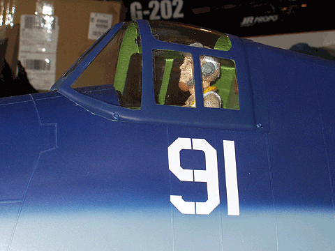

I went out and purchased the Nelson Hobbies Poly Clear Flat w/the additive for glow fuel to put on my Hellcat. I heard from a couple of other builders that this product work pretty well.
