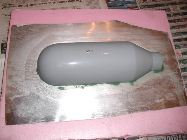

flying a warbird in a scale like fashion is what makes these models realistic. with diving straffing passes, sweeping low turns and victory rolls is what makes flying a warbird enjoyable. one of my favorite things to do is to drop simulated bombs or fuel tanks. in this thread i thought i would show my effort to develop a large bomb that looks something like a 1000 lb wwII bomb for my meister p-47. the bomb will be molded out of fiberglass and although not exact scale shape or size should look good for the plane. i am going to jump into the middle of my project and show how i made a fiberglass mold. when i first started the plug i just took a piece of foam and cut and sanded to shape covered with a heavy fiberglass cloth. i thought i would just put a layer of body filler on the fiberglass sand smooth and prime but this was such a difficult shape to work with to get right i decided to chuck the plug into a metal lathe apply body filler where needed then machine the filler to shape in the lathe. when finished this turned out rather well. i then primed and put a finish coat of automotive clear coat to hold up to the mold making process.
in the pic i cut out of a thin piece of aluminum the shape of the bomb that fits very close to the plug and centered the plug into the hole.

this next pic shows the bottom side of the form. after the plug was waxed it was set into the form halfway and with a hot glue gun the plug was held into place on the bottom for the fiberglassing process. on the top side you will see some green oil based modeling putty applied in the crack to keep any resin from leaking to the bottom.[img][/img]
in the next pic this shows half the mold layed up. i fist used a 1.4 oz cloth with epoxy to make a thin coat without any air bubles. this is a gel coat the finish you will see from the inside. after that i applied 4 layers of heavier cloth for strength.[img][/img]

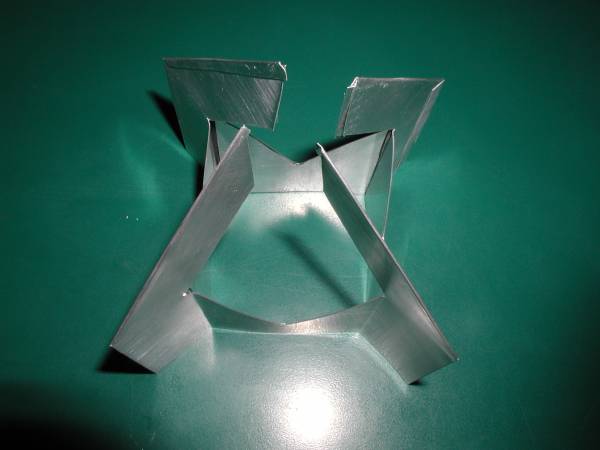

here is the result of a few bomb runs. the last run dropped from a higher altitude pretty much killed one bomb. one thing that worked out rather well was the fins. they were folded out of a thin aluminum and a few bombing runs bent them up a little, but i was able to bend them back into shape rather easily. on my last run i destroyed one bombs fins, but that was my falt. i scribed a line very lightly with a exacto knife and that caused the bends to fail under stress. i plan on molding another pair of bombs laying up an extra layer of cloth on the nose and filling them up with a 2 part urethane foam and then get out for more testing.
