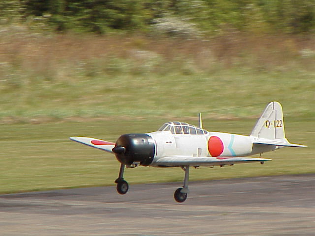

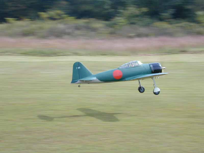

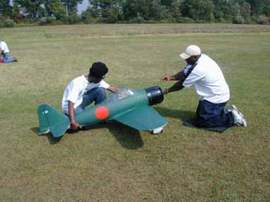

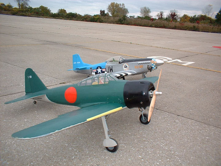

Here is my Ziroli Zero G62 27 lbs and about 4 lbs of lead in the nose .
she really flys sweet!!
