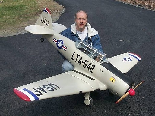

Wow, these guys hit it right on the head. Cant really add much more. I do want to ask whether you built with the single sport flap or have all flaps (including outers). This is important as I have flown with both. The sport flap, to me, has some ground affects which make it a little tricky to get a nice smooth flair. Dont get me wrong, it lands slow and graceful, but I beleive you get a little turbulence compared to having the addition of the outer flaps. The G62 is a great match, I have this setup in mine. Yes, lots of rudder for take off but she is off in a hurry. In the air it flies as great as any sport plane. But as all has stated above, beware the texan bounce! It can be ugly. Not always damaging, just to the EGO.
