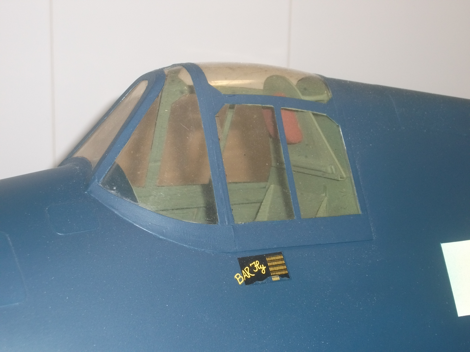

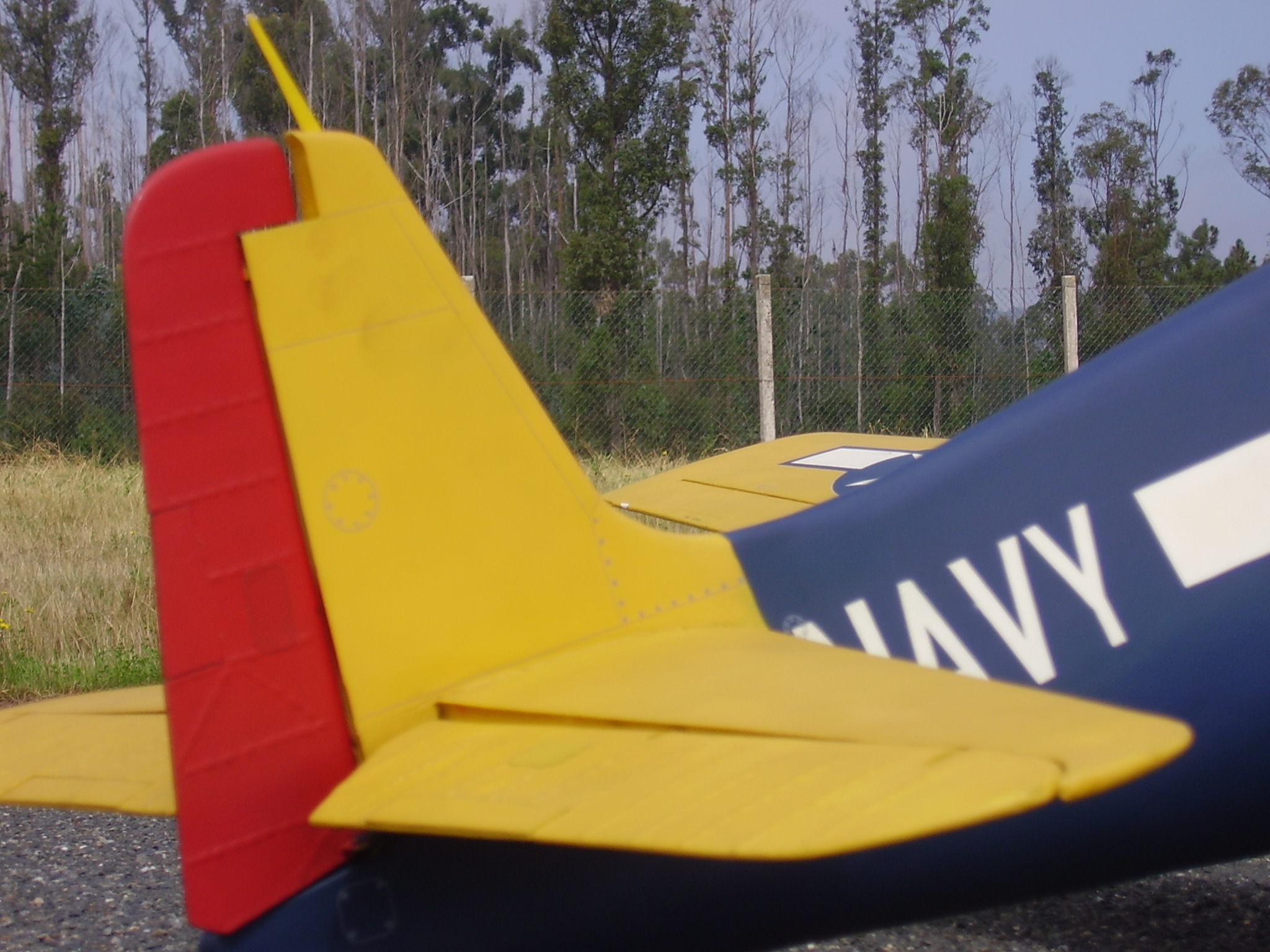

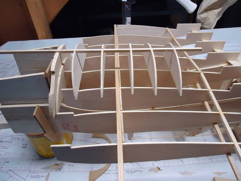

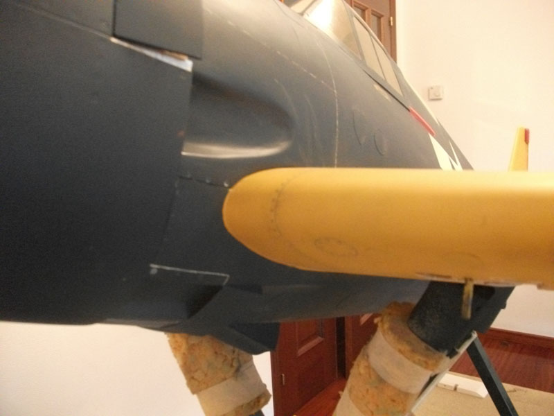

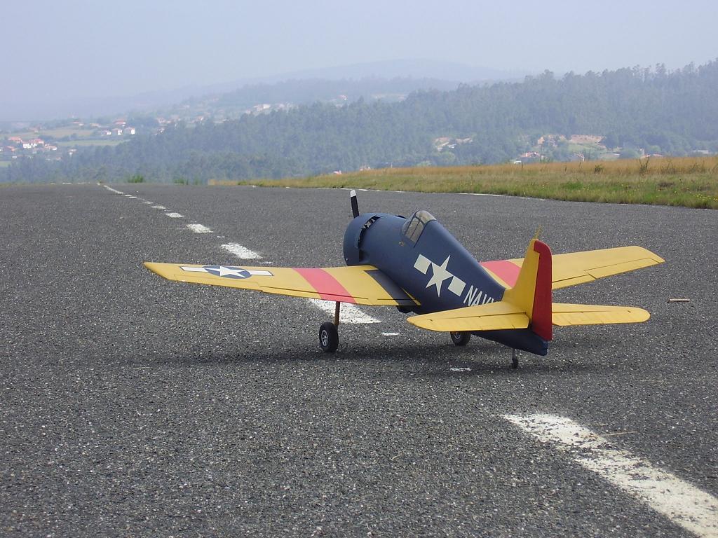

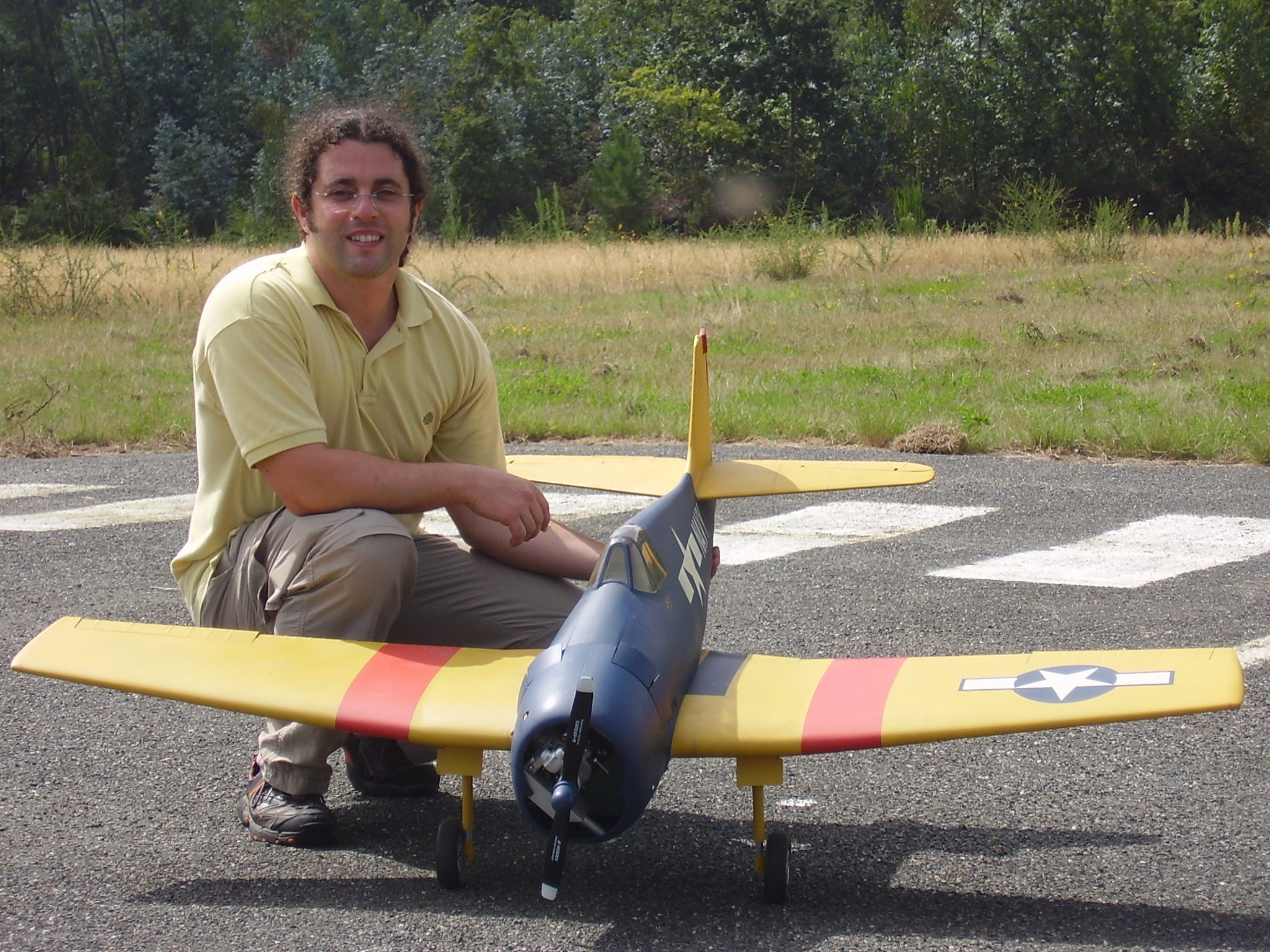

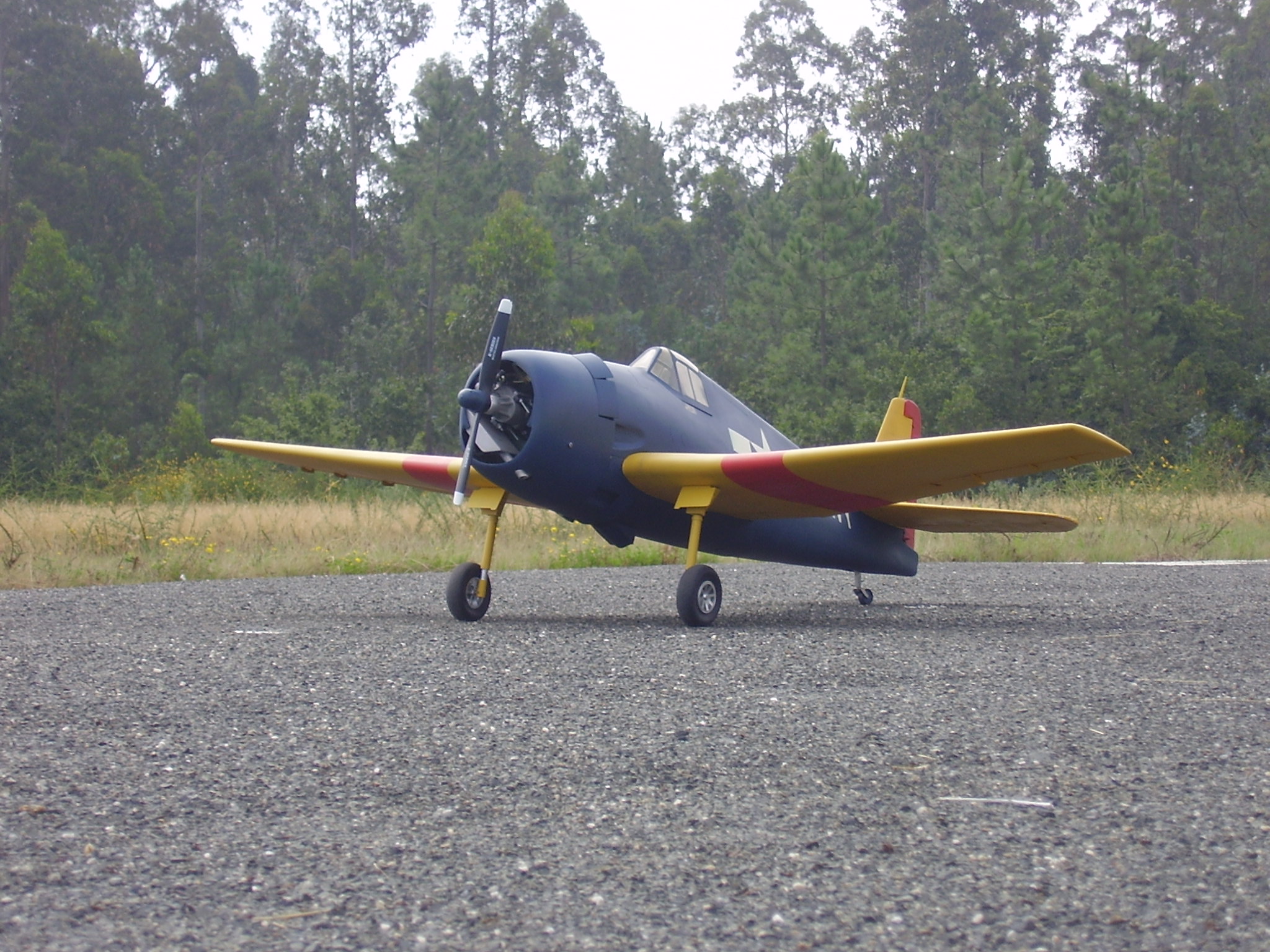

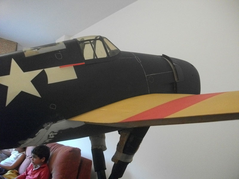

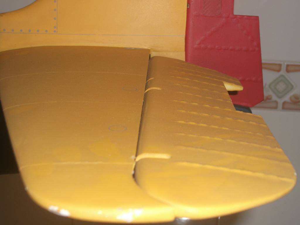

Hello,
I was just navigating that I came across this page...
I built a few years ago the BT 64" Grumman Hellcat. The plan according to Mr. Taylor was drawn from direct measurements of the actual plane that is preserved at a museum in the city of Southampton in the United Kingdom. It has a fixed landing gear and no flaps. In regarding scale details the plan has plenty of information and the fiberglass cowl is of an F6F 5 Hellcat. Unitracts International in the UK sells air retracts for the model.
I think the airfoil is very close to the NACA 23015 in overall with the exception of the leading edge which I would say is more rounded. The wing also has washout of course. With the NACA 23015 and the NACA 23009 in the tips of the wing it would make an even more attractive wing but I think that the scale is too small ...
I have not flown mine yet and at present I am trying to put some detail on it. I will try to post some pictures...I am not the person in the picture...He is a mate from the Club.

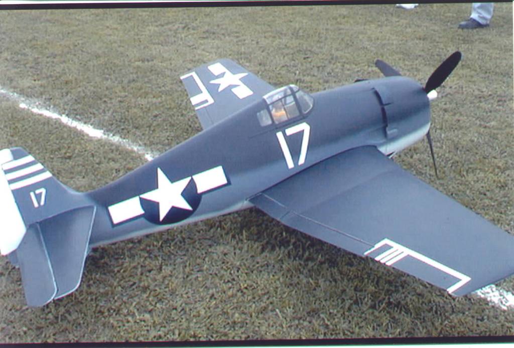

Built one of these several years ago. It weighed almost 13 lbs. Lost it when one gear wouldn't extend and I slowed it too much trying to get it down. I had a set of Spring Air-Rhom hybrids in it and you can't resrtict the air on spring airs going down and expect them to work every time. the plane flew well, but I didn't get near the flight time I should have for all the effort I put into it.

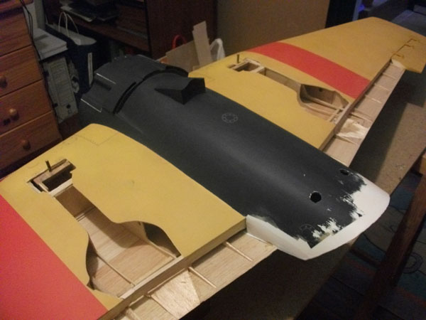

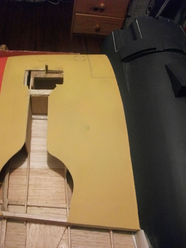

Okay, one of our club members helped me out a bit. I now understand that "U/C" was an old reference to the landing gear. I am putting in retracts so I will need to beef up the wing center section differently from the plans. His advise was to sheet the wing and then construct the bottom fuse pieces (belly pan) and glue to the wing.
Do any of you with completed wings please post a photo showing the belly pan on the wing?

Here are some pictures,

Thank you for posting the photos MarioJuan, these make sense! Meanwhile, I have been building up the horizontal stab and elevator. I'm hoping to be operational by the summer.
