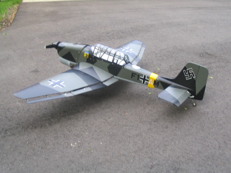

I also have the Great Planes stuka, I have a TT 91 4 stroke mounted in it. this plane fly's and looks great and has no real nasty tendancies . i would also recommend you go with a 4 stroke.

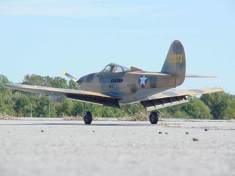

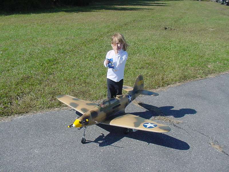

Some time ago I bought a built Top-Flite P-39 Aircobra. It has a S-T 90 mounted sideways in the nose, plenty of power, and it runs great that way. It has air retracts, and robarts struts, which could get a little pricey but look GREAT. And it is one fantastic flying airplane... I fly off asphalt and haven't had to use the flaps yet. And one thing is for sure, you're not going to mistake it's silhouette in the air for anything else.
Andy

All the covering on my stuka is original. the only thing that has been added is the swastika. this plane is real easy to fly and looks great in the air. all i need now is the siren which i intend to buy in a few weeks. I fly off grass and the only problem i had was it kept nosing over, but after bending the landing gear closer to the L/E the problem was solved
