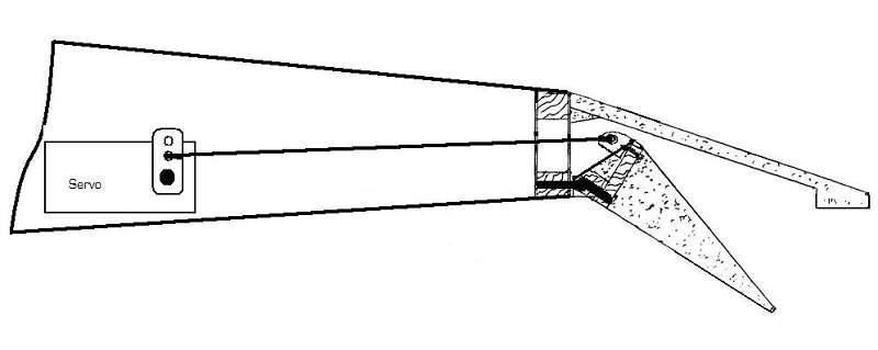

I read in your previous post that you mentioned you installed flaps on this plane. Was this difficult to do? How did they turn out? Can you provide details, and of course pictures would be great!
Posts: 2,071
From: Fairfax,
VA
Its not hard to do. I just penciled in the area to be flaps and cut out the area. Find a 3-view for refference. Trim down the ribs and add stock for hinge mounts. I made the flaps from thin ply with light fiberglass and epoxy on each side. I used Robart hinges and set them at a 90 degree angle when the flaps are closed. Hitec 225's mounted close the the cg. The Zero balloons up when first applied. I have added some down trim to the elevator but not flown since. Probably added 6 ounces total weight or less.

Thanks for the info. Did you do a split type of flap like the "real" plane, or are these full flaps? Not sure I'm familar with the Robart hinges. Are you talking about the "Robart Hinge Points"? Why set them at 90 degrees when closed? I've attached a pic I found and modified which I think is sort of what you are describing. Let me know if I'm in the ballpark with this one.
I think I will fly it without them first, but I am considering putting a Zenoah G26 on the nose and I believe that will make it on the heavy side and expect landings to be rather fast. The flaps are probably going to be a necessity.
Thanks again,
Thanks again,
Posts: 2,071
From: Fairfax,
VA
Yes that is about what I did. The hinge points are out in the air flow like the flaps on a Grumman Wildcat as is the horn. Not sure how the real flaps work but I have had success with this method. When the flaps are fully deployed the hinge is almost straight. Since this is an ARF I just did the servos like the ailerons. It was a quick and dirty job as I had pulled the retracts out while landing and now the bottom shows repairs. They work really well on the two flights I have tried. A G26 is way to much motor for me on this plane and I would guess you will really need flaps. Mine is 11 pounds or so and really likes to float, I had to idle before final and had a long approach-not now. I kept the tail as light as possible, used carbon rods and put everything as far forward as possible. Just a little lead (1 oz) in the front. I can do decent vertical and big loops with a OS108. Flying at 1/2 throttle looks about scale. At about 1/6 scale max speed should be about 65 mph? Anyway it grooves well. If I had time I would get rid of that poor paint and glass the wing.
