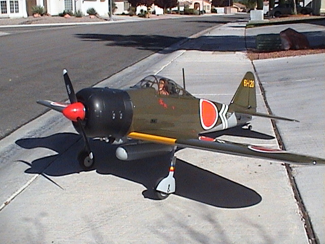

Here's a pic of mine from yesterday. Moki1.80, MA 18x10 prop - performance is great!

Slow speed is very nice - does nice wheel landings. Flaps are very effective at slowing it down for spot landings - lets you keep the power up a bit. The moki has a Bisson pitts style muffler and everything except the two exhaust pipes fits inside the cowl. Replaced the retracts right out of the box with Spring Aires and Robart struts. Very solid.

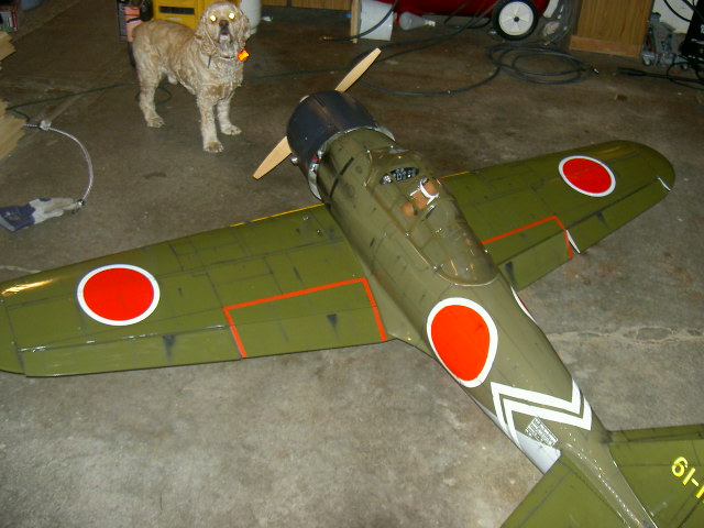

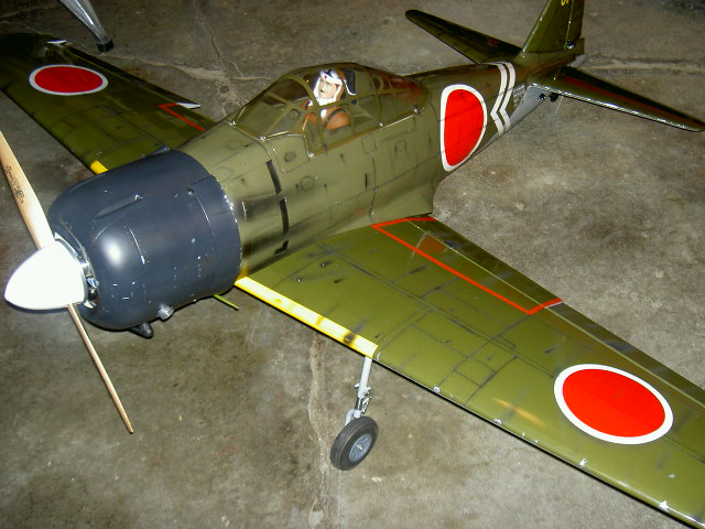

One of my flying buddy's powers his with a Quadra 52. Not over powered and flies very scale with a nice sound. The pics below were taken before he finished the gear doors but it looks great now that he has them finished and installed.

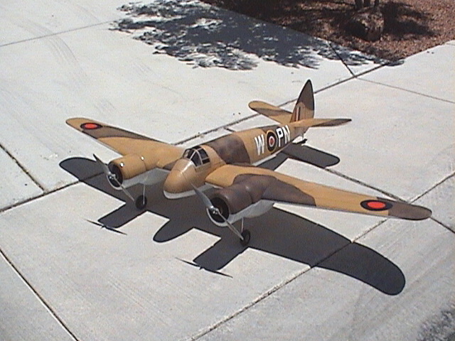

This is just as an aside for this thread but I thought I'd show you what I just finished doing with the retracts that came with the WM Zero. 80"WS, 9 lbs.
