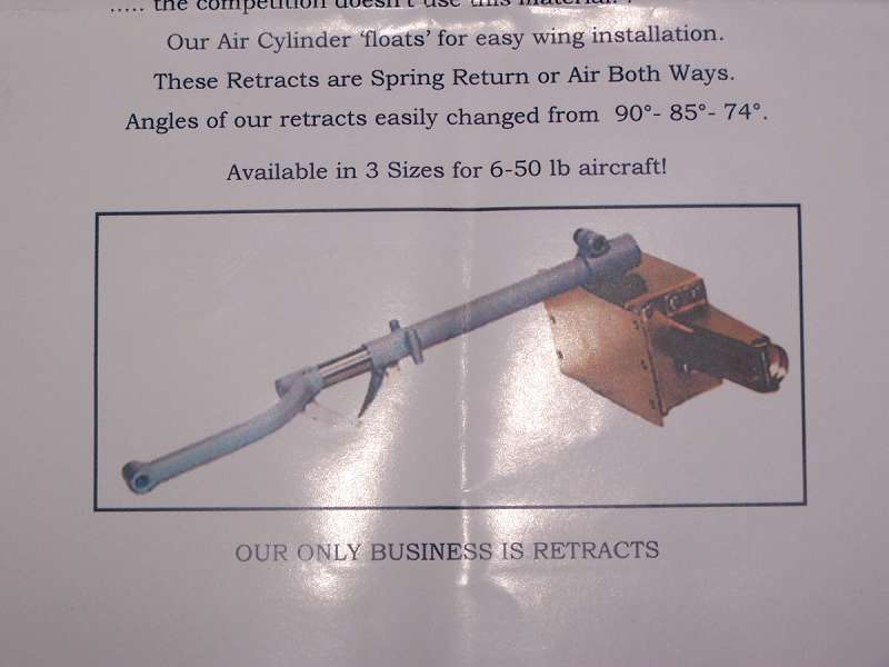

FLASH NEWS! Spring Air has developed a drop in replacement for the TF giant P-47. It includes struts. Looks like the robart except they are all metal. No plastic parts in these retracts and they have the spring air standard "spring down" safety in case of an air leak. I just received an order from them last weekend and there is a brochure in the box detailing the new retracts. I would buy those if I were you. No special mods to make spring air fit. Too late for me, I'm using the 404 and making my own struts. Note: the retracts listed on the SA web site say to use the 403. That is incorrect. The 403 are 90deg, you need to use the 85deg retracts which are the 404.
They also have newer struts that look much better than what I've seen in the past and are pretty much a clone of the robarts, but no P-47 struts. I guess if robart is gonna copy them its ok for them to copy robart. Also have 100deg nose gear now. Looks like they've been busy.

Old 05-16-2005 | 08:04 PM
Posts: 6,204
From: Leander, TX
Default RE: Spring Air system
Heres a picture of the brochure they sent.
Edwin

Edwin,
Thanks for posting the picture. Looks like the strut has plastic coat like Robarts one. But you noted that it's fully aluminium. Did you see the note that "... all our retracts can be ajusted to defferent angels 90-85-74". So I supose better to take 403 set and ajust angel to 85.
Old 05-17-2005 | 12:54 PM
Posts: 6,204
From: Leander, TX
They are not adjustable. If you look at the design you'll see the angle is controlled by the slot and the position of the end points. There is a detent cut in at the ends of travel to lock the struts. Its that position that has to change.
Edwin

I read in Dick Pettit's review of the Thunderbolt that a "jeer" was that the wheels did not go all the way up into the wing when retracted. Would using the 90 degree retracts solve that problem? Also, would the cowl conceal a G-62?
sam
Old 05-17-2005 | 04:48 PM
Posts: 6,204
From: Leander, TX
I dont think 90deg retracts would help. In addition to the problem of the struts being angled outward, it would look like a spitbolt. I initially had 90deg SA 403's and was having a hard time trying to get the strut angle right without retracting too much inside the wing. Thats when it dawned on me they were 90deg. Was hitting the top of the sheeting. SA exchanged them for the 85deg 404's. After looking at the SA replacements I noticed that they also have the wrong struts. Not P-47 scale. Those would work on a P-51. I'm not sure which strut Petit was using so I cant comment. But I do know that if you use a P-51 style strut it'll be hard to get it all inside the wing. Not impossible, just hard. With the P-47 style strut, its much easier.
Edwin
Old 05-18-2005 | 04:08 AM
DMG
Joined: Sep 2004
Posts: 15
From: Moscow, RUSSIA
MAN, too many troubles with 404s. I'll order 403s. Forgive me guys, my retracts will be 90 degree.
