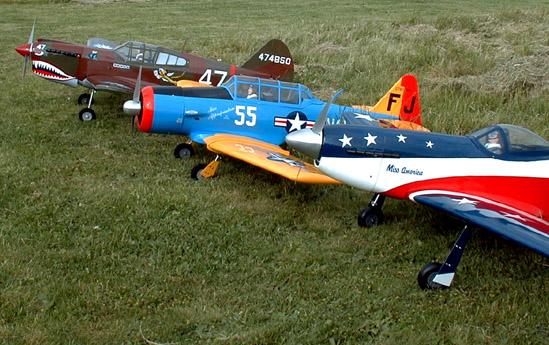

well, I got the WM spit but never managed to have a nice flight with her. Seemed tail heavy, even if CG was as mentioned.
Retract supports collapsed on a landing not that strong. I gave this plane away...
The H9 warbirds fly much better and I never got retract attachment problems (though retracts are weaker)
