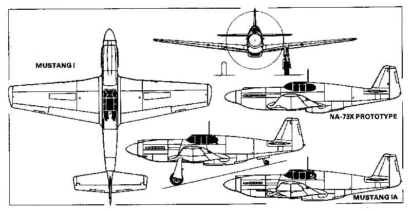

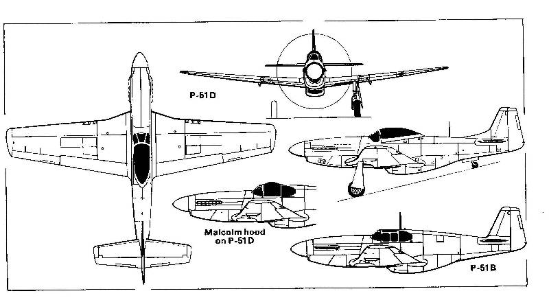

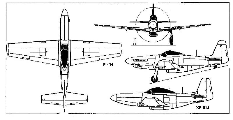

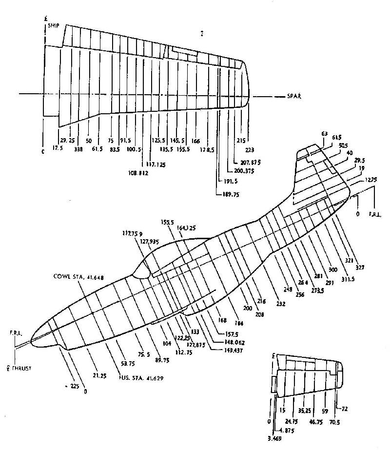

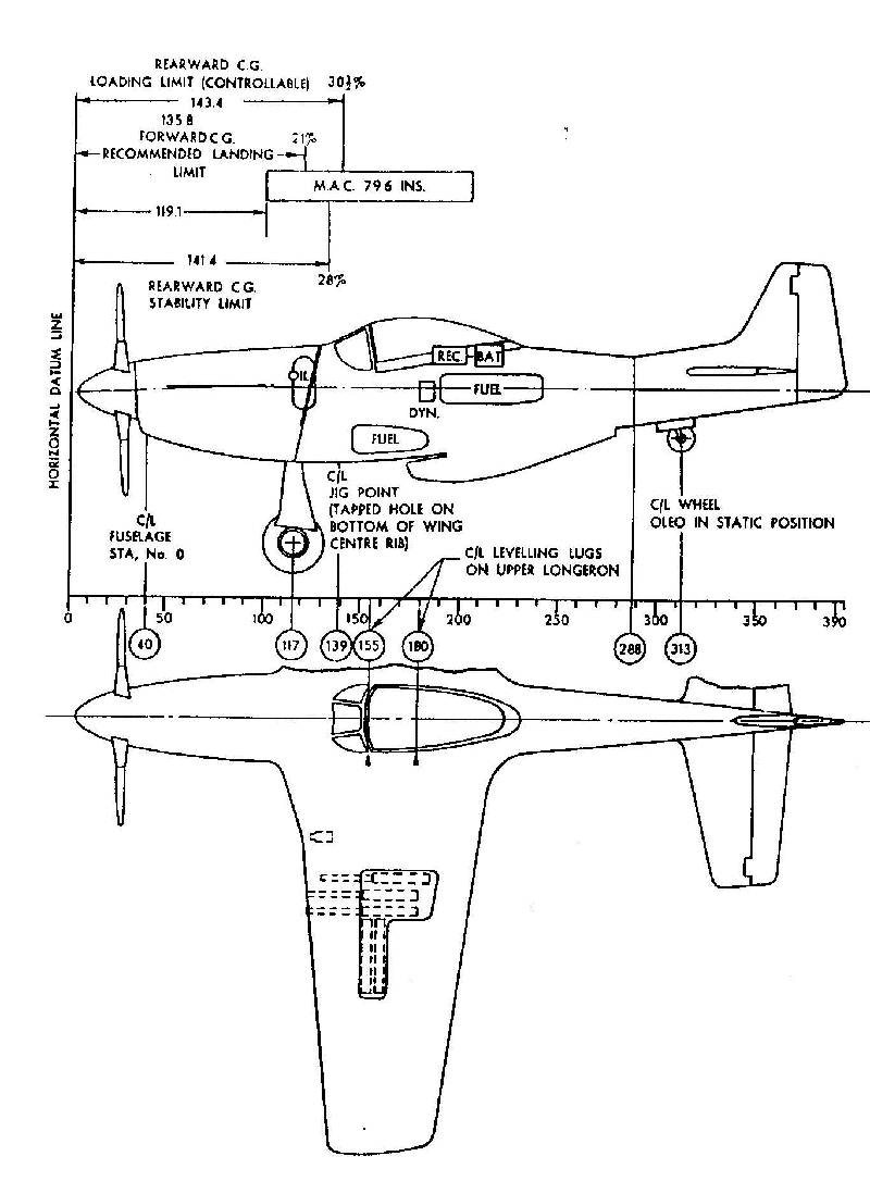

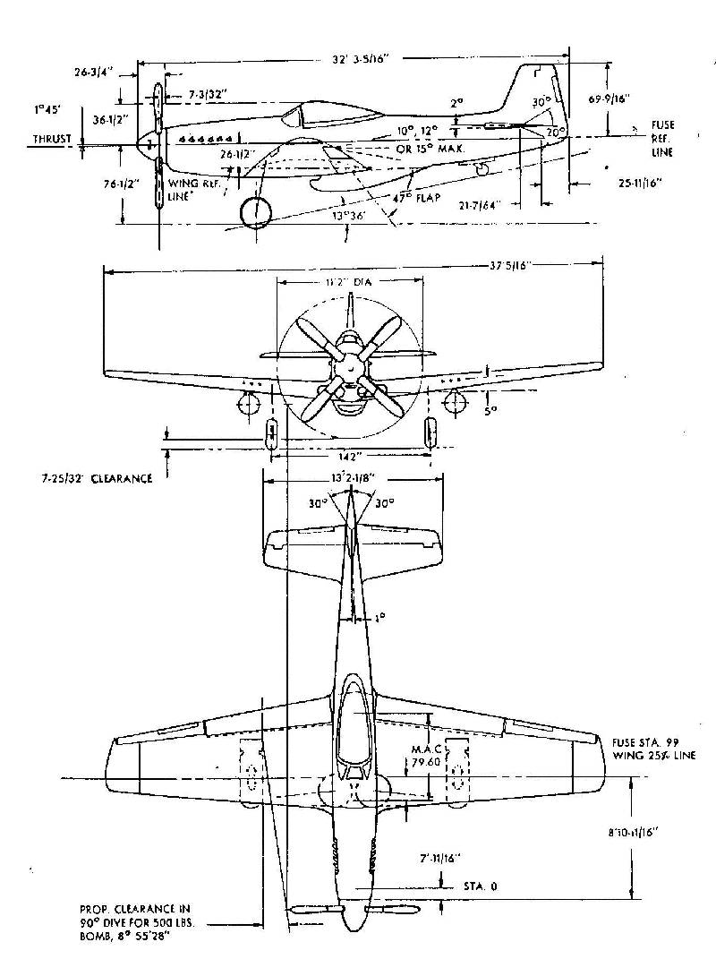

Old 07-31-2005 | 03:25 AM
The Ghost's Avatar
Joined: Mar 2004
Posts: 1,869
From: UlladullaNSW, AUSTRALIA
Default RE: P-51D DATA
Here is some more data.
Cheers

Old 07-31-2005 | 07:56 AM
Joined: Apr 2005
Posts: 78
From: Santos, BRAZIL
Thanks Ghost!
Very nice information! It will be really useful for me!
