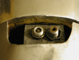

I bought a TF P-51 60 off a guy for my first warbird.
Problem is that I don't know how the air system works. I have an airtronics servo and a Hitec receiver to start with but I don't want to buy a new servo if the air system doesn't work. Help me out here, check the photo below and tell me if this is how it is supposed to go in and if you have any experiance with this system.

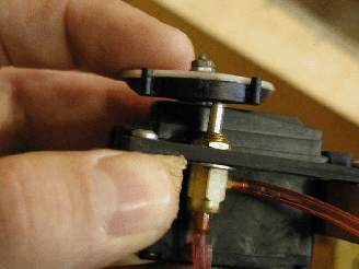

Old 11-22-2002 | 04:09 PM
Posts: 45
From: Alberta
Default How does this air system install
Another pic

Default Spring Air
Gladman,
What you have is Spring Air. You 1st photo is correct just set up
the travel so it just pushs the button down (gear up) and completely off of it for gear down.
Photo 2 Spring Air control valve
Photo 3 The smaller one is the SA filler valve and yes it does take
a special fitting although I've had good luck just sticking the air line in and pumping.
I hope the retracts are SA (gold color) as there are not many with
a one line setup.
Check out www.retracts.com for info.
You might look at the misc. items there for photo's and yours is the older control valve. I like the new one better ( easy setup)

Bomberboy
Thanks for the reply. Just curious about how much the valve needs to move down when the servo goes over it. by the looks of things and playing with it, I think it moves about a hairs thickness. Is that correct?
Old 11-25-2002 | 07:07 PM
Posts: 6,204
From: Leander, TX
I have one of those installed in my P-38. Had a slight bit of trouble with it. The ramp on the disk did not depress the air valve enough to let the air out. I fixed it by putting a piece of 1/16" ply between the disk and ramp and sanded a ramp extension on the ply. Worked perfect after that.
Edwin

Gladman,
No need to chuck the valve at all. Its takes just a little bit of effort
to get it dialed in, then its fine. The only thing I add is the yellow
inline filter to help slow the retracts from slapping the top of the
wing hard.
I use all types of valves robart, UPE, rhom and others and they
all have their tricks. Very seldom is slap it on and go!

Default Valve
Again I say if you are not happy with your setup get the new one
from SA. It is a clippard valve that is VERY easy to setup. It has an
arm with a hole in it for wire and it works like a light switch. The
robart one will work but for SA this is easier and better.
To check each retract to make sure they are sound just pressurize
each retract separately (it will retract) and then let it off and the
gear will come down. If this checks out fine and you do have any
trouble with the valve--replace it.
