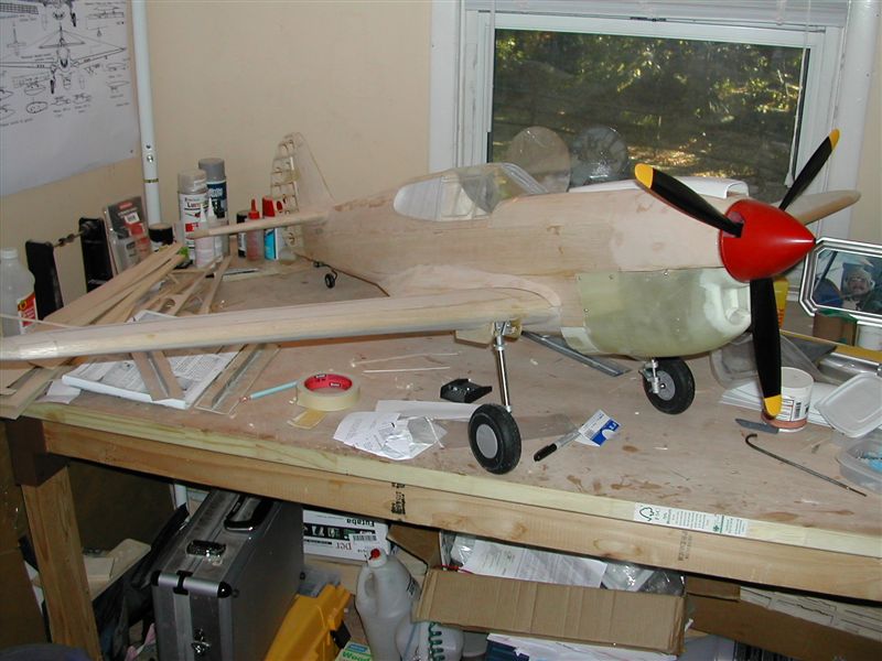

Hi all!
Just thought I share a couple of pics of my progress. Been very slow lately from putting my house on the market and all that jazz. The plane is still in the rough stage as far as sanding goes. Just popped it together for some inspiring pics.
I'm using a RCVsp 120 with a Zinger 17/12 and a Dave Brown Spinner primed and painted with auto paint. I modified the carb intake to be the hi pressure cooling intake diverting the air over the fins of the RCV and then exiting out the usual spot. I will not be cutting out the normal intake so to keep the approximate 1 to 3 air ratio (hi/low). The slight extra weight of this engine seems to nicely balance a normally tail heavy plane (from what I’m told).
I hope at the pace I’m working at, to have this done this summer. It all depends on how/when the move goes.
Doug

I hope it works. Did you do any internal baffling to direct the air over the engine fins only? The old rule is the intake should equal the fin area. That intake lookes a little small to me but lets here how it works out.

Inspiring pics indeed... I have the same kit under my bench and an RCV .90SP waiting for it. Would you mind taking a couple more pics of the RCV with the lower fiberglass cowl removed? I am interested to see how you fit the 1.20 under the upper wood cowl.

I agree its somewhat of a rig, but I think it will function properly, heat wise. The p-40 cowl is pretty much a baffle and I've exaggerated it by hollowing and rounding out the inside of the wooden portion of the cowl to create less obstructions for the airflow. I think that with the prop blast force feeding the carb intake, the low pressure air sucking out, and the fairly high heat tolerance of the RCV, I shouldn't have any problems. My contingency plan is to pinpoint the airflow more over the fins by baffling out the crankcase area of the engine. I'll put it through heat test runs later in the build process and report the findings.

are you going to open up the chin intakes? This was how mine was set up and you would be able to use some baffles to direct airflow as needed quite easily.
IMO just using the carb intake on top of the nose will not be enough.

Yes, If I run the tests and I've got to much heat going on, I'll start opening up and redirecting things. I will first shroud in baffles with thin sheet metal if I have to, dividing the upper and lower part of the fins horizontally to force the air through the fins. I have some options. Thanks for all the suggestions.
