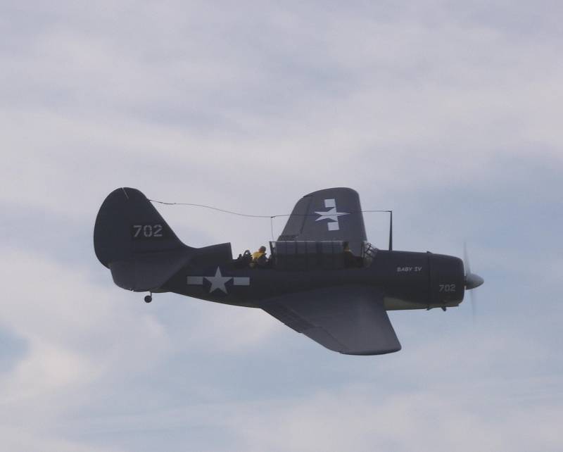

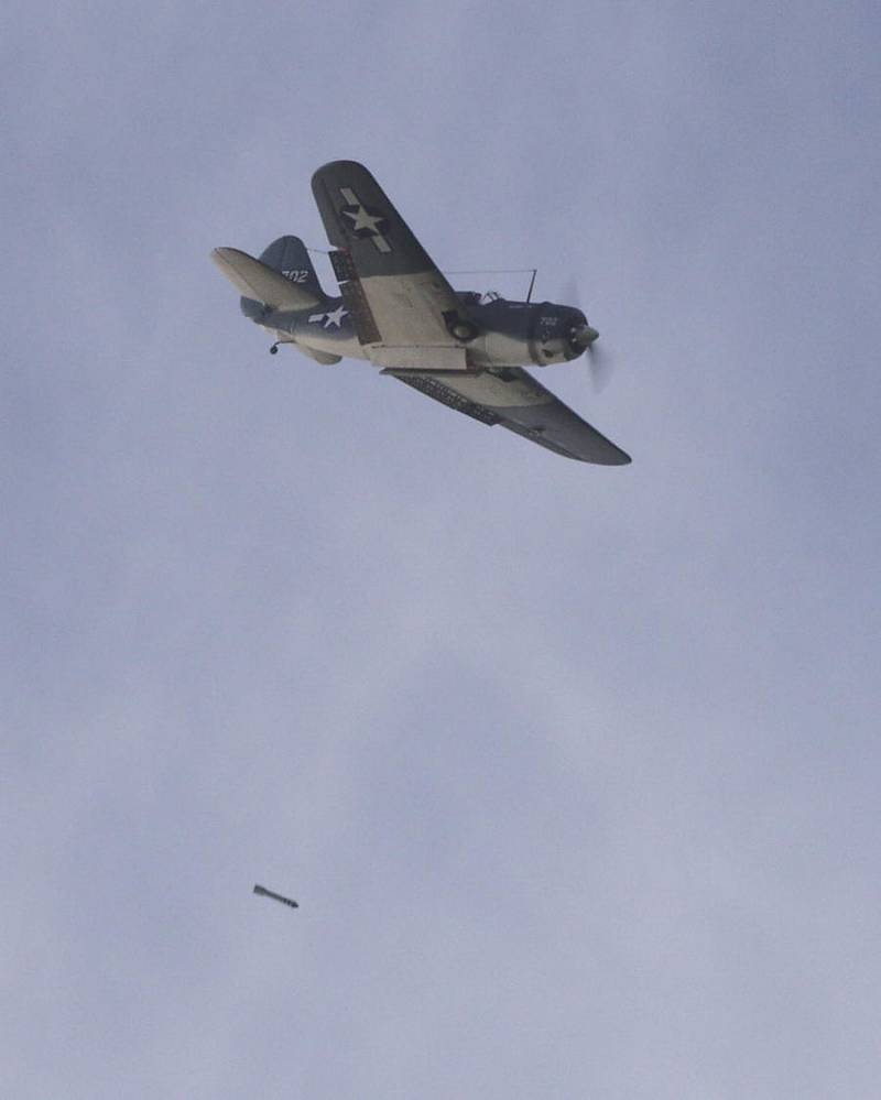

I know that the SB2C Helldiver had a bad reputation during the war, but have discovered that a model version flies quite well. A few years back I started building the 100" Jerry Bates Helldiver, and it's now well into it's second season and has completed 21 flights. I knew a couple other were building Helldivers around the same time, but never heard how they came out. I've only seen 2 others. One @ 1/5 scale which the pilot reported was a bit hairy in flight. The other, a 100" identical to mine. Unfortunately it last only about 6 flights. Has anyone else built Helldivers, and what kind of success have you had? The SB2C on Jerry Bates website, has it been flown?

I've been thinking about building one myself. How did yours build? It looks great! I was going to go with the JB plans as well.

great loking helldiver. i love the rarely modeled aircraft. that thing looks real, barry

Mine built very well. Jerry's plans were very good, though I didn't like his linkage set-up on the flaps and dive brakes. I ended up putting seperate servos in for the left and right sides. With full cockpit detailing and 12 servos, finished weigh is about 40# dry. The G-62 pulls around nicely in the air at about 1/2 to 2/3 throtle; though it's a little sluggish on takeoff. I think a 3-bladed prop would help, I just haven't had a chance to try one yet. I used Bob Holmann's laser cut flap kit, and would recomend it if you're going to replicate the perforated flaps. They are very effective in air, but the plane is very stable in a dive with them deployed.

You have a VERY nice Helldiver. That boy looks fantastic! Kinda makes me wish I had bought the plans some time ago.

The retracts in mine were homemade by a fellow modeller named Carl Bachhuber (Carlb - RCU name) and have worked absolutely flawless.

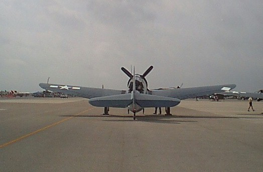

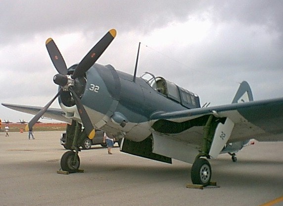

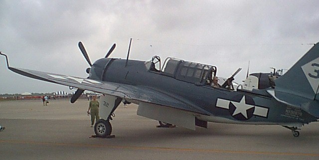

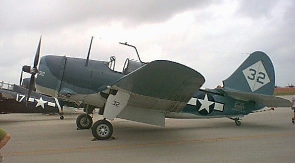

Really nice looking model. You can be proud of that one.[sm=thumbup.gif]
I have been thinking about this bird ever since one showed up at the local airshow a couple of years ago. It's on my "someday" list.

The Helldiver offers many advantages for a scale RC airplane. First off, most any Navy design will offer excellent slow-speed flight, lots of wing area for stability, a round cowl to hide most any engine and that wide track gear is a godsend. Add to that the fact that they're not commonly seen and you have a winner! That full scale is a beauty.

The pix in one of the posts is of the CAF's SB2C...I have spent some time with the airplane and with one of the pilots who flew it extensively about five years ago. Also spent time with quite a few vets who flew it during the war. Best thing that any of the vets said about it: "It had a Curtiss engine, Curtiss electric prop, and it was built by Curtiss: That's three strikes against it right there!" The CAF's version is a bit lighter and doesn't have the electric prop, but is still a maintenance-intensive airplane with relatively unpleasant flight characteristics.
