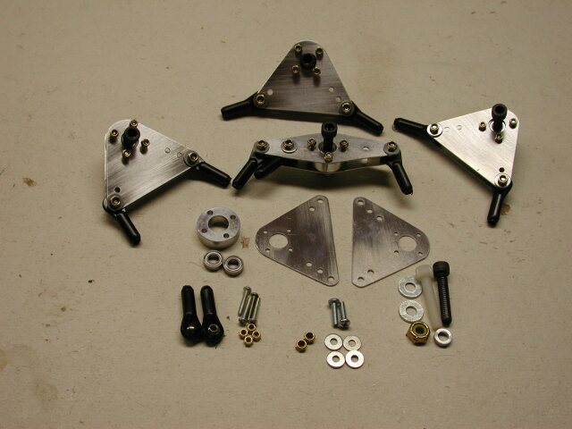

k_sonn's Avatar
My Feedback: (32)
Posts: 2,587
From: Pasadena, MD
Default Ziroli P38 flaps
flying2bill:
Take a look at the bell cranks sold by Nelson Hobby. They are made of T6 aircraft aluminum and use the Rocket City 4-40 ball link. They have two ball bearings that the mounting bolt swivels aroung. They are very strong and slope free. They come as a kit that you put together.

Old 12-31-2002 | 05:45 AM
Posts: 482
From: Central City, IA
K_sonn, those are some cool looking bell cranks, I'll keep them in mind, however I am doing plug in wings so will need seperate servos in the wing panels, Might could use them in my mock p38 trainer though.
