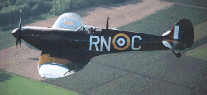

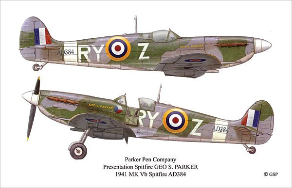

I am putting together a Spit ARF and coming down the home stretch. Just wanted to know how the markings go on the side of the fuse, I have the letters AWZ. What I wanted to know is where does the roundel go I have seen so many different ways I dont know which way to go. Even different from one side to another.

Normally the first two letters starting right below or behind the canopy . Then the roundel followed by the last letter.
Reversed on the starboard side. (One letter then roundel, and the two letters.) But I've seen all kinds of differant markings .

Example .
Which series Spit are you building ? MkI , MKII, MkIV , etc , etc ? I bet you'll get a ton of great photos from all us Spitfire lovers in here .
