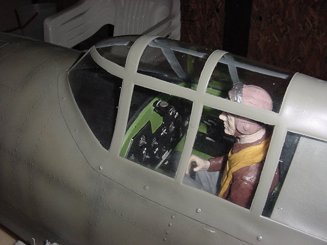

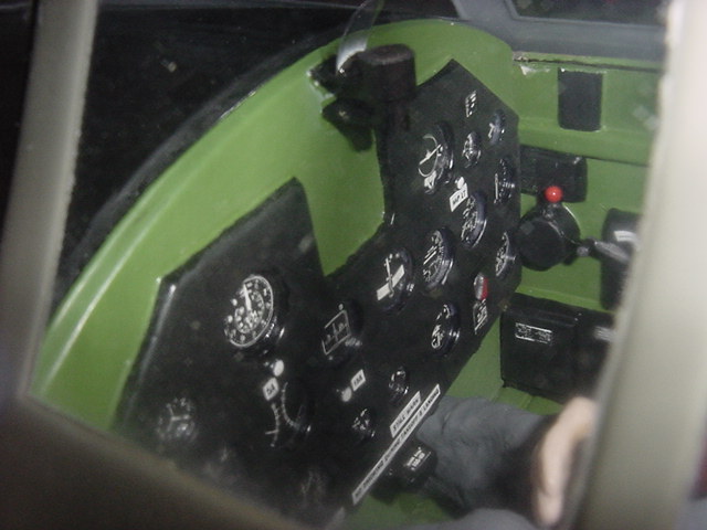

I used the Dynamic Balsa kit for mine and it was a very nice kit.All the abs has to be backed with 1/8 inch ply and then fit and glued in place it takes a little doing but I would buy another in a minute.

Old 01-17-2003 | 10:18 PM
My Feedback: (8)
Posts: 599
From: Paducah, KY
Default P-47D Cockpit HELP!
here's a second pic,it's a little blurry around the sides but it is pretty close up!
here's a third pic.

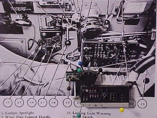

Here are the pictures of the scratch built throttle quadrant. My friend did a great job! I know that he is interested in doing a complete cockpit.
Check it out

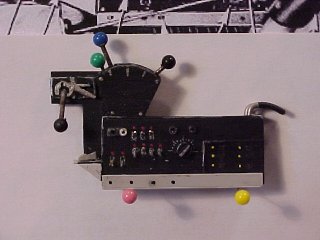

Here's another picture
