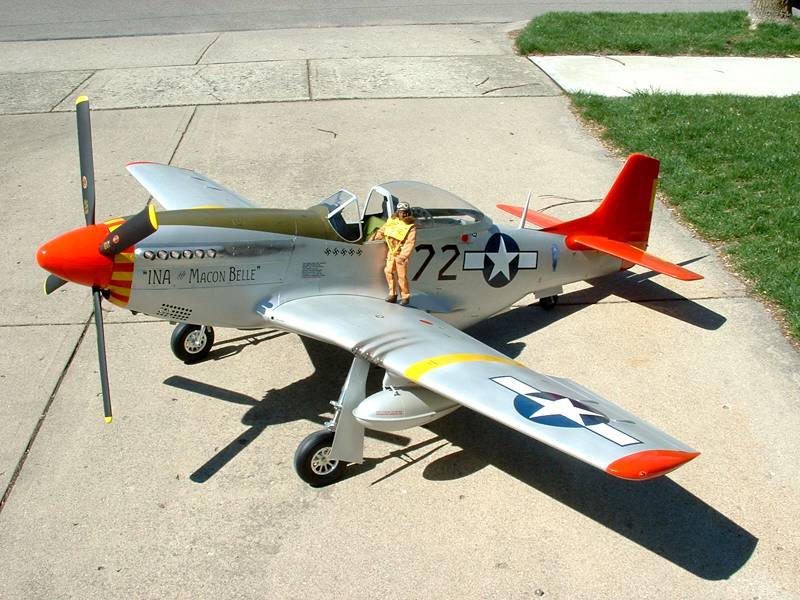

Old 08-29-2006 | 01:46 PM
Posts: 1,336
From: Troy, OH
Default RE: Silver Sandable Primer?
I to have used this paint on my Mustang. Looks great!
