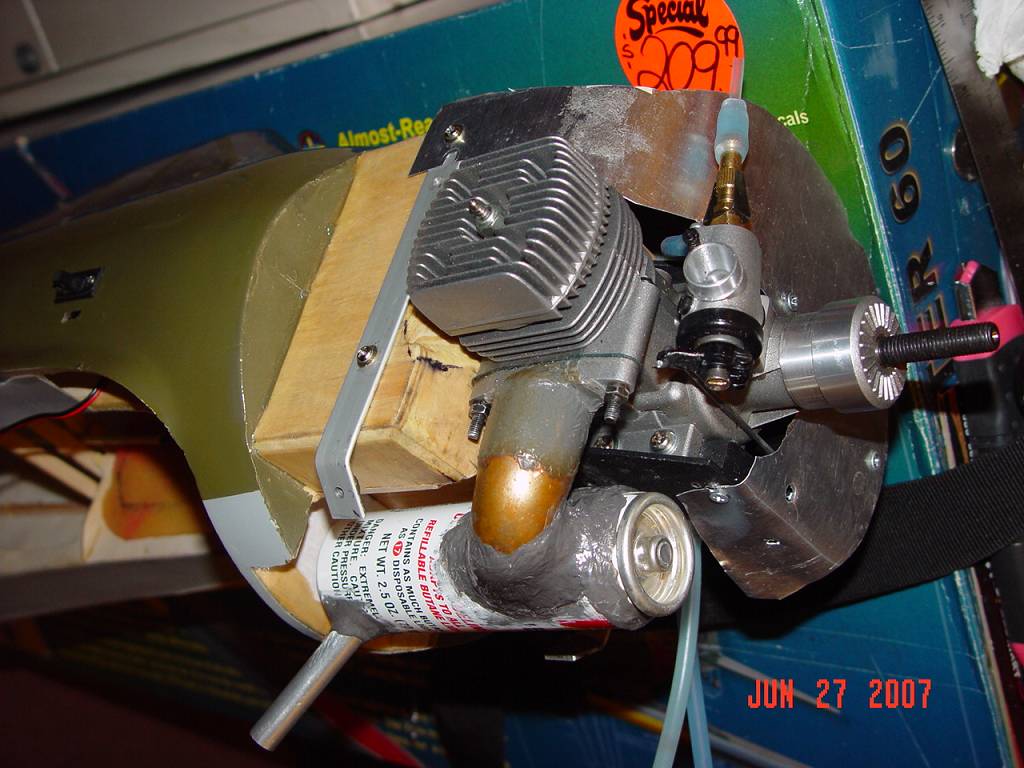

Basil,
There is no cutout for the standard muffler to pass through. If you want to use a standard muffler, you'll have to mount your engine the way you want it, and cut away the firewall in the area where it will pass through. Then build a passage for the muffler and exhaust to pass through.
I just bought the Pitts muffler. With a .61 twostroke on the front, it took something like 13 oz of weight (screwed to the mounting box) to make it balance. The .61 flies it well, but you might want to use something larger, to cut down on the weight you'll need to add.
The retracts are nice, but take them out, and hack out the rails so you can tilt the gear forward. Otherwise it will nose over on landing. Unless you fly off a hard surface, you'll want to replace the easliy bent gear.
Oh, and use the lower end of the elevator travel, or lots of expo. This plane flies well, but is very sensitive in pitch, even when balanced correctly.
Good luck,

Scar,
I have this arf too. I was planning on mounting a Supertigre G90. This engine weighs 25 oz with a slimline pitts muffler. What 60 size engine did you use? I know the O.S. 90 and 60 size engines only weigh about an ounce or two less than the G-90. I was hoping that the G-90 would weigh enough not to need alot of lead in the nose. I am also doing a lot of "remodeling" of this arf to try to reduce the need for added nose weight. I have ripped out most of the wood structure aft of the wing inside the fuse. So far I have removed about 4 oz of weight behind the c.g. Based on your post, this could result in not needing 8 of those extra 13oz's that you added to the nose of your Zero. The fiberglass fuse seems to be strong enough by itself with the longerons only. I feel confident in doing this because my Great Planes GeeBee R-2 has far less wood structure in it than does the WM Zero.
Basil,
Here is another solution to your problem of a muffler that is too long. I don't know were to get the parts to do what is pictured, but it looks like the parts are simple enough to fabricate yourself, Yousif. For example, you could just cut the bottom off an alluminum pop can, drill a hole the same size as the outlet of your stock muffler and JB Weld it on. You would probably also want to JB Weld on an outlet tube that vents the exhaust outside the cowel. Just keep the diameter of the tube the same as the stock muffler outlet to be sure to maintain proper back-pressure. (note : the muffler in the picture was shortened so that it could be mounted backwards for a pusher configuration) I found this picture in the PDF manual for a "Lightning Dart (B2)" flying wing at the AK-Models web site.

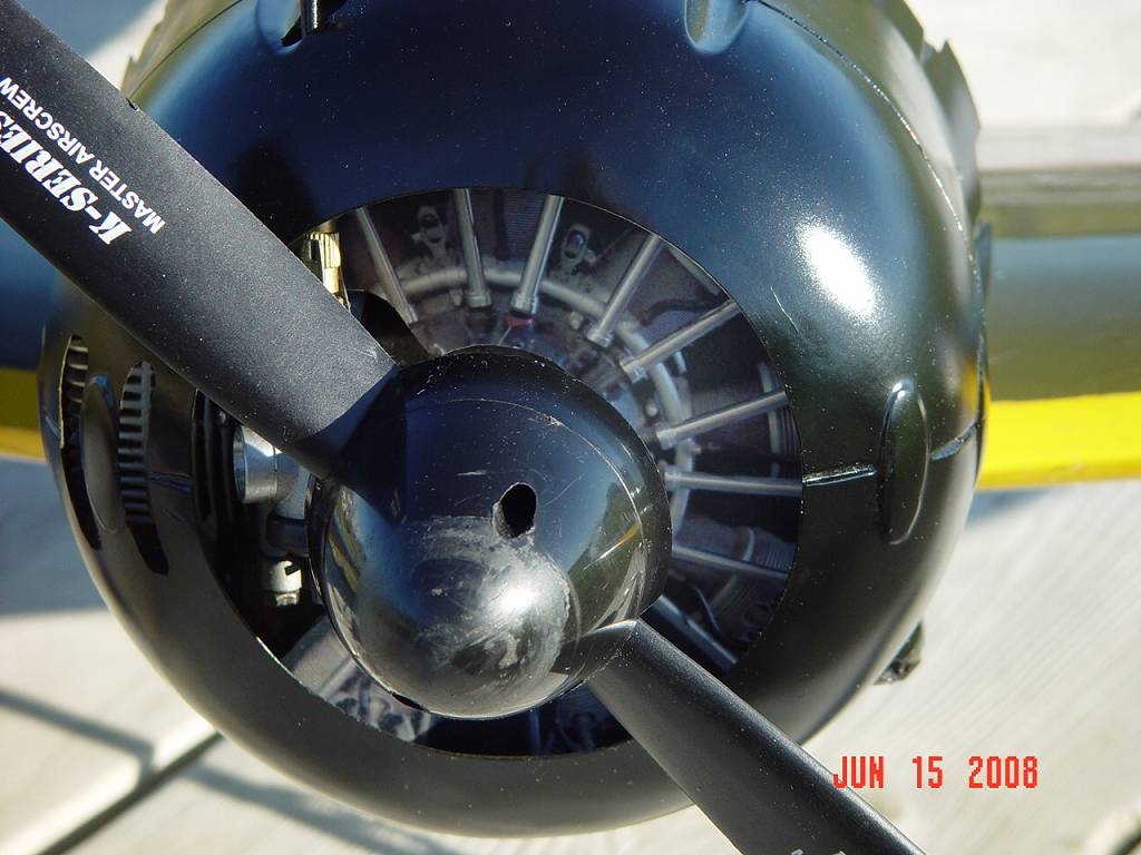

Old 08-18-2009 | 03:47 PM
Joined: Aug 2008
Posts: 5
From: Brooklyn Park, MN
Default RE: World Models .60 Zero - Engine mounting problem
How much of the cowl are you guys cutting out for engine cooling?
Also, I fly on a grass field and it sounds like this models retracts cause nose overs? It this true with flaps and lower landing speed?

Old 08-18-2009 | 06:11 PM
Craig-RCU's Avatar
Posts: 645
From: minneapolis, MN
ORIGINAL: andersonj55126
I cut the front, cowl opening larger. That didn't seem to help much, but cutting a couple of slots in the cowl directly in front of the engine head helped. I've got a Super Tigre G-90 installed. What engine are you installing? There are a couple of versions of cowls too. Are your cowl flaps molded in the open position? If not, cutting them apart and opening them will help. I shortened my cowl by about an inch or so and I cut some slots in the cowl flaps for dummy exhaust pipes for a more scale appearance. An engine baffle helps direct airflow over the engine's cooling fins too. Top Flite manuals on the Tower Hobbies website show how a proper baffle should fit. My baffle may not be close fitting enough to the engine head and that may be why I needed to cut the slots in the front of my cowl.

It appears that you've got enough exhaust area under the cowl flaps. Have you run the engine yet with your cowl on? Did you reply to this thread because you are having overheating problems? If you are having overheating problems, I think a baffle will help. I mounted mine to the engine mount so I could get it behind the needle valve. If you do the same, just keep it tighter to the engines cooling fins like how the Top Flite warbirds do. I've built the TF 60 size P-47 and that baffle works well.
Also, have you balanced your plane yet? I've read that people have needed 11-13 oz of nose weight, but I didn't see any weights in your pictures.
Old 08-18-2009 | 10:44 PM
Joined: Aug 2008
Posts: 5
I have not done the CG yet. But I know it is tail heavy.
I have run the motor without the cowl and am planning how much to cut the cowl. Some people tend to think the cowl needs to be opened up around engine head and extra around pipes on bottom.
Old 08-19-2009 | 02:58 AM
Craig-RCU's Avatar
Posts: 645
Opening up the cowl around the engine head might do the trick, but I've never tried that unless the head is actually too big to fit in the cowl. I don't know how much cutting would be enough. I'd guess that a hole right above the head that is the same size as the head would work.
