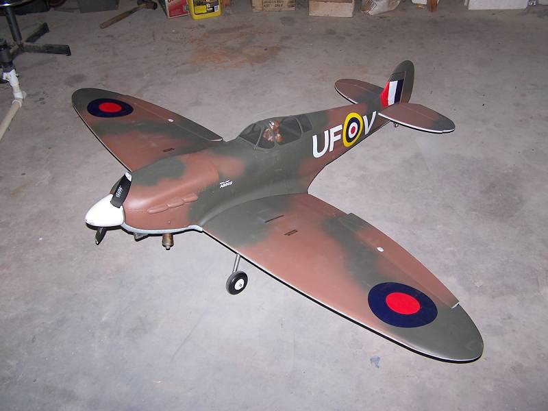

I use spring-air on mine. And on most of the others. I used home made struts on a 3/16" wire plug. You can just barely see it.
Edwin
edit- I had to beef up the mounts also.

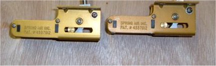

ID:	581754   Click image for larger version

I think he charged me $155.00 for my last set of 704,, 85.deg Spring-Airs. Comes with everything needed for install. Air tank, valves, Ts, hoses, connectors and air line attachments. And a manual.
As Edwin mentioned,,, the 3/16" wire inserts are standard with the units although you can get the 3/8" inserts and use an adaptor. I kinda like the wire inserts for these CMP birds. Bending the wire slightly to get a good fit into the wheel wells is easier than shimming the heck outta the retract unit. Plus it's better to bend the wire after a hard landing than a strut.
There are better custom built struts out there for sure. But I've never found anything better in a retract unit than Spring-Air. At least for these lower priced CMP kites.
