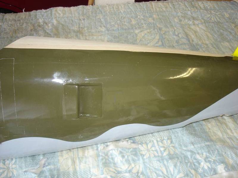

I've just started on my giant Hangar 9 P-47, and have decided to do some cosmetic surgery. I'm converting it to a Bubbletop version.
Seems like this might be a useful thread for those who want their Hangar 9 Jug to look a little different than most of the others out there.
So far the process has been very simple, with no surprises hiding under the Ultracote. This kit is well-designed and well-built, which has made the mod go smoothly.
Please don't expect me to have a finished model in two weeks. The bubbletop mods are going very fast, but I'm going to put some time into the new finish of the model. It may take me a couple of months to get it done.
Now, on to the photos!

Step 1: strip off the Ultracote from the razorback area. Feel the sides to determine where the convex fuselage either flattens or turns concave, and mark those locations with a Sharpie. Use a straightedge to connect those marks, then mark another line about 1/2 inch outboard / downward, then cut the Ultracote at that line.
Step 2: cut through the sheeting at the first line you made in Step 1, and peel away the sheeting. Try not to completely destroy the sheeting, as it will come in handy in a few steps. Notice the spine that's built from T-shaped plywood and a balsa cap.

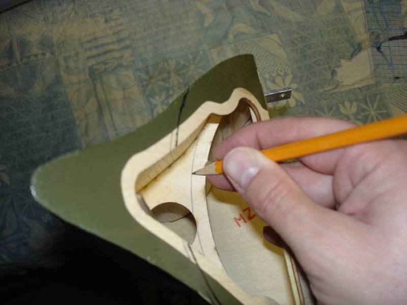

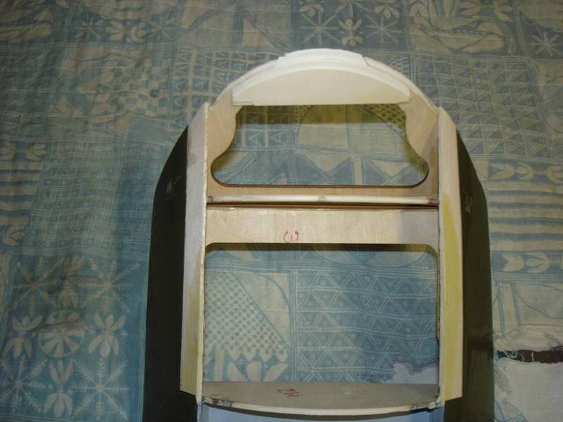

Step 4: using a pencil, draw a curved line on each bulkhead as a guide for cutting and sanding the bulkhead to its new shape. Hangar 9 has conveniently made the bulkheads ring-shaped, which gives the modeler an easy reference for drawing this line. For this kit, the line doesn't have to be extremely accurate. Plus or minus 1/16 might even be close enough at this stage.
Step 5: using a razor saw, cut away most of the excess bulkhead. Don't cut right to the line at this point.
Step 6: use a dremel tool with a sanding drum to carefully sand the bulkheads to the line created in Step 4. A sanding block may be used to check the relative curvature of each bulkhead and to do any final touch-ups.
Step 7: use the sheeting removed from the Razorback to mark a series of points on the forward, angled bulkhead (at the hatch cutout). This could also be done with a stiff steel rule, but I didn't have any of those handy. (No crude comments here, please)
Step 8: again using a razor saw and a dremel, remove the excess portions of the angled bulkhead.
The results to this point should look something like this last photo, with all four bulkheads appearing nicely rounded and ready for the next steps.

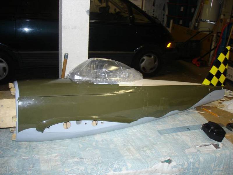

The Aerotech canopy appears to be the right size. Their kit wingspan is 82", while this one is 81 1/4. For a standoff scale kit, that's close enough.

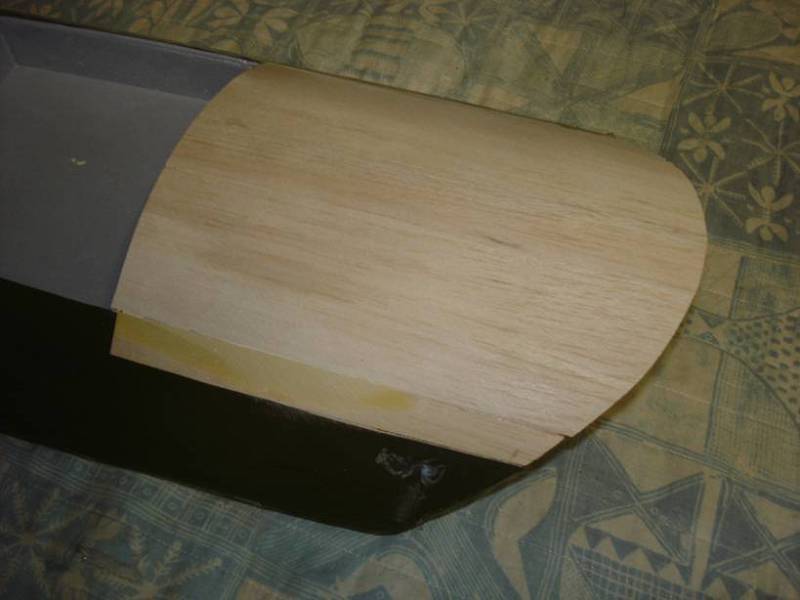

Step 13: Place the hatch on the fuselage and trace the outline of the new aft fuselage shape onto the angled hatch former.
Step 14: Again using the inner contour of the former as a guide, draw the new contour for the second hatch former. Note how I'm using my middle finger as a jig for keeping the pencil tip the same distance from the inner contour of the former in question. This is a simple but effective technique I learned from an old-time NASA Dryden sheet metal shop technician.
Step 15: Use a straightedge to help mark the new shape for the forward hatch former, which is actually the aft cockpit former.
Step 17: Make a rough cut through all the formers using a razor saw, and through the balsa sheeting with an X-Acto knife. If you do it right you can remove the razorback in one piece.

Step 18: Sand down to the lines you just drew on each former using a Dremel tool with a sanding drum. Note that you'll have to create a new set of lines for the aft, angled former, parallel to the ones you drew previously spaced at about 1/8 inch.
Step 19: Fill the gap in the angled former using 1/8 inch lite ply and sand to the proper shape. Through Steps 18 and 19, a sanding block should be used to ensure you're keeping the rounded contours smooth. I used a sanding block for all the final contouring, especially as I was getting the angled former to match the new of the fuselage.
Step 20: Install stringers from 3/16 inch square balsa to assist in sheeting the hatch. I used 2 inch wide, 3/32 inch balsa, because that's what I had laying around. If you have 3 inch wide stock, you can get by with a single stringer down the top center of the hatch. No need to build a load-bearing spine in this section if you install stringers.
Step 21: Sheet the hatch, sand to final shape. Be sure to leave enough overhang past the angled former!
Your structural modifications are complete! Wasn't that easy? You may now re-cover the aircraft as you desire. The last step will be to glue the new canopy in place using RC 56. I won't get to that step for a long time. If you want to see how it turns out, you might want to subscribe to this thread so you'll get a notification by email.

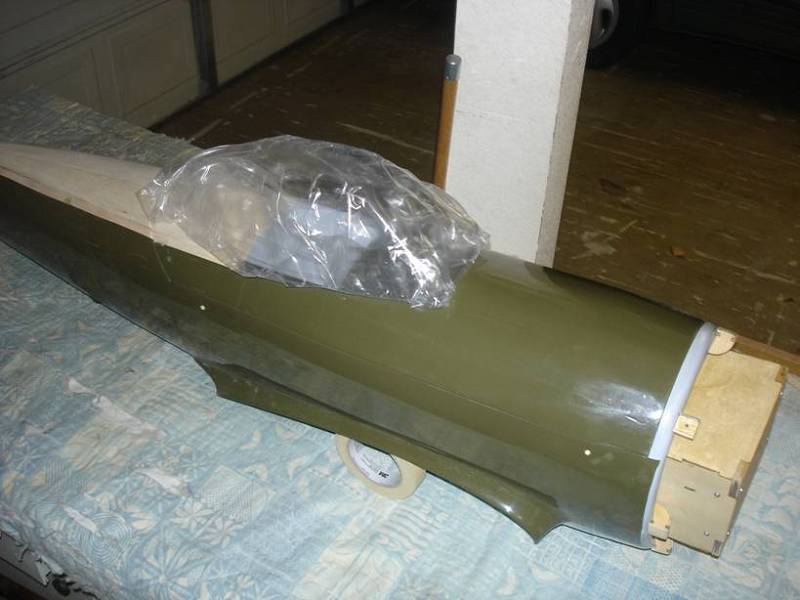

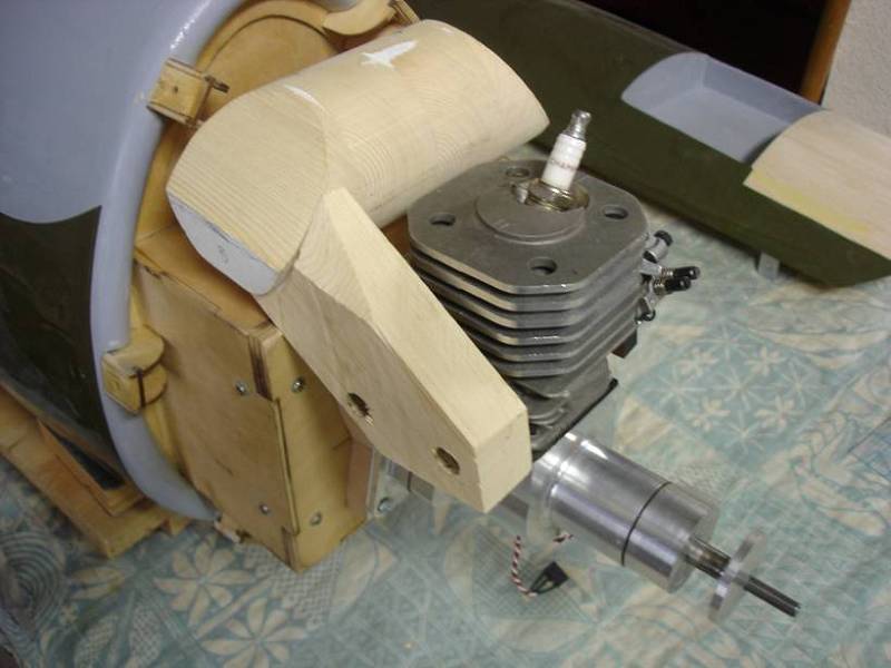

Since I can never wait to see how a new project is going to look, I had to get out the canopy and hold it in place.
This is an Aerotech canopy, and it's untouched at this point. Once it's trimmed to shape, it will rest about 1.2 inches lower than seen here. Once you make that visual adjustment, it looks like it's going to be perfect for this kit.

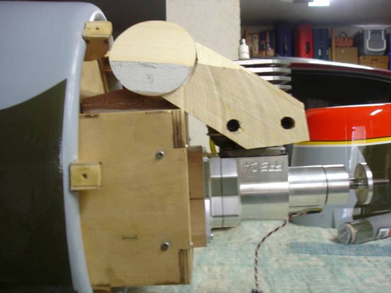

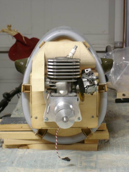

The next shot shows the FPE 2.4 I'm going to use for power, and approximately where it sits in relation to the firewall. Yesterday I built a mockup from lite ply and Styrofoam then sent it off to JTEC for them to build a custom muffler that will fit entirely within the cowl. No giant holes in MY cowl.
Last, I can't take all the credit for this mod. I had a couple of little helpers along the way.

Here are some updated photos.
Turns out Al at JTec needed a mockup of the muffler itself, not the engine cavity! Here are some shots of the mockup I made out of scrap wood laying around the garage.
My Feedback: (17)
Join Date: Jan 2002
Location: Greenwood, IN
Posts: 662
RE: H-9 Giant P-47: Bashed to a Bubbletop
And here are some shots of the finished muffler from JTec.
This custom muffler was only $119. I'm really happy with the result! Notice how I didn't have to hog a huge chunk out of the engine box.
I still have to trim the exhaust tubes down about 3 1/2 inches.

Wow, it's been a long time since an update! Can you believe I'm still working on this project? It's been set aside for a couple years since moving to the Midwest. I got a bunch done over the recent Christmas break, however, and I'm hoping to have it done for this year's flying season.
The whole airplane has been sprayed with Chrome Aluminum Krylon and buffed panel-by-panel to give an awesome aluminum appearance. Thanks to Bob Frey for sending me the instructions for how to do this. I'm halfway through painting the invasion stripes at the moment. I still need to paint the cowl, paint & install the cockpit kit & dummy engine, and move on to final assembly. I'm sticking with the 353rd Fighter Group scheme I posted 3 years ago in post #8.
The FPE was sold with the muffler, and I've gone for a Saito FG-36 instead. This required cutting a couple inches off the engine box and installing a new firewall. I work for Horizon now so I had to go with one of our house brands.
If I can get it done, I'm toying with taking it to the AMA Scale Nats this summer. I've never competed, so I'm pretty sure my legs would turn to jello and my thumbs would shake uncontrollably during my first flight round!

So this is resurrecting an ancient, crusty thread.
I finally finished my airplane. It didn't actually take this much work, I just didn't work on it for so many years.
Finally settled on a G45 for the engine. I figured the FG-36 was going to be anemic compared to what I'm used to now. Luckily the firewall mods to fit the FG-36 worked out perfectly to mount the G45. I also fitted some Robart air retracts instead.
