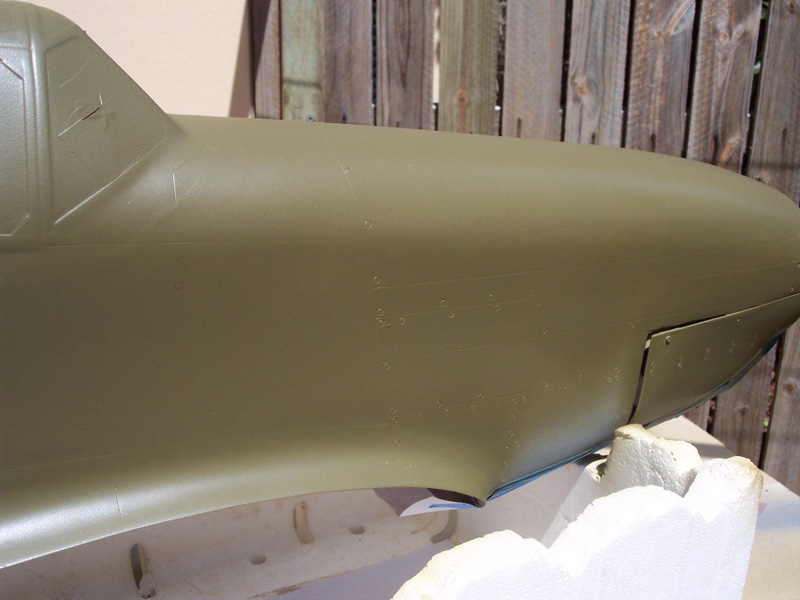

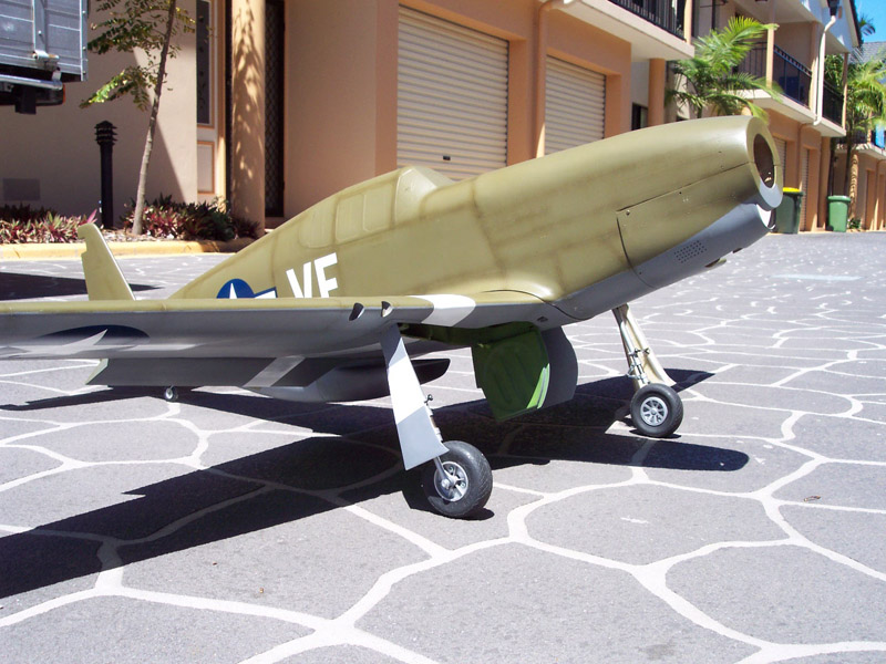

Here are some pic's of my 1/7 scale p-51 im working on using the chartpak tape.
I'm sure there will be some more people to give you some mroe ideas. there is more than one way to skin a cat, you just have to find the technique that works best for you.
thanks

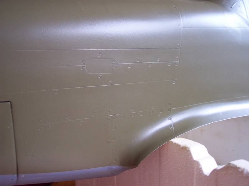

If the plane is already glassed, painted, or covered, you can use the cheap method I used on the planes pictured in my gallery. All I used was a pencil, a black and silver marker, and spray urethane from a can. It took some time, but really gets noticed on the flightline and in the air. Paul
