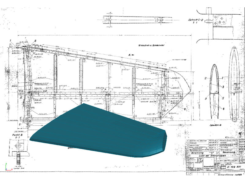

Hi everyone
I am from Bulgaria and I started to build plane Massterschmitt 109 Emil 4
The drawing from aeronautica.de
This is drawing

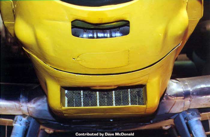

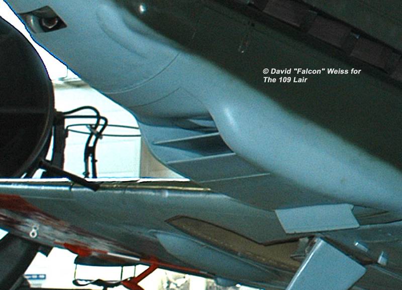

I have a little problem, I have no drawing or pictures of under site of BF-109 E,between the wings.Do anyone have?

Fokke Check here http://www.rcuniverse.com/forum/m_32...11/key_/tm.htm For info on the bottom of the 109. Tubig is doing an awsome job on the BT 109.

ORIGINAL: fokke
Hi guys
Hi Fokke!
Here are some photos ( a few ... ) with underwing section and drawing.
Continue in searching ...
Your's
Jimmy

Jimmy this is exactly what I need
Now I can to make the rivets
Thanks guys

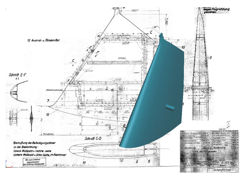

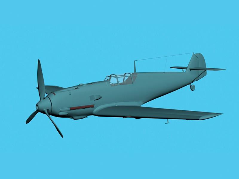

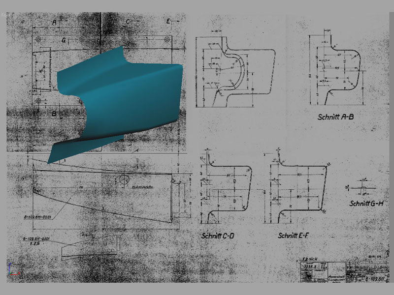

The best 3D pictures which I have are this
