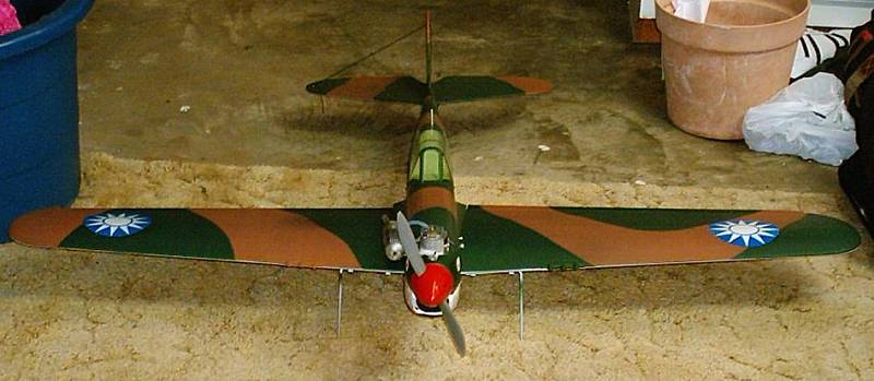

I am finishing up a 40 size Wing Mfg P-40b. Had originally planned to fly it with an OS 40 LA and a 10x6 prop. Put her on the scales last night and looks like it will end up at 5 lbs. dry. The engine is mounted upright. She is fiberglassed with PolyC.
Will this be enough motor for this plane? Any and All opinions would be appreciated.

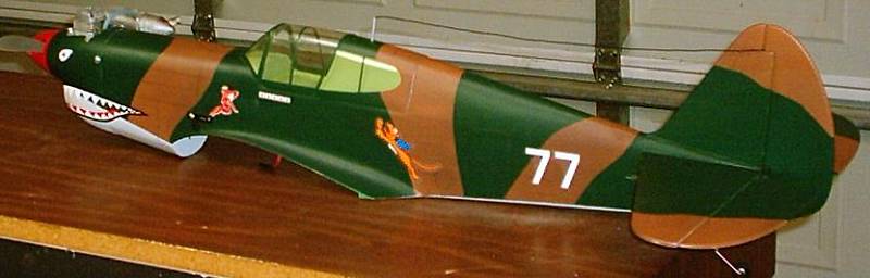

fuse pics

Thanks for the responses. I barely had room to fit the the LA in there. Keep in mind that this is an extremely sport scale model.
Wing loading will be just under 22 oz/sq ft with 550 squares. Wing calls for this plane to take a 35-45. I already have a Tower 46 that I could use. Still think I should pull the LA and go with the Tower?

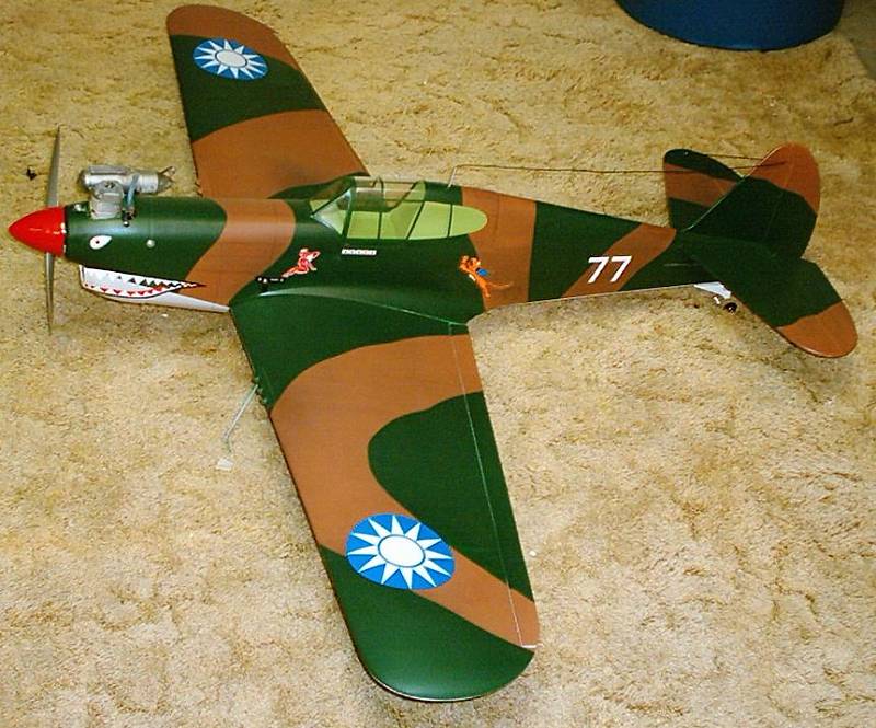

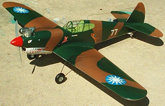

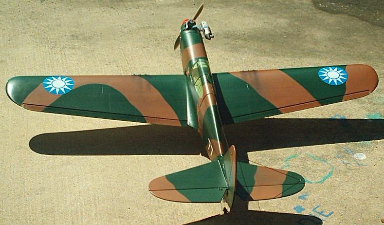

Couldn't resist. Just had to see what she looked like altogether

Finished up the wing last night. Then put it on the scales. Bought some new and I hope more accurate scales last night. Came in at 5 lb and 5 onces. With all equipment but with no fuel. I used an 8 once fuel tank.
Now I am a little worried. Will the LA 40 get her off the ground? Keep in mind that I want to keep her mild as my original objective when I started this model was to have a cheap and mild warbird that I could practice takeoffs and landings. I have a Tower 46 in another model that I could swap but really don't want to. Do you guys think it would even be worth my time to try the LA 40 first or just make the swap eventhough I dont want to?

Well after getting her all assembled, she came up a little tail heavy so that made it easier to decide to go ahead with an engine swap. Last night, I pulled my Tower 46 out of another model and got it ready to go into the P-40 this afternoon. Since I had to add weight and she was already on the bubble for the 40, I might as well make good use of the weight I have to add. So my TT GP 42 went into my Sky walker II and the 46 is going into the P-40. She will also get a MAS 11x6 to go with it. I made the LG legs about a Half inch longer so should still have plenty of ground clearance. The tail wheel is also a little taller than called for so she sits pretty high. I will take some finished pics before trying to commit aviation just in case so that I can load them up here. If the wind cooperates, tommorrow will be the day. Forecast is for 10-15 out of the South which should put it right down the runway. A good wind should make takeoff and landing a little easier.

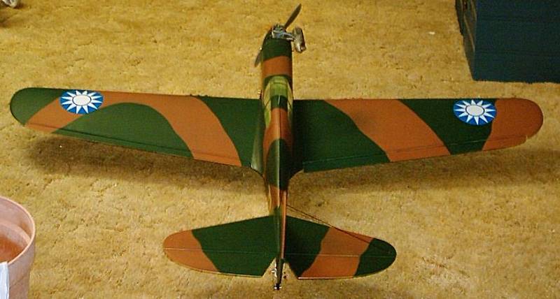

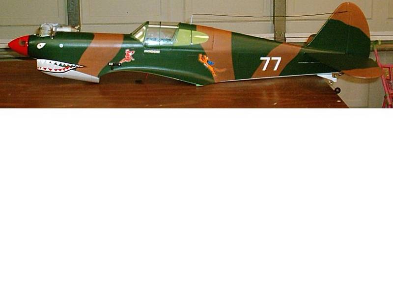

Took her out to the field today but didn't put her in the air. With 15-20 mph slight crosswind and an inner ear infection I just didn't have the feel for it today. Final AUW dry after changing engines and adding 6 onces lead in the nose was 5 lb 12 onces. Still not bad considering all the extra detailing I did. Here are some finished pics I took before swapping out the engines. If you look close you might just be able to make out the panel lines. Hope to get another shot at it next week. She turned out so pretty that I want to have the best chance of success as I can.
Jim
Old 03-18-2007 | 11:10 PM
Joined: Aug 2004
Posts: 763
From: NEW BOSTON, TX
Default RE: Engine for Wing P-40b?
Forgot the pics.[X(]
