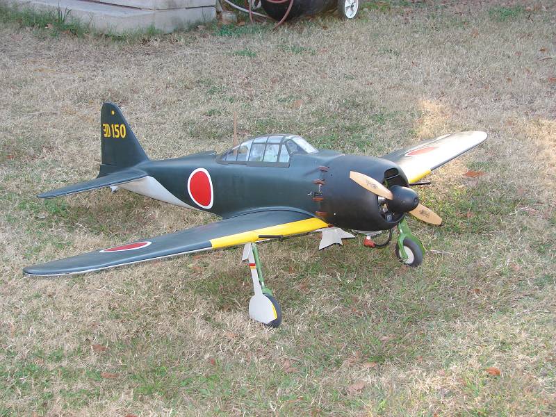

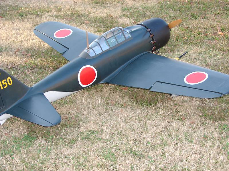

i have a Platt Zero, I like it. G-38 for power

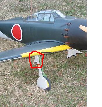

Cap21r
Any chance you could share with the rest of us how you made/hinged/actuated the little short strut covers? I'm building a Ziroli zero and that part has me a little baffled.
Scott Dean
Old 03-21-2007 | 06:22 AM
My Feedback: (27)
Joined: Nov 2003
Posts: 80
From: Denham Springs
Default RE: Zero question
The small doors are hinged just before the center pivot point of the gear.
The gear doors are stroped to the strut, when the gear come down, the door on the strut touches what is a small wood wedg that pushes the small door open.
I am out of town, maybe later I can send pics.
It hinged wit a Du bro large hing

Cap21r,
I checked out your thread on RCSB and I see the one picture of the little "kick" doors at the top of the strut. I think I see how they are acuated when the gear comes down but what pulls them up when the gear retracts? Pictures would be great when you get the chance.

According to the real A6M2 at the Chino Planes of fame museum, the inside wheel doors are closed by an arm that is hit by the wheel as it retracts. On a model you would need to figure a way to keep the door from blowing closed by thrust, either by springs or hyper extended "link".
Steve
Old 03-22-2007 | 08:51 AM
Shrky's Avatar
Joined: Sep 2003
Posts: 150
From: Vancouver, WA
Steve,
The door Im talking about is the small one at the top of the strut.
Scott

Is it possible to have a small spring attached to the top portion of the door that wants to close it but the Main gear door keeps it open when the Gear are down?
Old 03-22-2007 | 11:20 AM
carlbecker's Avatar
Posts: 2,071
From: Fairfax, VA
I believe that is how the original works. I think its a sliding cam working against the closing spring. It might be possible to use a link attached to the strut but it would take time to position it properly. I used a similiar method to open and close the gear doors on my CJM HE-162. Even with the much bigger doors the wind did not harm the linkage. The jet is not very fast though.

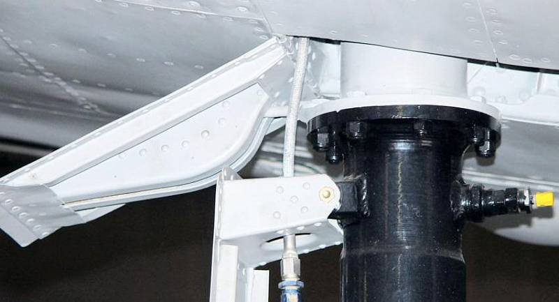

Here is how the real one is actuated. Could do the same thing but the geometry would be a real pain to work out. I'm hoping for something a little easier to engineer.
Scott

All thats fine, I used a small rubberband
