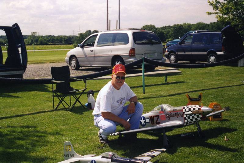

Try a World Models P51 and let someone help you get the first few fights under your belt then try it yourself.Remember that on most war birds your take offs and landings are done with elevator and throttle.Long take off and long approach. Take your time and learn.Tom
