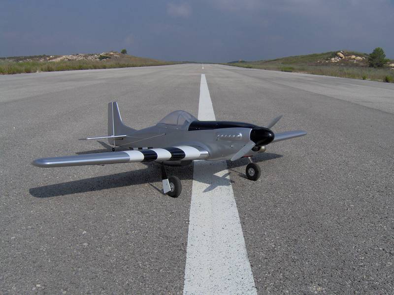

Old 12-09-2007 | 12:27 PM
EF
Joined: Feb 2005
Posts: 565
Received 21 Likes on 19 Posts
Default RE: Inverted 2 stroke
Absolutely no problem.
I have a CMP P-51 with an inverted ASP 1.08.
Easily choke it, then use a "bounce start" to get it started. Idles well too.
I had lots of concerns as I had never mounted an engine inverted, but this combo proved 100%

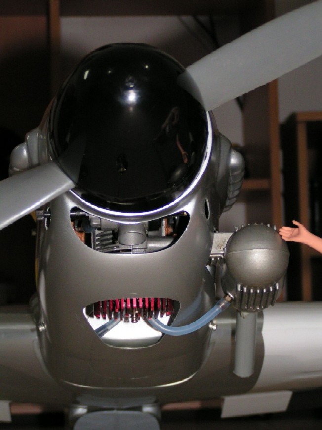

Old 12-10-2007 | 11:46 AM
EF
Joined: Feb 2005
Posts: 565
I use a DuBro fueler and it definitely helps avoiding a flooded engine and also - it's very convenient.
See the pic - it is at the same level as the needle.
I hardly ever use my starter since it can damage a flooded engine, and also it is simply not required.
The "bounce-start" is so easy with that big spinner, that I actually enjoy it and it wows my friends every time.
After fueling I open the throttle, give 2-3 chokes, close to a little above idle, and bounce it casually.
It starts on the first or second bounce every time.
This model has changed my approach and got rid of all my fears from inverted engines.
Also, I have no plug heating, and no idle problems. I believe those who have problems simply may have an incorrectly set carb.
